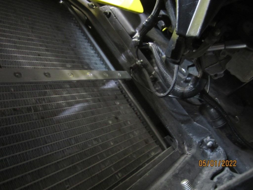

I put a nut on the end of one of the bolts that comes into the side of the radiator support for an inconspicuous ground.

the alternator is right there. Theres a big bolt on the back of it with a large ground wire attached. I just ran a short ground wire to that bolt. I have about 3 hooked there now. I got the positive for that kit off the horn relay, it has a big positive wire straight to the battery on a bolt on the relay. real handy to get to and right there were the relays go.

your radiator support is a giant ground source,,,the frame holding your nose up is as well

The rad support may already (don't know your year) have a ground screw for the lights / horns. Down on the drivers side, midway or lower on the front.
I installed a stud in the same spot to act as a ground for various things I've got up there.
