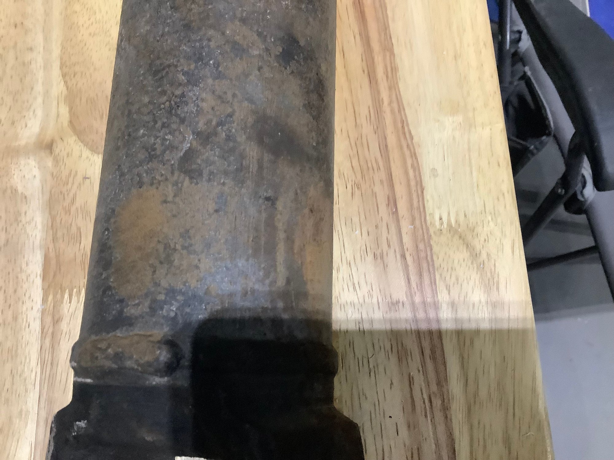

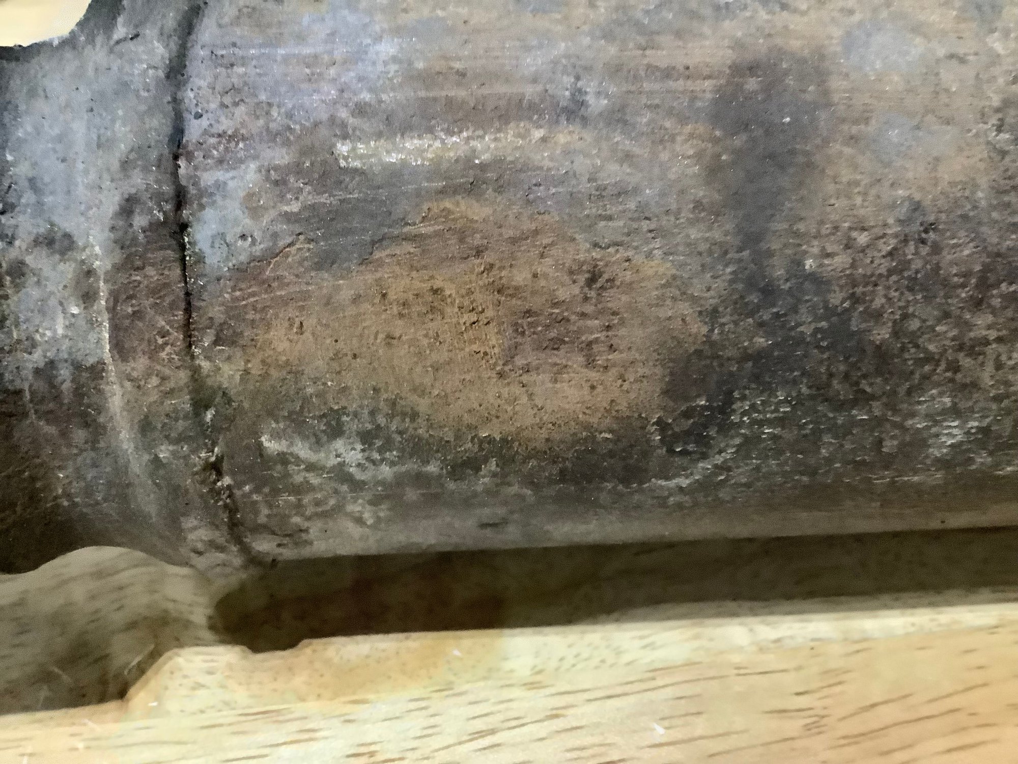

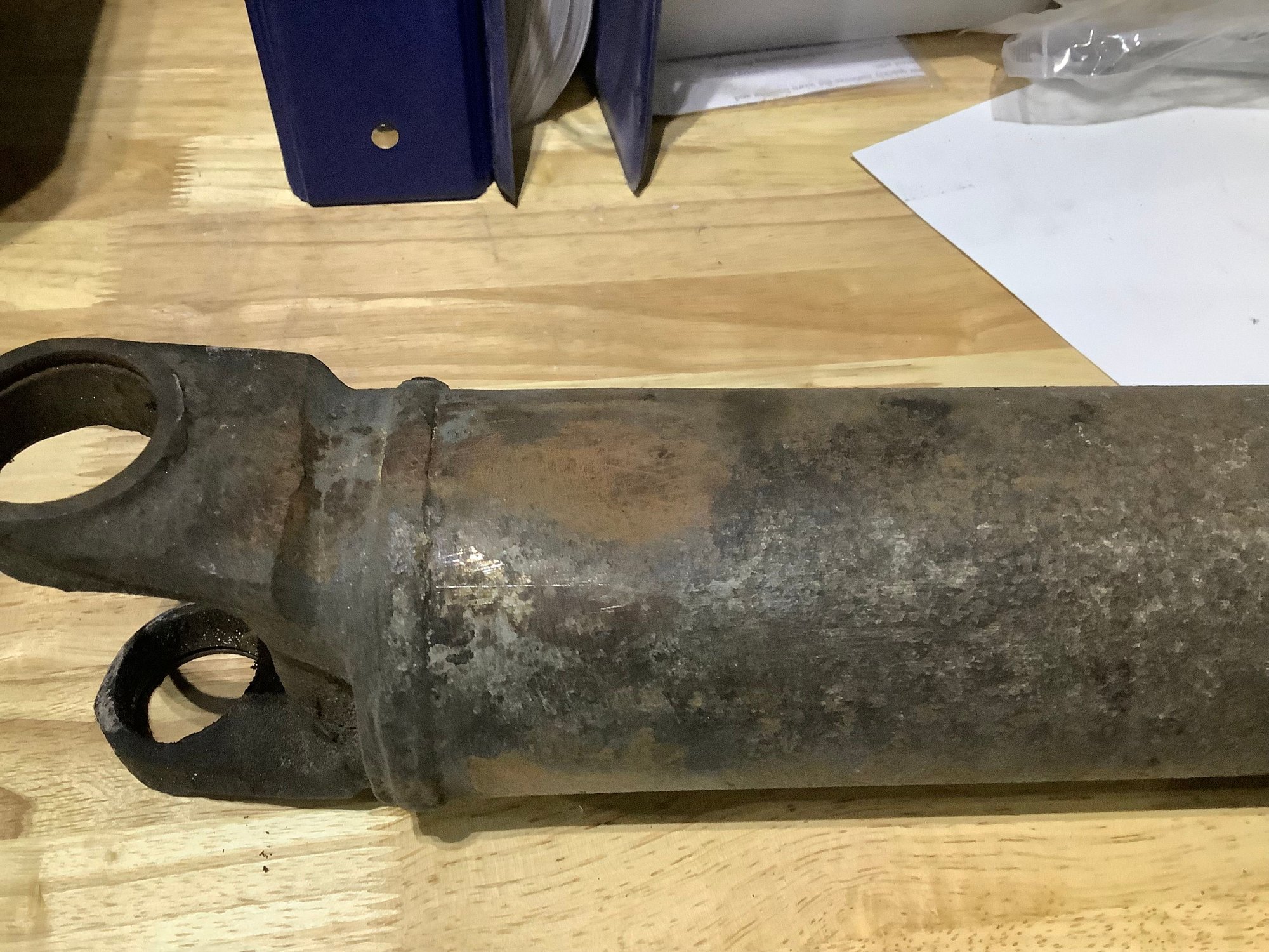

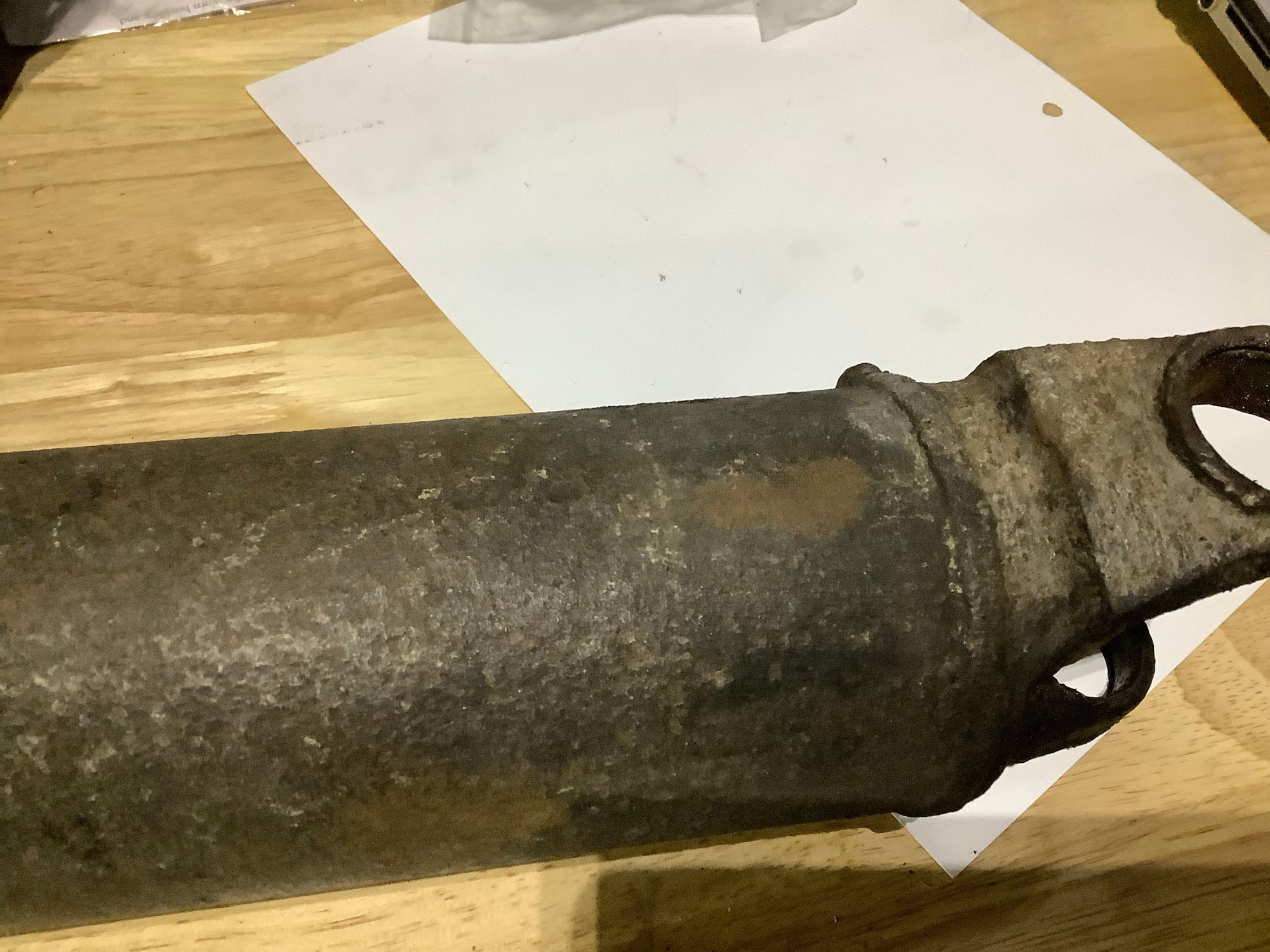

Hey everyone, looking for some advice. While cleaning up my half shafts I found one dented in two places. Should it replaced or is it still good to install
thanks

That is from previous genius workers crushing the tube in the vise to remove the u-joint. They were never balanced from the factory and don't need to be so it won't make a difference. I would blast, etch, POR15 and paint them, install solid spicer joints and use them. check the yokes, there should be a slight press fit on the caps, if they slide around inside the yoke then get rid of them.
