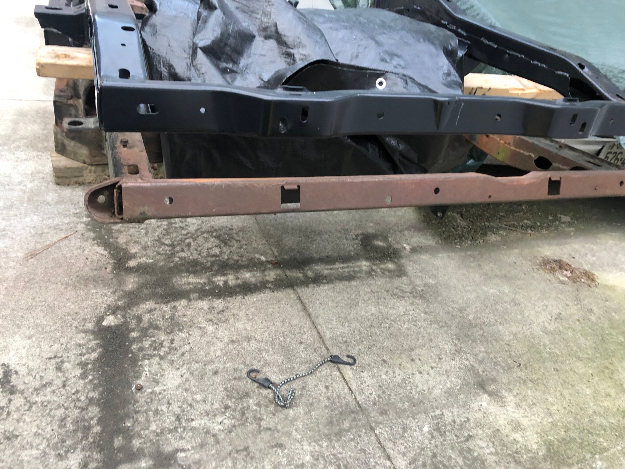

Can anyone tell me what year this frame fits?
The bottom frame

Is there a Vin # number on top portion of the frame by the #4 body mount on the drivers side ?

It looks like a 1968-1973 frame from the limited picture. If it has the set up for isolators on the front, then it's a '73 only. If it has no gussets at the rear kick up area it's an earlier '68 frame.

looks like a 74 , first year of the rubber bumper cover .

Not a 74 here is a 1974 frame.
yes it is , those two rear extensions come off and your left with what the O P pic shows . I had a 74 parts car , sold the frame to a member on here .

Look at the rusty frame in the OP. Look where the rearmost crossmember joins the frame extending to the front. See that cup like bracket sticking out like a little ear? That's not on the 68 through 73 frames. I have a 68 frame, a 70 frame and a 73 frame. The ear like bracket is not on any. The previous post identifying the frame as a 74 reads like a winner!

Top frame is a chrome bumper car
Bottom frame is a rubber bumper car
Year, no idea but VIN stamp should tell the story.

The "ears" on the rear sides of the frame are only on 74 frames, I think they served as guides for the large, cast, impact bumper extensions.

75 and up rubber bumper cars have a completely different rear crossmember with a large hole on each side where the energy absorbing bumper shocks mount.
