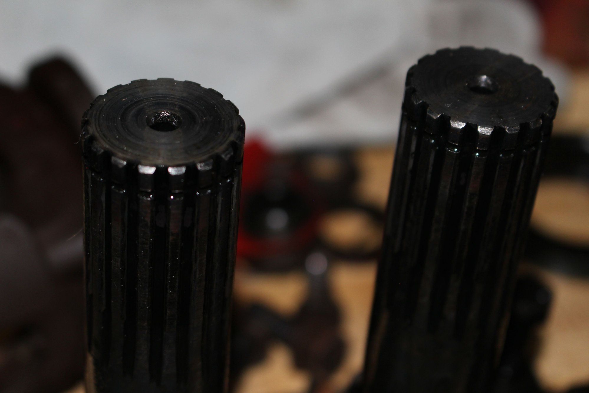

So if I were you I would order a new Eaton posi now and have it shipped to your Hotel. I have done such a thing before. They can hold it for you.
Since you have a week lead time and a week in the US it might work just fine.
Your next step is to have the shop put the side yokes in the posi with the center pin and see how much slop there is. Gary likes .006" inch. Many wear and have .250 or more.
Or measure the yokes from the top of the c-clip groove to the top of the shaft. A decent not too worn side yoke should measure around .185".
If yours are badly worn, and 78s tend to do that, you may need new side yokes as well. And good ones are harder to find than posi units. But at least they only weigh 5.8 lbs each.
These are about .185" Sometimes the beveled end is worn all the way off, or even also the entire c-clip groove.
