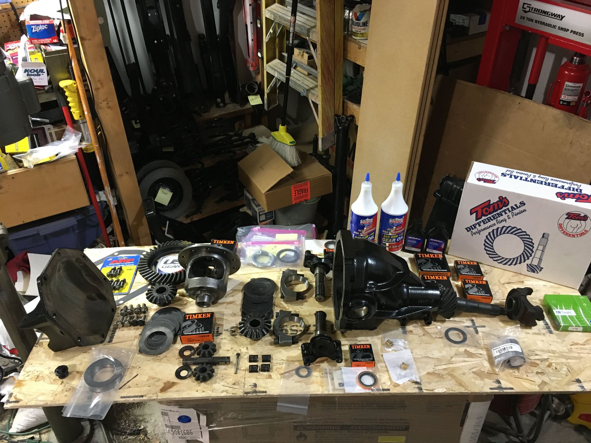

If you can find a mechanic who is well versed in differential builds there in the UK and they are willing to work with you on how to properly build the Corvette differential, you might be better off spending local labor pounds vs paying for shipping and import taxes.
Leigh1322, myself, and many others have built their own differentials after researching many posts on how to do this properly. Gary (gtr1999) has, by far, the most experience with these and will build you the best there is but you don’t have to incorporate each and every trick in the book. There are some basic recommendations (e.g., “tuning” the posi, foregoing use of the spring packs, using steel clutch plates, deburring/radiusing the casting flaws in the posi case, and ensuring the axles are properly hardened, etc.) that your mechanic can incorporate but things things like steel cap for the left journal, cryo treatment, REM polishing, 30 spline axle conversion, machining the cross shaft retention bolt land can be foregone if your expectations are simply to have a dependable unit for normal driving.
Gary is very generous in providing advice and we are glad to offer our experiences as well.
This was my 69 unit before assembly.
Everything ready for assembly

Thank you for contributing. I have pretty much given up trying to find someone here in the UK that I can trust to build for me. All I would like is a well built standardish diff that will be reliable - it doesn't need to be anything fancy, just done right.
Your picture looks impressive but a little daunting.
