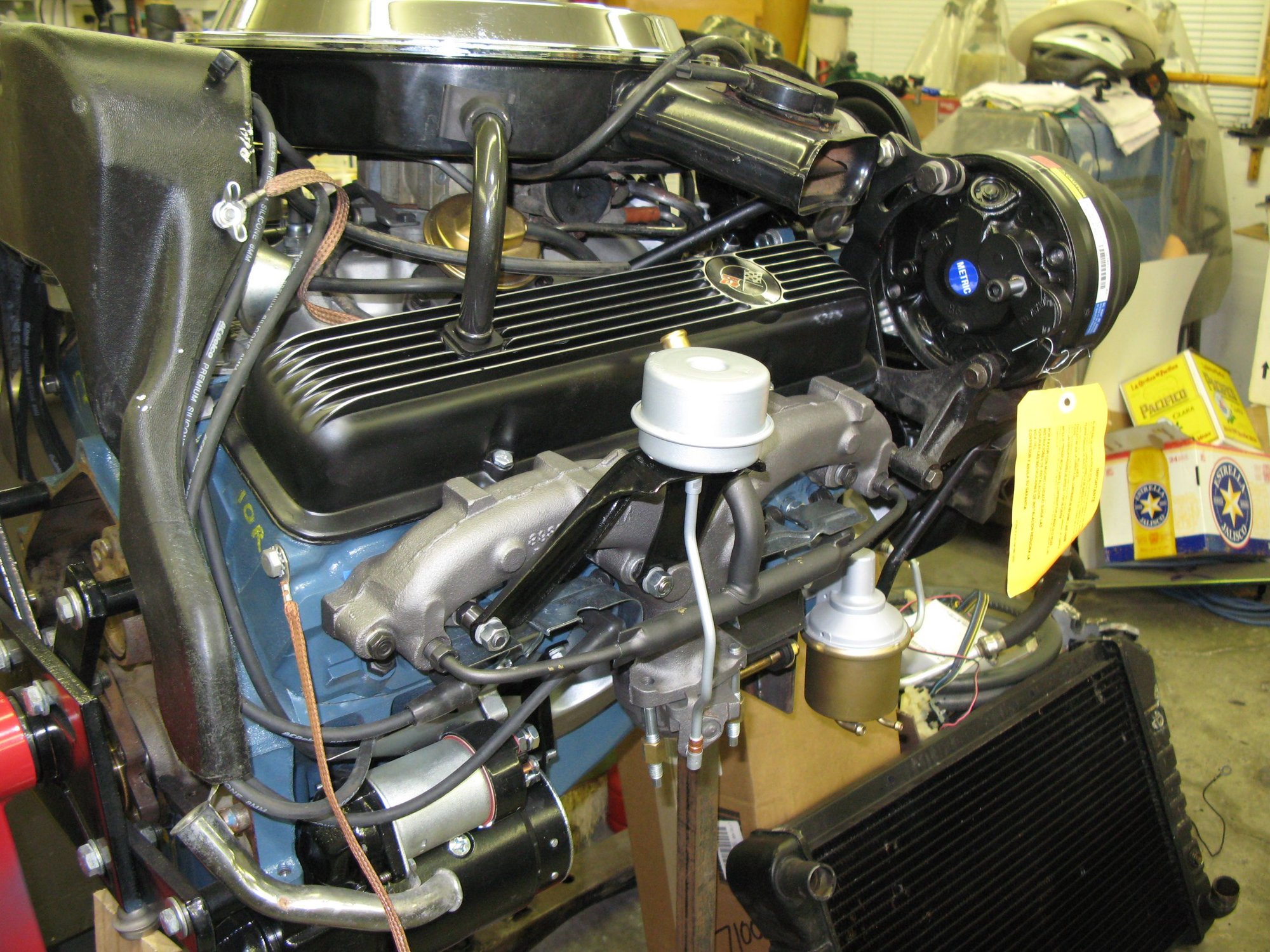

1978 L82 engine, all emissions going back on it. To each their own. Op hasn't said what his goal is in removing the smog hardware. Maybe just to free up space under the hood?
mph man wish I could pull my engine and refurbish like this!!! Nice dude!

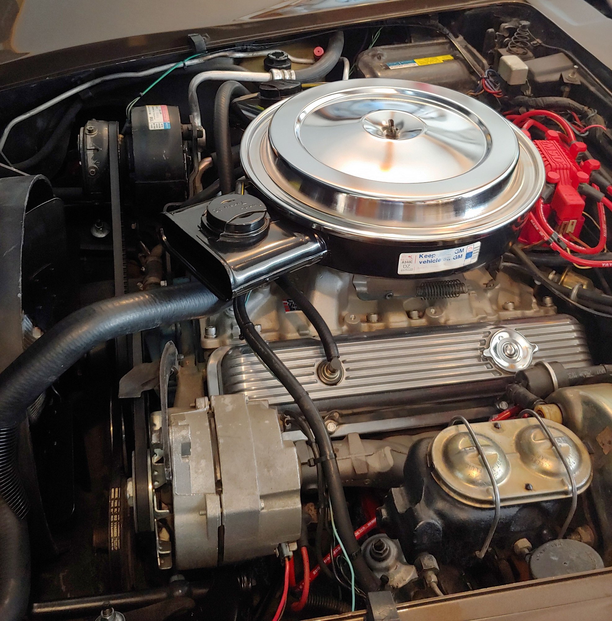

1980 decluttered except for the air cleaner bits.
Looks great!!! Exactly what I want. Decluttered, clean, and mostly original otherwise. May I ask you exactly how you went about this? I’d like to remove but I’m not sure what to remove and if anything other mods are needed once removed etc

I bought this one already stripped down but the sale included all of the original pieces to put it back to stock. It had aftermarket valve covers and air cleaner which wasn't really the look I wanted so I swapped out some earlier Vette valve covers and cleaned up the stock air cleaner and bought a chrome lid for it. You just need to remove the smog pump, heat risers and all of the associated brackets and tubing. Pretty straightforward.

where’s the smog pump? Is there more than one heat riser? The one I know is on the thermostat housing. So they hole would need to be capped etc
The smog/air pump is the big contraption front and center on RickM's pic above. The heat risers comes up by the exhaust manifolds (you can see them in the pic's of the stock motor above as well). Mine had the heat shields around the exhaust already deleted as well. You just want to be sure to run your plug wires in from underneath if you run no heat shields. My exhaust manifolds are new ceramic coated.
Yes,I believe there is a port on the thermostat housing that you won't need. Mine had an aftermarket aluminum neck already installed but I picked up a chrome Mr. Gasket neck to replace it. I'm also running a Performer 2101 intake manifold rather than the stock piece.
