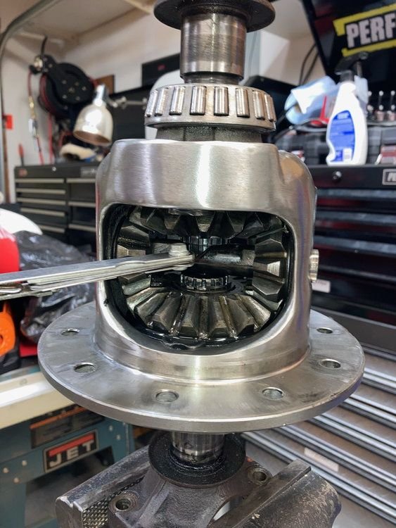

Your pic shows a lit of grinding and polishing on that case. Is that part of your tuneup work, to remove stress risers?

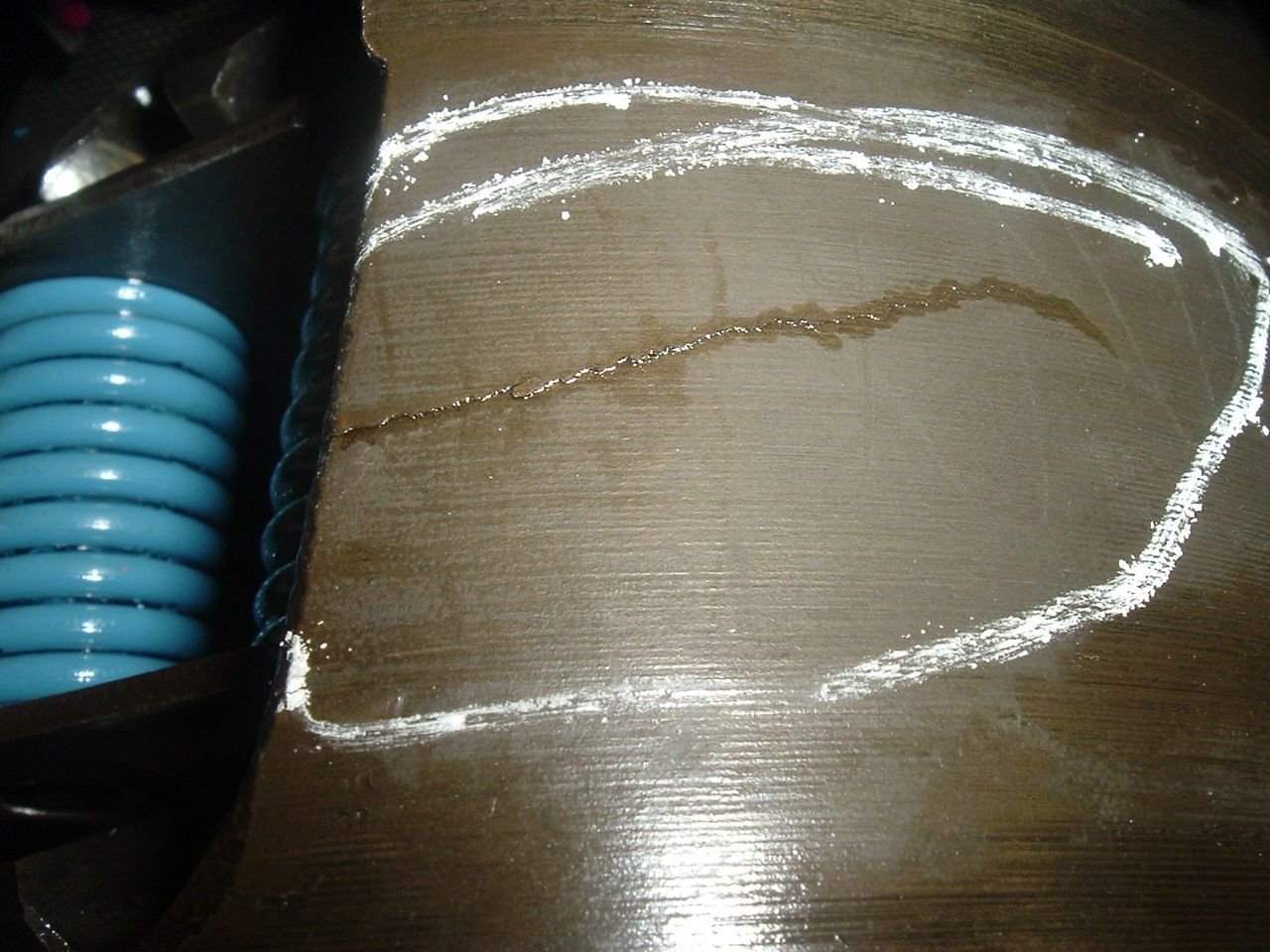

That must be a very common point for a stress crack to start. I found 3 cracked posi units in a row, all cracked in that same corner. That corner is almost directly in line and underneath the ring gear teeth, and pretty hidden by the gear when assembled. Plus in this pic you can see how rough the original casting is. So with Gary's help, I feel confident my fourth one is crack free and much stronger!
BTW I found all of those cracks while cleaning the old oil off with carb cleaner. Nothing fancy. The heavy oil just stuck in the crack a little longer and was easily visible, if you were looking for it.
So if you go in there, please look for cracks.
Friends don't let friends drive around with posi s ready to explode! LOL

Now forgive my ignorance......but if the crack was not that long......couldn't one relive the metal in the area....grind it back until crack is gone.....I mean, it would look goofy but seems to me it could be a viable save.

Think about all the work to remove the diff, then go through it and build it better than the common junk sold today. I get to a cracked posi and want to risk it to save some upfront money? If I was a liar and conman as some are, I wouldn't even tell the customer there is a crack, wouldn't polish or tune it, and use it. When it broke, I would tell them to send it back for another reRIpbuild. Sound crazy- it's been happening for many years. Perfect example of a current "race vendor", selling a rebuilt diff to a guy who never installed it. He brought it to me years ago to check and look what was under the cover. That same place is still in business and some here just bought diff's from them.

Dang, that polished case looks so nice you almost don't want to hide it in the housing!

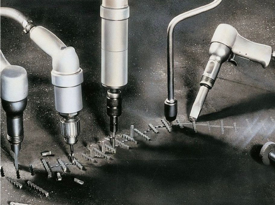

I’ve often wondered whether a cracked posi case could be repaired with the Metal locking process where the crack is stitched together? We used to have it done to cracks that formed in diesel engine crank case under where the cylinder liners were fitted.

Interesting suggestion but I’d worry about the locks migrating. Loose metal and gears/bearings aren’t a good combination.

Well a posi housing is very highly stressed, and heat treated to harden it even more. Welding would destroy the strength from the heat treating. Now I suppose you could anneal it, weld it, and then re heat treat it, but ........ cheaper to buy new at that point, unless the part is crazy rare.
I even cryo treated my posi housing to harden it even more. And the amazing thing was you could HEAR the difference. It RANG like a BELL afterwards.
I could see that stich repair or welding working on a cast iron engine block tho, as they are not heat treated and not as highly stressed. Welding cast iron can be a little touchy, best left to experts, so the stich repair could be more reliable for many. Some have the skill to do cast iron welding. Cracks will continue to grow if not physically stopped. Then cover it with JBweld to seal it, and keep the oil in.
