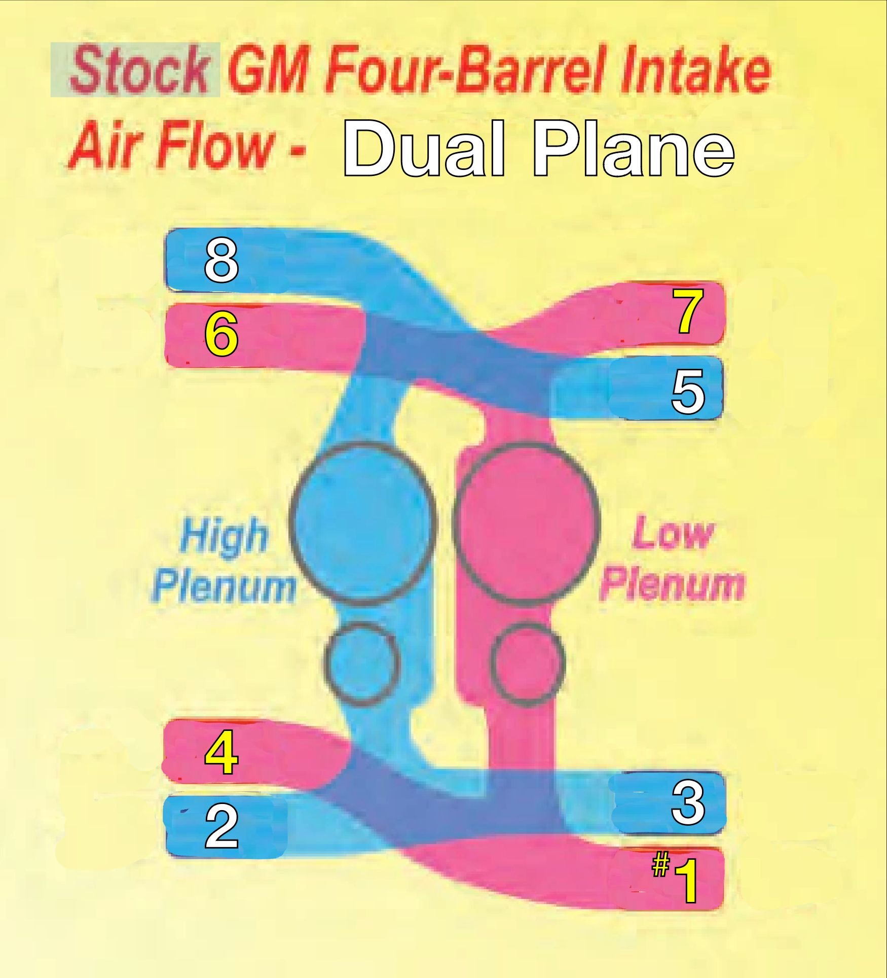

Old May 27, 2023 | 07:40 PM
mapman's Avatar
mapman
Joined: Aug 2001
Posts: 3,050
Likes: 124
From: Wichita KS
stilltrying
#5 and #8 share the same intake runner. Note image.
That may be your connection.
Mapman

Old May 27, 2023 | 08:17 PM
MelWff's Avatar
MelWff
Posts: 18,740
Likes: 2,583
Originally Posted by mapman
stilltrying
Mapman
And 2 and 3 also but they aren't having an issue. See post 2 in this thread.
The question about valve adjustment hasn't been responded to.
Old May 28, 2023 | 06:31 AM
mapman's Avatar
mapman
Joined: Aug 2001
Posts: 3,050
Likes: 124
From: Wichita KS
Don't arbitrarily disregard troubleshooting information.
Problems, with only a single cylinder, eliminates some potential problem areas and makes others more likely.
Problems with two cylinders begs questions of connectivity.
Related by firing order?
Related by physical connectivity? (i.e. side-by-side)
Related by intake runner? (our situation)
Unrelated by ignition/fuel/air connections? etc.
Problems with all four cylinders served by a carburetor side, points toward a common problem.
Then again, everything may also just be happenstance.
Point is, examining potential connections helps focus troubleshooting efforts.
Mapman

Old May 28, 2023 | 07:45 AM
stilltrying's Avatar
stilltrying
Joined: Jan 2020
Posts: 98
Likes: 15
Thanks to all for your responses.
As stated the compression on all cylinders are within 10% of each other at around 150 psi.
I removed the valve covers and the offending cylinders are lifting the same as the rest of the engine, so no flattened lobes on the new Herbert’s cam or failed lifters (unless when running they are not pumped up)
The valve springs all look fine. The rockers are on push in studs but nothing looks wrong compared to each of them.
When I installed the new cam and lifters I set them to zero lash then three quarters of a turn on every one of them, when I realised something was not right I did them again with the engine running, this time undid them till heard a ticking noise, wound them back in till the noise disappeared then a further three quarters of a turn.
I haven’t fitted a vacuum gauge, other than to set up the quadrajet a while ago.
MapMan, that is exactly the reason I was thinking carb as they are the only connecting thing I could see between the two cylinders, however, I have just ordered a new distributor cap, rotor arm and coil to either cure or eliminate them from the equation. It will be a couple of weeks before they arrive and can be fitted so will not be able to report for a few weeks.
