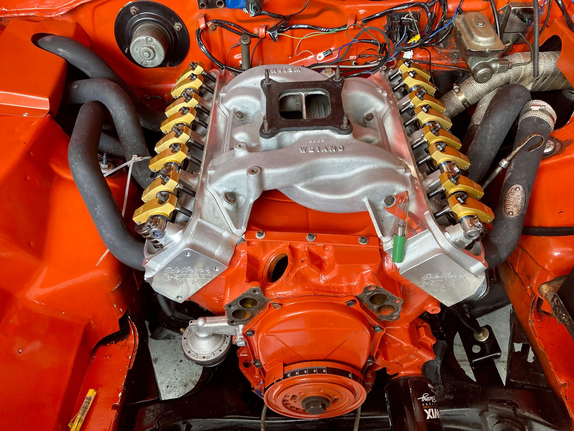

It’s very interesting reading about timing here in the C3 forum. I’m very new to this board and have been a dedicated Mopar guy for the past 20 years, mostly drag racing.
Allowing timing to exceed 34°- 38° is foreign to me with a performance engine.
Under hard acceleration, “Drag Racing”, WOT (wide open throttle), the vacuum advance canister does not function, there’s not a strong enough vacuum signal to pull the diaphragm.
In a most recent street/strip car I built, 70% strip, 30% street (car shows & cruise nights) incorporated all aspects of timing to make the car fun and not exceed 34° degrees of timing.
The motor was a 1972 440, low compression truck motor.
I used the smaller combustion chamber E-Street heads to increase compression. The camshaft was designed to work with the heads and low compression.
Compression ended up being 8.8:1, the cam specs were 499 lift, 236 duration at @.50.
The newer Mopar Performance distributors are set up with 22° mechanical advance from the factory. This motor liked timing. Understanding the golden rule in the Mopar camp, 38° total timing for cast iron heads, 34° total timing for aluminum heads, my initial timing had to be set at 12°. The motor hated it.
Exhaust temperatures were extremely high, the motor ran hot, plus the motor was sluggish.
I advanced the initial timing to 16° not to exceed 38°, the motor cooled down a bit, but performance was not what I expected. No fun seat of the pants feel.
I then proceeded to find out what timing set up made the motor run its best not exceeding
34° total timing with the aluminum heads. The motor had a 10” stall converter (3400 rpm) with a 3.91:1 rear end.
I first purchased a limiting device to limit mechanical advance in the distributor . I was then able to see what the best setting for initial timing was. 22° initial timing was the best setting. With the camshaft being used, I achieved 12 in. of vacuum on the vacuum gauge. RPMs were at 700, transmission in drive with car secured in place.
I then set my mechanical advance limiting device not to exceed 12° degrees of timing, for
a total of 34° degrees of timing.
The next step was to add vacuum advance. The Mopar performance vacuum advance canisters are adjustable. I added 8° degrees of timing with vacuum advance which brought my timing up to 30° degrees with 900 RPM @ idle, with an increased vacuum signal. The motor made the torque I expected when cruising around.
When at the drag strip, the vacuum advance doesn’t matter because the vacuum signal goes down under hard acceleration, maybe 3800 RPM and higher plus the distributor keeps perfect timing.
With the distributors mechanical advance limited to 34°, initial timing plus vacuum advance made the car fun when cruising around town.
Set up, 440 (low compression motor)
22° initial
Mechanical advance limited to 12°
Vacuum advanced adjusted to allow 8° (30°)
@ WOT timing is at 34°.
