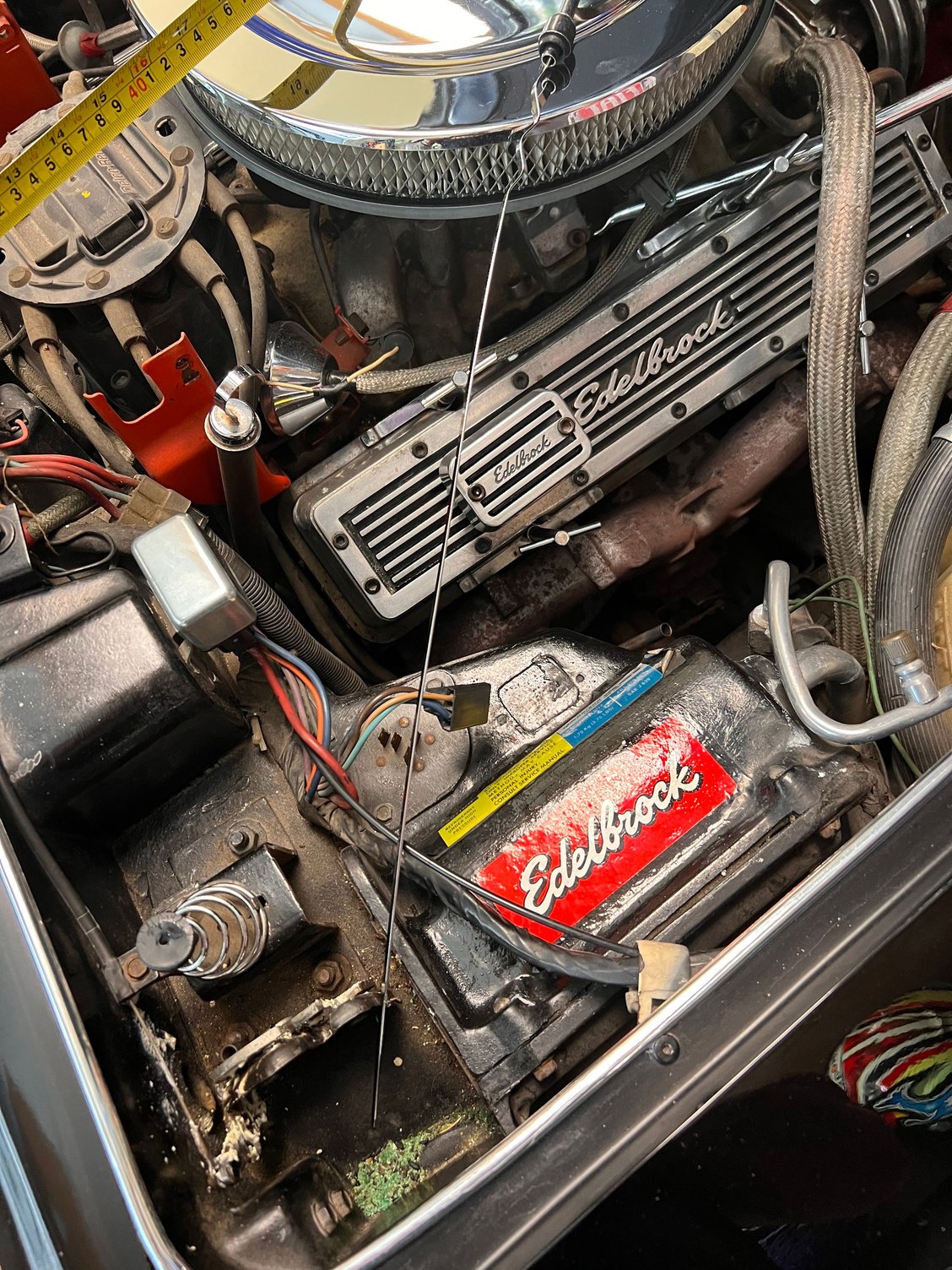

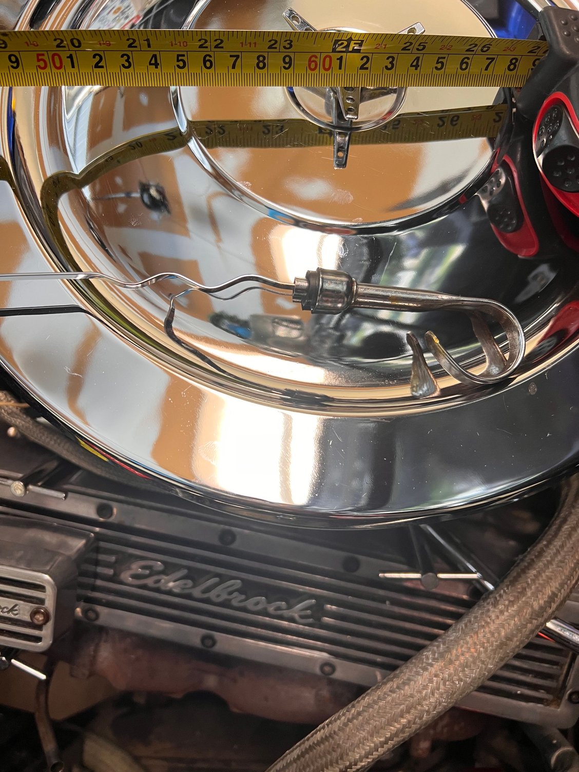

So I happened to check the oil on the 80 vette my dad left me in the will. The stick was dry. I put a couple litres in and its just barely on the stick. My issue is, I'm not sure that the stick is stock length as my dad replaced it with a chrome one. Does anyone have the exact measurement from tip to handle? Oil Pressure seems fine which is stopping me from adding any more oil. Obviously once I change the oil and measure with this stick I will scribe the full mark on the chromes stick. Is the capacity 5 litres with the filter change?

Is your dipstick marked with a part number? The service parts books list either 14010287, 14026165 – the factory indicator could carry a different # and the assembly manual will have that #.
Pics of the handle and oil-level end would help ID it.

No part numbers on the stick at all, just oil type recommendations and the stick measure 18 1/2 inches from tip to just under the handle stop.

Should have also asked for a side view pic of the oil pan. If it has an aftermarket deep pan, it wouldn't register on the stock stick correctly with a standard volume fill.
The handle end that I can see looks pretty standard for GM. Can you do a close-up showing just the handle and the zig-zag?

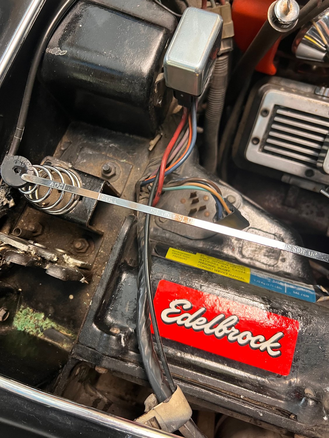

I have a 1980 with the original L-48 and original dipstick. Just measured it, and its 22-1/8" from the tip, to where the neck seats in the the handle (figured this would be the most critical measurement). Took a picture to help show how I measured.
Thanks so much. I think that is exactly the same as mine which means I need more oil.

I ordered a chrome one to replace on my 1981,and the tubing was same length but the dip stick it self was much longer than my original I cut mine off to match my original,I’m assuming this dipstick would be perfect if you have a deep oil pan.
