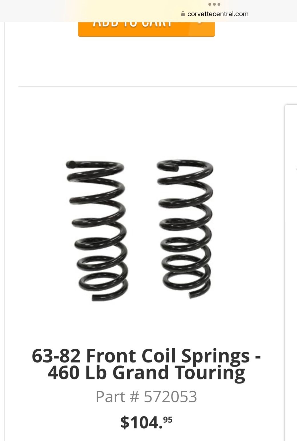

Only reason would be to upgrade performance from original. OEM’s were either 460lb springs or 550 for Gymkana option. 550’s would require matching rear spring/shocks and change the ride quality. Cutting one coil off original 460’s lowers the front end 1” and stiffens the ride just a little. Dual rate 480/700 coils by Hyperco lower the front end 1” as well and improve handling, but keep the ride quality of the softer springs and match well with original rear spring and most shocks. Add a spreader bar in front and you’ll have much better handling than the original 460 coils. Going around curves and corners faster with less body roll is always more fun. This minimal change runs about $300 for coils and spreader bar.

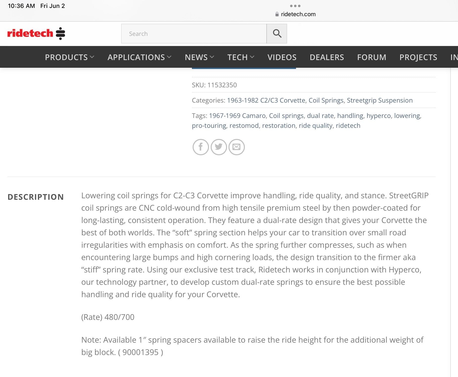

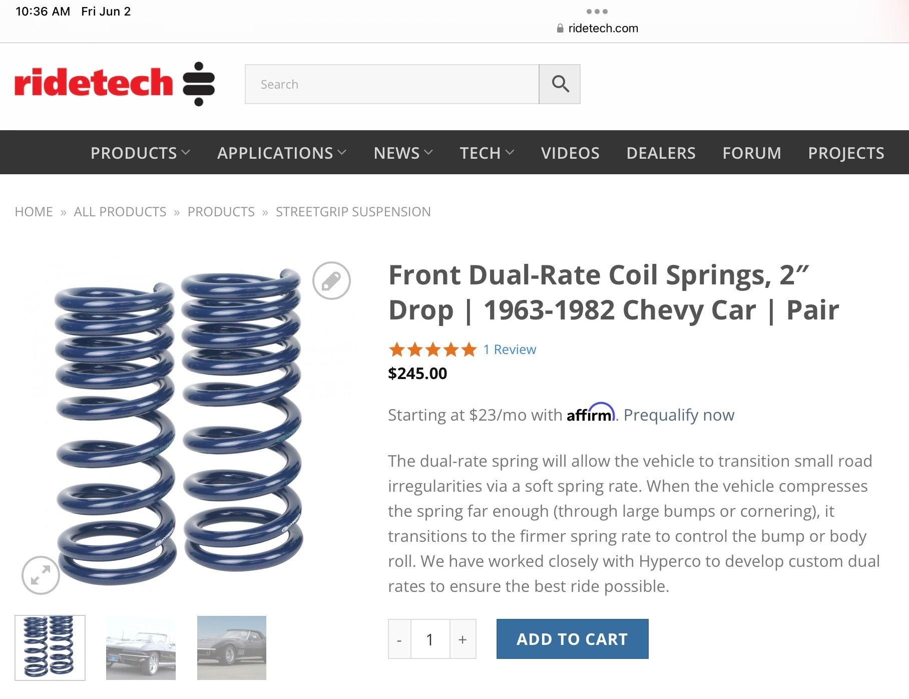

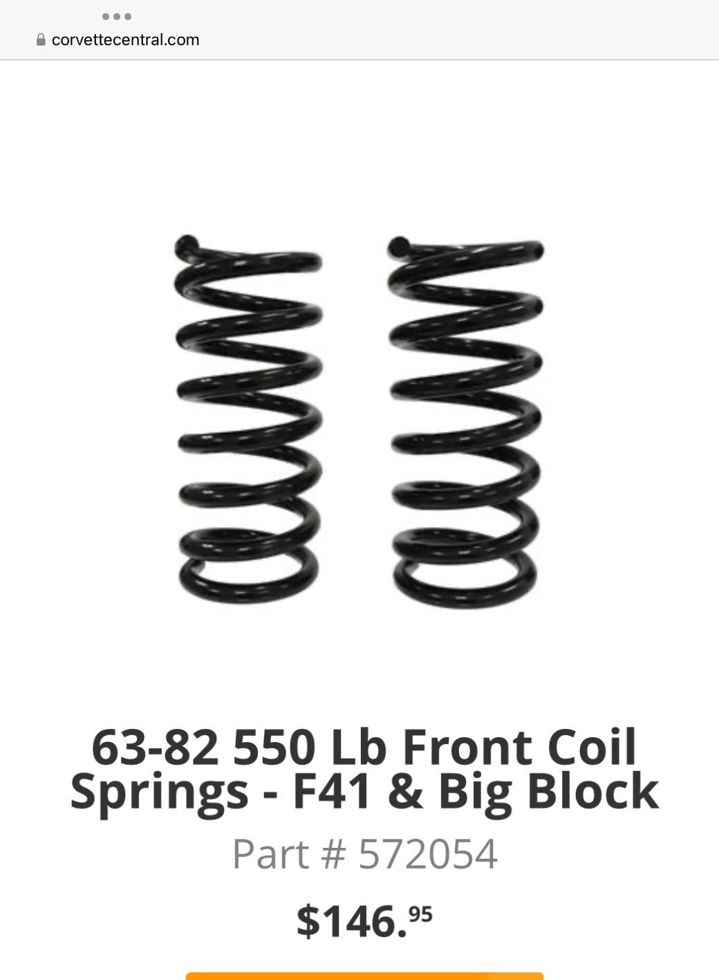

The spring ratings are what is being sold as original replacements from parts venders; generally two choices. Here’s Corvette Central’s offerings(F41 option=550). My mistake if actual originals are different from what’s being sold today.
480/700’s are from Ridetech. Ad says -2”; I only got -1”. But, that was replacing 42 year old springs.
Charlie

On re-reading charts and ads the 460 springs are sold as ‘grand touring’; stiffer than OEM. OEM being less than 300, and varying. F41 is listed as 550 on both charts and ads. Impressive difference between base and F41 springs!
