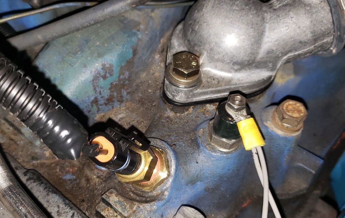

I have a temp sensor question. Let me explain. I have 2 engine temp sensors. The factory one in the left head. And a more modern one in the front of my intake manifold just left of the thermostat.
here's what's strange. Most of the time my car runs happily along right on 185 degrees. And both the gauge in the center cluster triggered by the sensor in the head. And the display for my EFI triggered by the newer style sensor mounted in the intake manifold agree with one another. Give or take a degree or 2. So, both temp gauges are in agreement when running along down the road.
here's the catch. So now were in stop and go traffic, sitting at red light after red light. The temp gauge in the center cluster starts to go up. Fans should kick on according to my settings, but there not. And up and up some more. Then finally the fans which are run by the ECU getting it's information from the sensor in the intake manifold kick on. Seemingly 20 -25 degrees higher than they should kick on.
So I go for a drive with the hand-held screen plugged in. (It normally sits on a shelf in the garage) And I watch the temperature of the engine coolant. Running along at 185. Both gauges agree. Sitting at the stop light or a long uphill. And I mean long. The cars gauge starts to climb. And climb. And then slowly the EFI gauge starts to rise. The cluster gauge gets up to 230. The EFI says 196. The fans kick on. Slowly the cluster gauge starts to come down as the fans are very effective. The EFI gauge holds 195. The cluster gauge gets down to 200. The EFI gauge reads 192. Slowly down it comes to 190 and fans switch off. And the cluster guage agrees.
So I buy one of those IFR thermometers. I shoot in intake manifold right next to the switch. It reads about 40 degrees cooler than the EFI hand-held reading. I shoot the Thermostat housing. It agrees with the EFI reading within a degree. Thick aluminium intake manifold is likely cooler on the outside than the inside. My aftermarket thermostat housing is not very thick and is also aluminium.
I try to shoot the area around the switch in the head but heat from the exhaust manifold is keeping me from getting any kind of accurate reading.
Is it likely that the coolant temp is much higher in the head than the intake manifold?
I replaced the sensor in the head when I rebuilt the engine about 6 years ago. But I still have the original.
would moving the EFI switch to the right head give more consistent results?
Anyone ever compare engine temps in different places on the engine as it heats up?

Yes, but not really answering the questions.
if the factory temp sensor that feeds the center gauge cluster gauge reads higher then the gauge off the intake manifold. Is coolant temp. That is clearly moving coolant, really that much hotter in the head than in the intake manifold just a couple inches away?
do I need to replace sender in the head? Move the intake sensor to the other head?
What's with these differences in coolant temp just inches away? And only when temps rise?

My heads are Edlebrock aluminium. My intake is also Edlebrock, single plane torker from the 70's. When I had just a thermo switch running the fans I didn't see this. Just strange that both sensors agree below 190 and then don't above that. Is it one bad sensor. Or is.it location? Can't find a good way to get a good reading on the head. Shooting the thermostat housing agrees with computer reading. Lowering the settings on the ECU any lower would have my fans running full time. And this clearly isn't a good answer nor is it needed.
perhaps the only answer is to drain the coolant and move the ECU switch to the right rear head location. And see what happens. Was hoping this temp gun would give me answers. But no way do I get a good read on the left head near the sensor. Do I have a faulty sensor. And which one?

If you really want to find out, then just swap the leads to the 2 sensors and get another set of readings and a temp gun reading.
I'm thinking one of your sensors is "wrong".
I have both of my sensors, 1 for gauge, and 1 for EFI, on either side of the thermostat outlet. They both track appropriately. Before I dialed in my gauge with an adjustable resistor it would always read low.
I suspect that your sensor going to your gauge is incorrect. Just for funsies I bought a suggested 3/8" sensor to see how it would read..... I could dial it in to read the same as EFI at 175°-180°, but it would deviate considerably as the temperature went up.
Let me find that post..... but I suspect the sensor for your gauge may be incorrect.......gimme a sec.

first off I can't just swap wiring from one sensor to the other. While this sounds like a great idea, one is a modern sensor with a proper weather sealed 2 wire connector. The other is the 70's style that grounds through the head and has but on wire clipped on.
Also, inspite of high gauge readings but only when going up. The car does not show any signs of over heating. (Still, high gauge readings are unnerving).
pointing the IR gun at the thermostat housing seems to agree with the EFI sensor. Pointing the IR gun at my highly polished stainless steel flex type upper rad hose reads lower! Sorry, I don't run a black rubber upper rad hose.
when I rebuilt the engine about 6 years ago I replaced the temp sender in the head with a new one I purchased from one of the Corvette vendors. I replaced it "Just because".
at least 2 people have reported that these after market senders can read good at 180 but off when temps go up. Which I hadn't heard before I asked this question. I am certain that although I have moved 8 or 9 times in the last 6 years I have that original sender somewhere.
So I am going digging for that original sender that goes in the left head.
I don't wish to move my EFI sensor if that won't solve the issue. As everytime you open up that cooling system your going to make a mess. And then there's the rewiring part and I want the wiring very tidy so that's a project in itself.
so with information at hand. I'll try the factory sender in the head first and if that works I'll only make a mess once.
