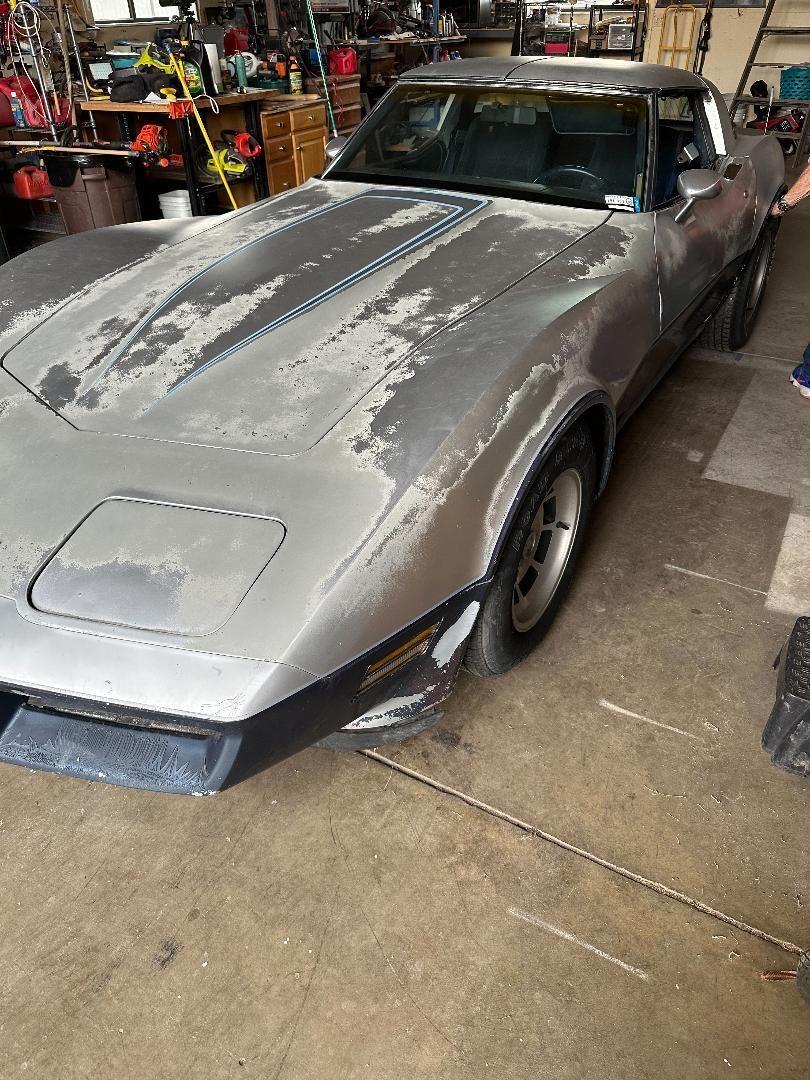

Hello! Sorry I didn't get back to responding I accidentally responded as a private reply instead of a thread post. I have checked the transmission fluid and seems to be full and fresh color. I also threw in some Lucas stop slip to see if it make a difference nothing changed. Like 4-vettes said, I pulled the vacuum modulator and it seems to be in good condition but I have a new one coming hopefully tomorrow that I am going to test out. I will have pictures of the old one soon. If it turns out to be the bands, I would be somewhat shocked because the car only has 50k miles on the odometer and the previous owner said the car drove and accelerated fine before I bought it. Thanks for all of your responses so far btw. I have some
pictures of the car now attached here if your interested. Definitely needs a paint job and its in a temerity shop now.

Nifty cloth interior!
Can you get a passenger to film a driving video, showing the tach and speedo? Post it to YouTube and link here. Perhaps it is not a trans issue?
