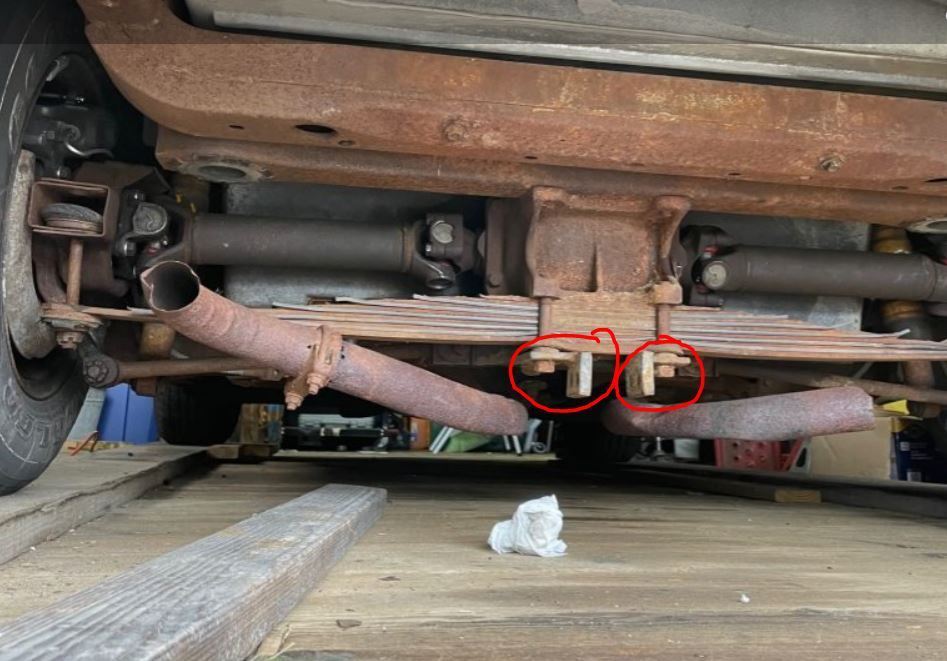

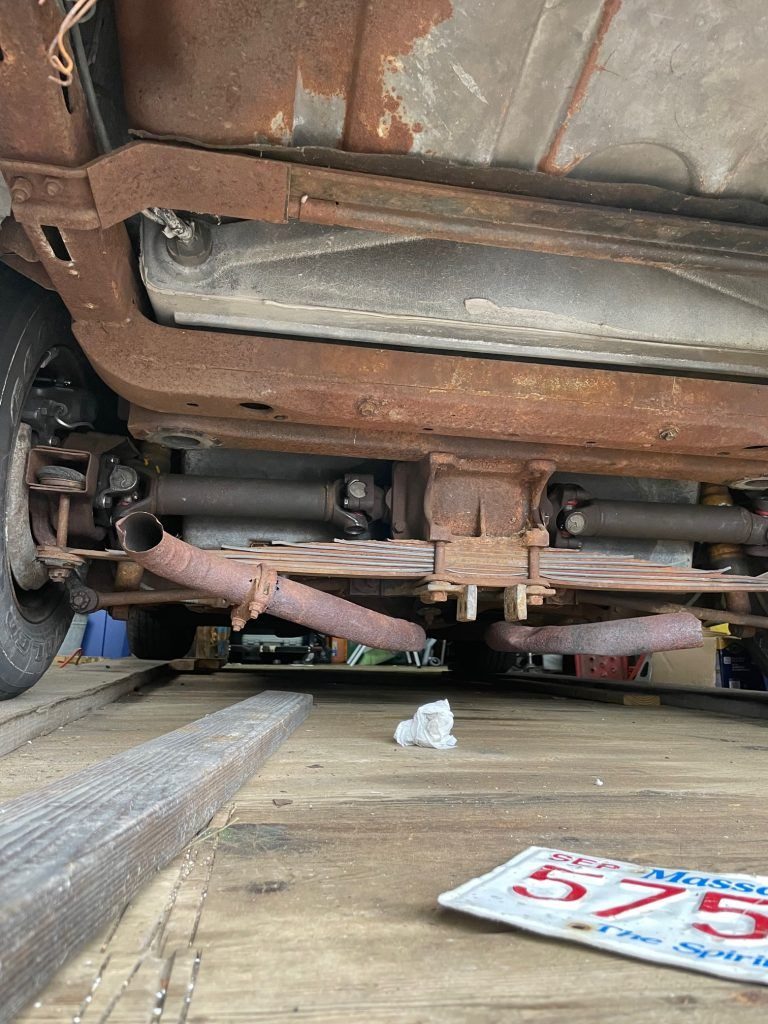

Is "flat" = bad?

The spring is OK being flat across -- what's more important is how the suspension aligns the axle half-shafts. They should be horizontal when the car is sitting level from side to side. So, in this case they look good.
Looks like this car may need the spring hanger rubber bushings at the wheel ends changed out. If you are thinking the rear is sitting too low, new bushings will raise it a tad.

My guess would be yes. Have you been able to drive it yet?
ok great thanks.
The fellow did say there are a number of things to be done, bushings being one of them, so well said!
~R

Hi, looks good alignment wise, as stated. Here's a pic of our '68 after complete rebuilding of suspension parts. Alignment is similar. And congrats!!!! Paul

Also, you might check the rear ride height against specs. If it's low, that would indicate spring problems.

Originally Posted by rgouette
ok great thanks.
~R
rgouette -- while you are under there replacing the bushings, remove these non-factory angle brackets.

Those brackets look like pieces to an old school traction bar. I agree, get rid of them. Before you start, thoroughly soak the bolts in Kroil or Bead Blaster for a few days. Go slowly, you don't want to snap off the differential ears. Jerry
If you do remove the brackets, make sure you get shorter bolts. Otherwise the front ones will crack the housing.
Remove the left and right spring bolts first.
When reinstalling the differential center bolts, you must get all 4 bolts finger tight then go 1/2 turn on each one until correctly torqued or you can snap off the differential cover.
Then replace the outer bolts and new cushions.

While that lower spring bracket is not "stock", it doesn't appear to have any functional problem....nor does the spring. If the spring is "squeaky" when driving or if you hear other "noises" from it, the separator sheets may be shot and some lube might help.
No real reason to swap to a mono-spring, unless you feel the urge.
