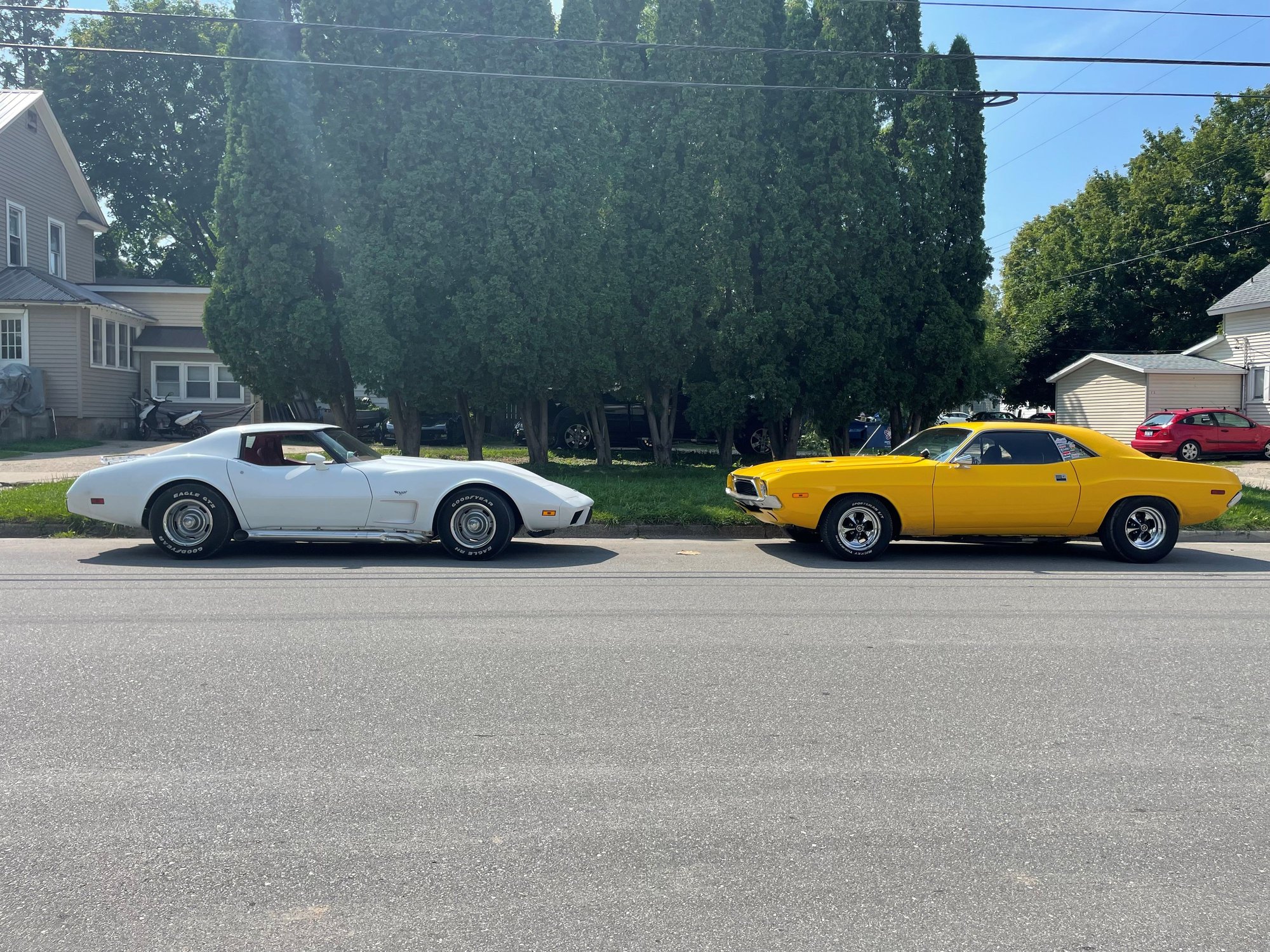

My name is Logan (20 y.o.) and I just joined this forum, although I have been scouring it for the last year since I bought my 1977 C3. It's a L48 Auto w/ A/C. I've done a bit of work on it over the last year including: refurbishing heads, new water pump, new intake, headers + side pipes, rebuilt the carb, rewired the spark plugs, and a lot of cleaning. I attached pictures of the day I bought it vs. now.
