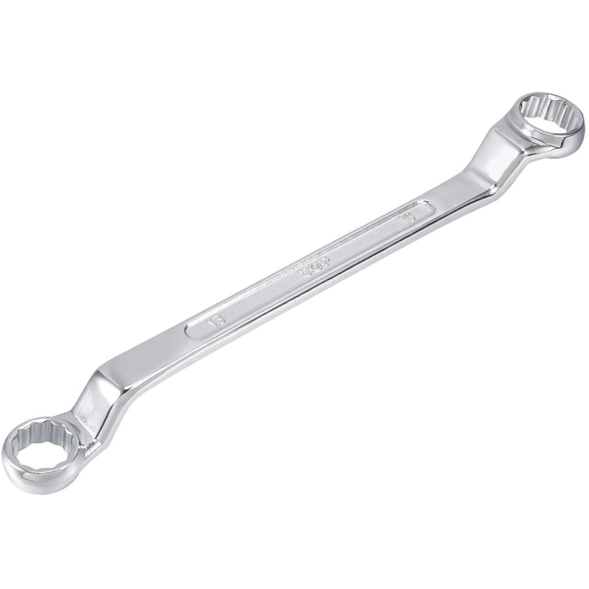

What kind of wrench do you use to get the nut off while you are holding the shaft with an allen wrench?
Old Jun 9, 2023 | 12:37 PM
Barry's70LT1's Avatar
Barry's70LT1
Joined: Oct 2001
Posts: 2,064
Likes: 1,382
From: Halifax, Nova Scotia, Canada
I use a box end wrench. I secure the allen wrench in the bench vise, end pointing up, drop the box end wrench over the allen wrench then place the alternator on the allen wrench, lift up the box end wrench and loosen/tighten the nut.
