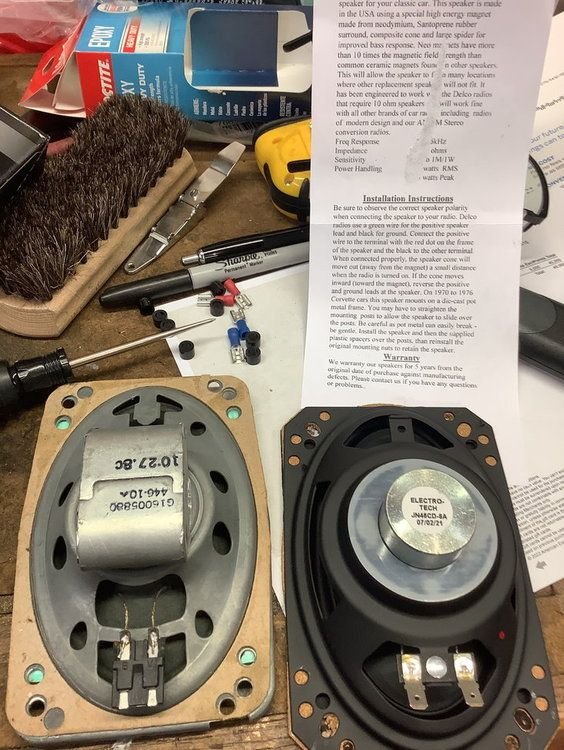

Agreed these Electro-tech speakers are good products. I installed their dash speakers in my '72 and am looking to get the '67 speaker. Unfortunately they've been out of stock on both speakers for quite a few months now, so perhaps contacting them for ETA may be in order.

that rip is in the worst possible place if your trying to see the spec of the speaker.. From the size of the magnet im guessing maybe 5 watts?

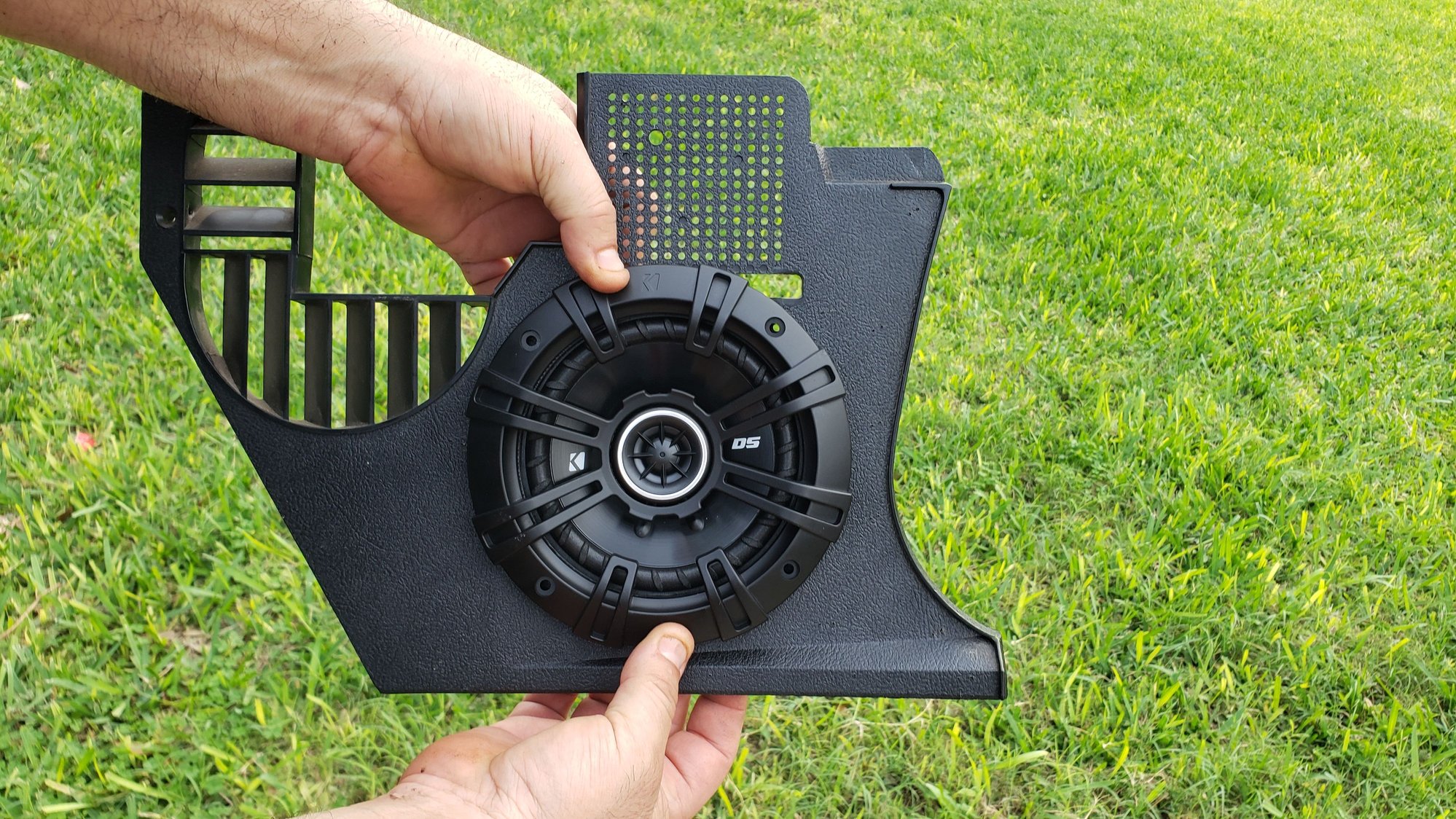

I did this setup to my 1980 and am pretty happy with it. I went with all Kicker on the system. Sounds awesome.
Proud of this set up. Left enough room for T Tops. Also this enclosure kind of quiets the droning of my Flowmasters at 2500 to 3000 rpms. Not much but, it does muffle the sound a little.
For some reason this pic becomes blurry when I upload it to forum.

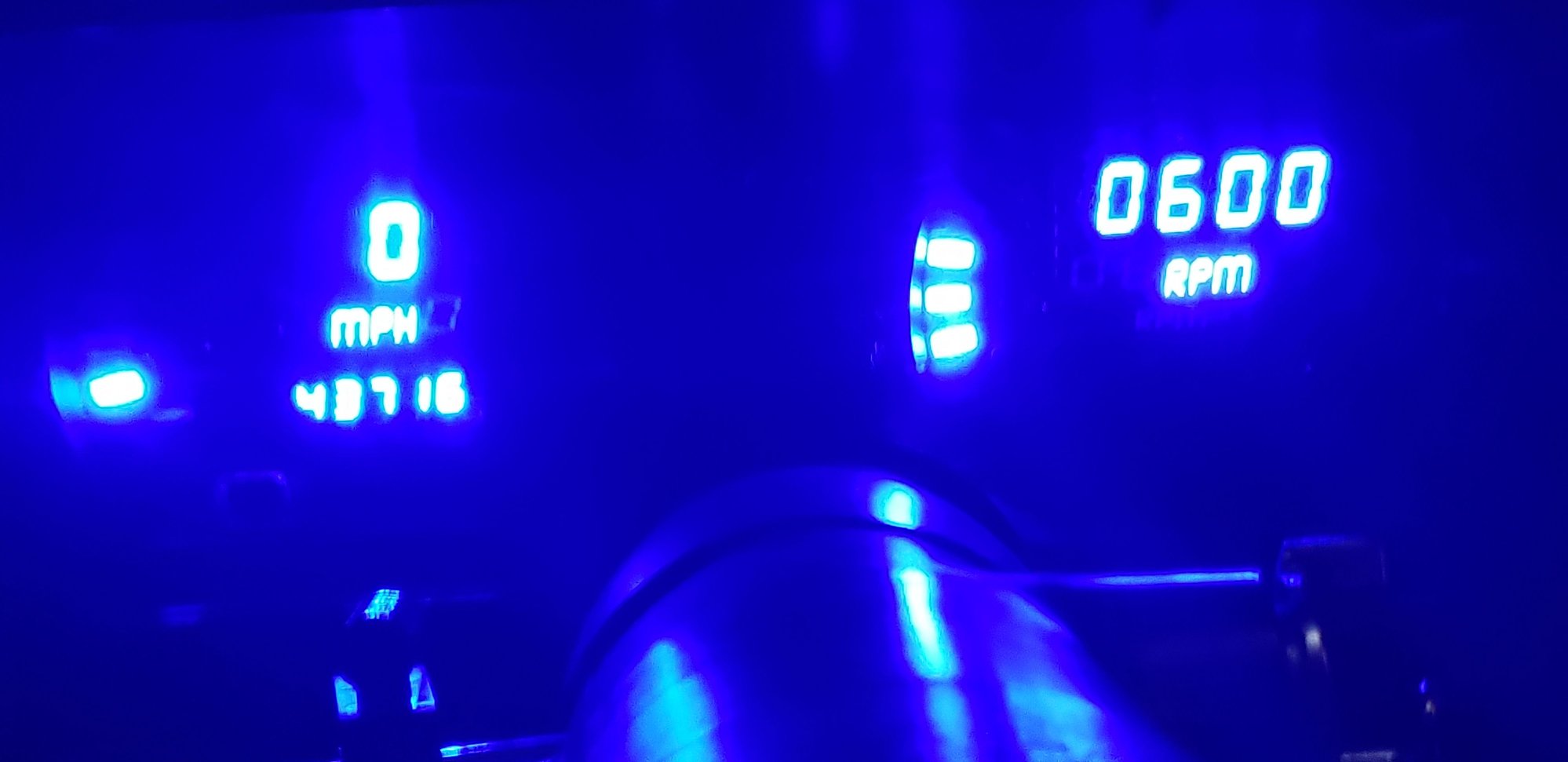

Switched everything to LED and also upgraded alternator.

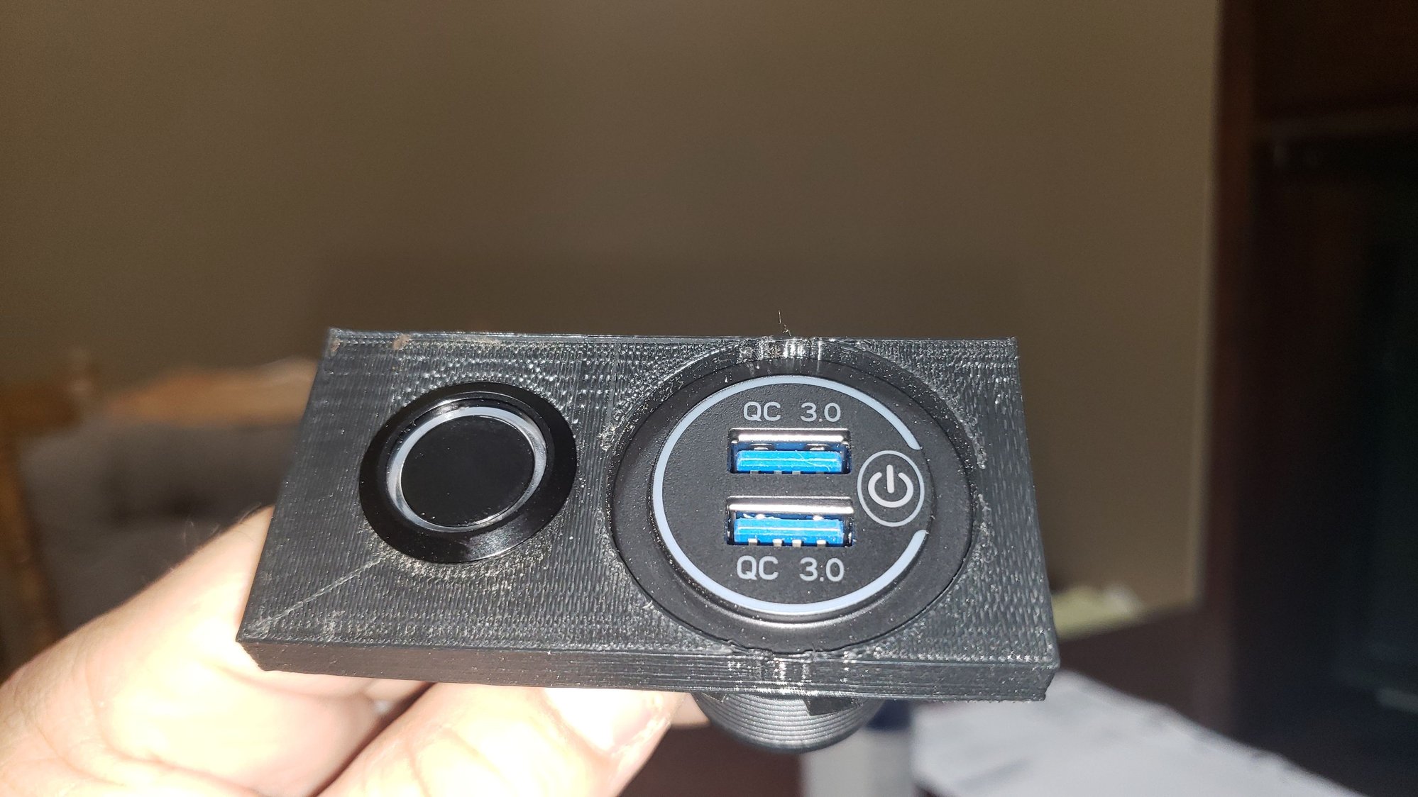

Replaced ash tray with this little device my son made from PLA plastic. The right obviously is a phone charger, the left is a button I use to raise my power antenna, since I upgraded to a stereo with blue tooth and phone mic. The new stereos don't come with a remote antenna wire. I didn't use radio to amp wire because this radio when it is turned off, has a delay. For some reason it doesn't work well with antenna because it goes down then back up, then down again.
