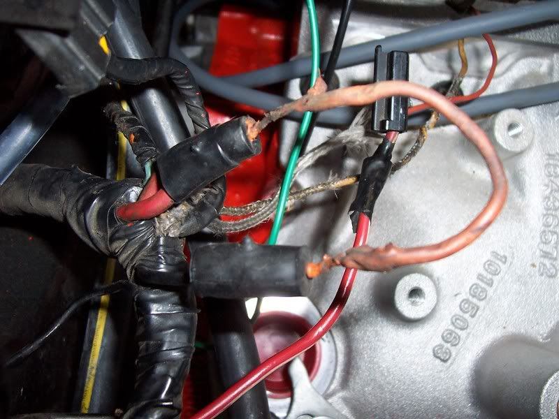

Here's an internet photo of a fusible link down by the starter:
This might help too.
https://www.corvetteforum.com/forums...with-pics.html

Thank you, pictures are always helpful!
