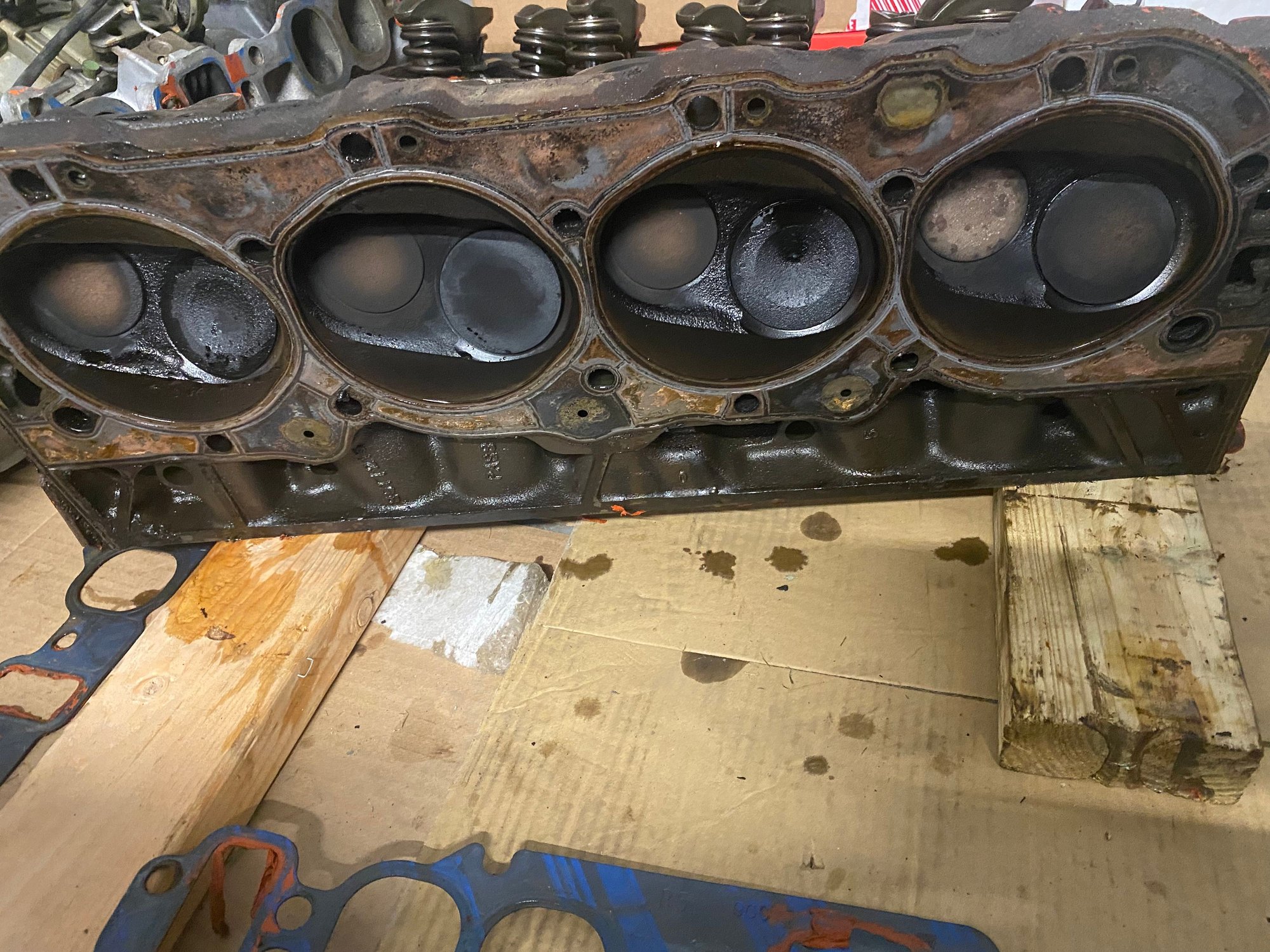

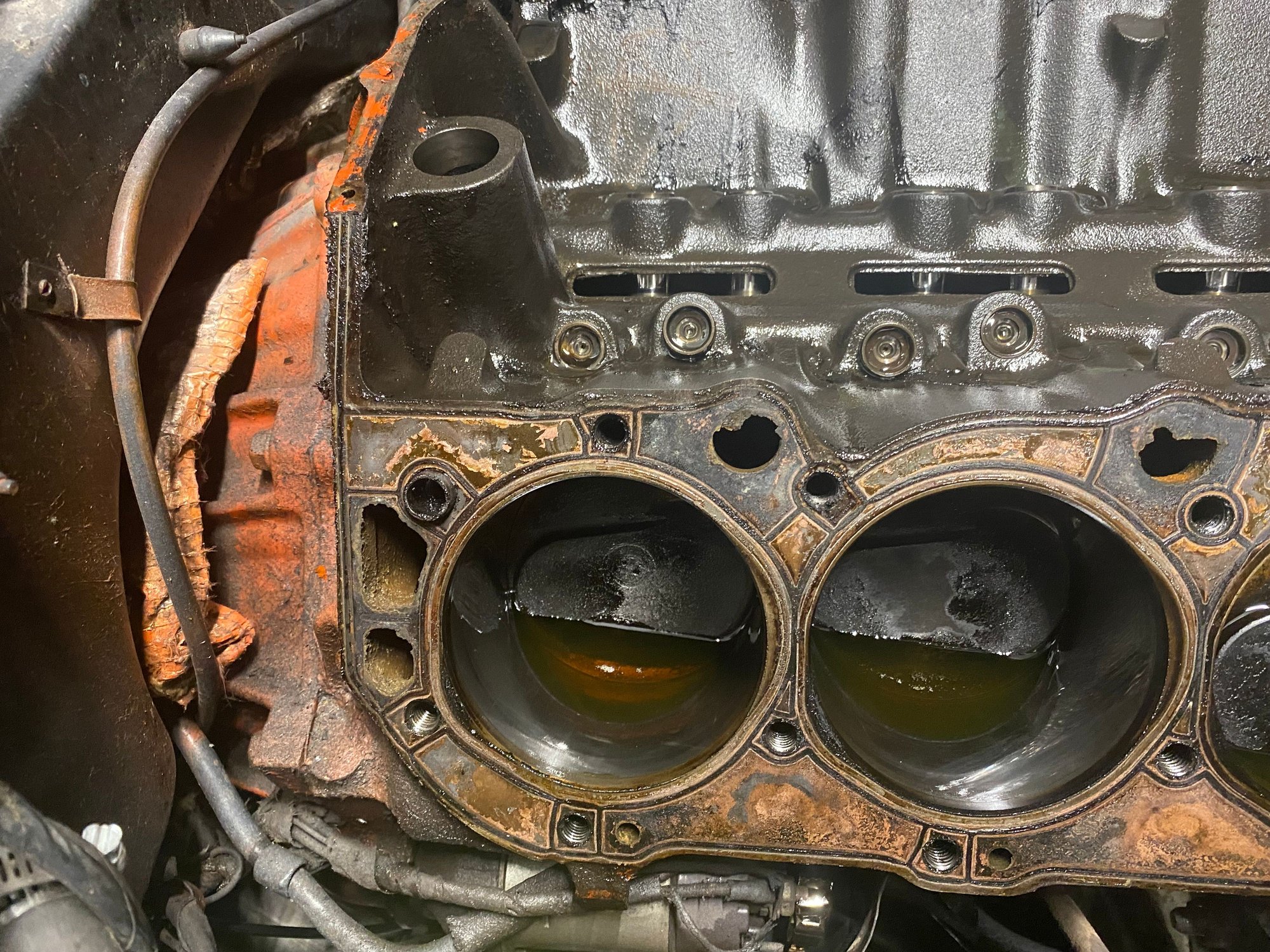

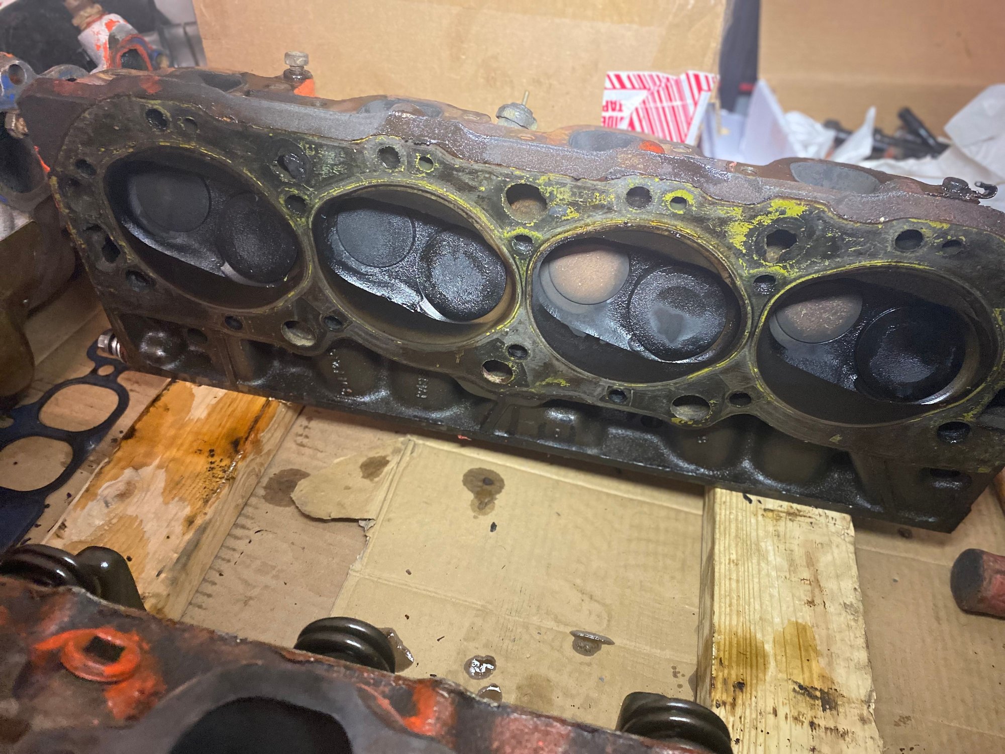

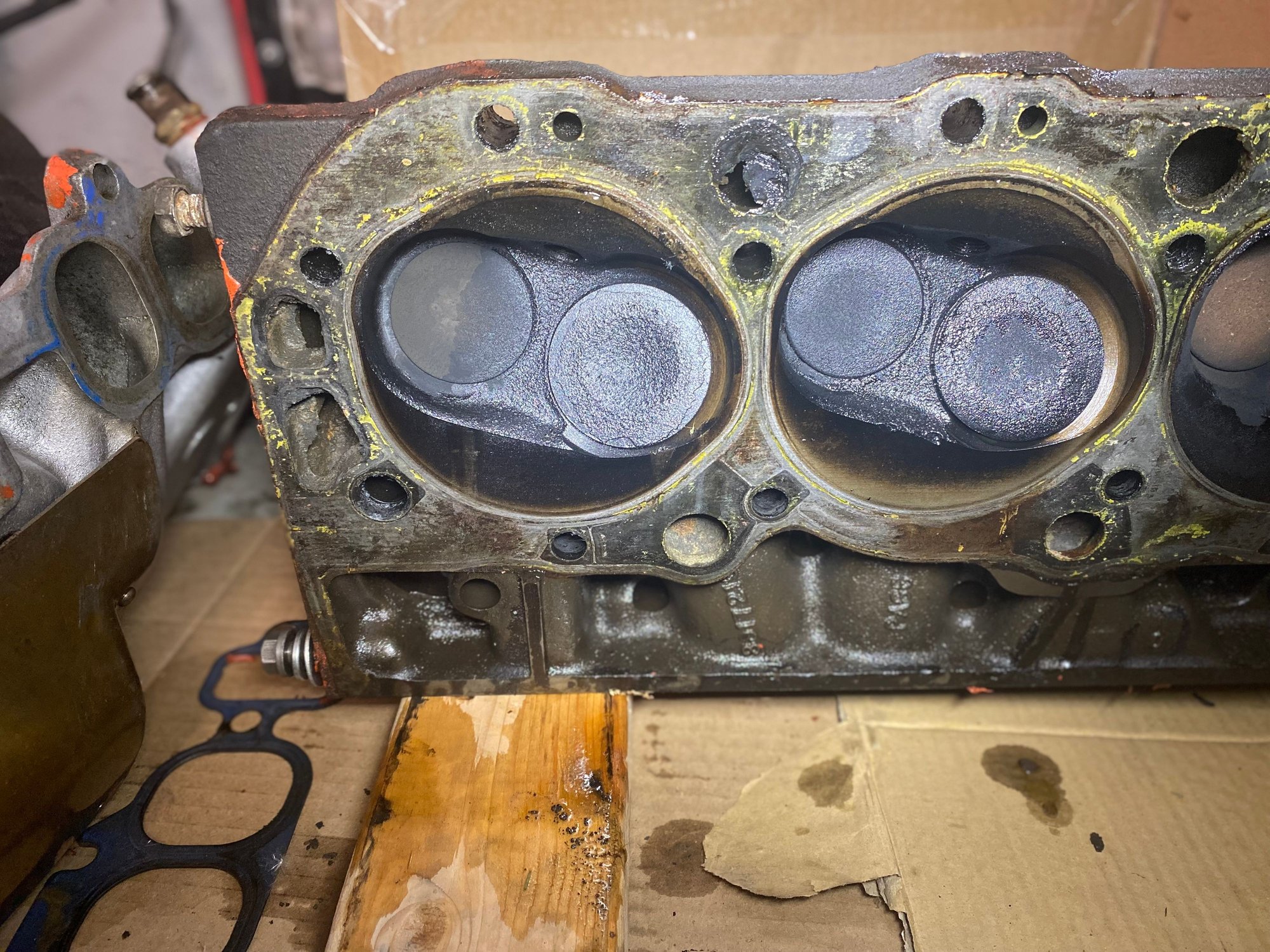

did the leak down test and hear slight air noise when on #1 from where I fill oil on valve cover #3 I hear air from exhaust, decided to pull the heads here are some photos also put oil in piston cylinders to see if it goes down thru the rings and taking heads to get them checked and rebuilt if they are still good, what cost should u be looking at fairly and what if anything should I have done to them

Happy Father’s Day first of all, I checked the cylinders where I left oil, and most still same but one has no oil left so safe to say it is passing the rings, either way to be safe I want to have the pistons cleaned and minimum have new rings and bearings installed as the cylinders do not look like there have any problems, along with the head work and then I will reassemble, question is should I have the car taken to garage and let them do this without pulling the short block or remove and take to shop?

at this point, pull it.
you'll need to do hone, seals, measure, etc.
sorry but do it right

almost out, pulling this weekend I have a reputable builder but he is busy and told me to call him mid July, all being said to get block and heads checked, and if sound get engine refreshed with new rings bearing head redone engine cleaned and repainted what should I be looking at cost? I am doing it regardless refresh or if needed rebuilt just curios, by look of pistons and cylinders should not have to change them

can't even guess because could be real cheap or real expensive.
ideally, a deglaze hone, drill, covers the cyl's.
some plastigauge covers the bearings.
when you start magnafluxing block, regrind balance polish crank, linehone caps, resize bigends, cost goes up.
a good look at everything will tell the story.

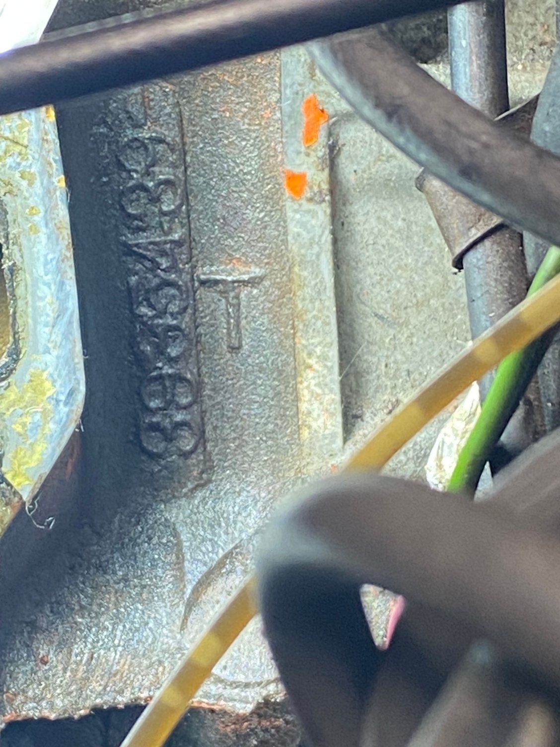

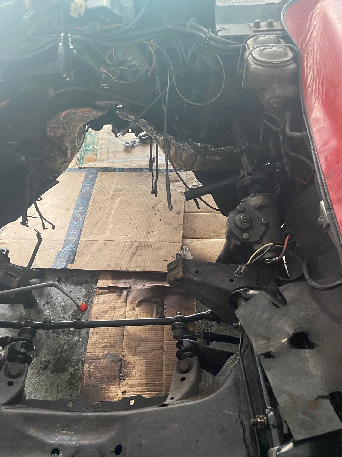

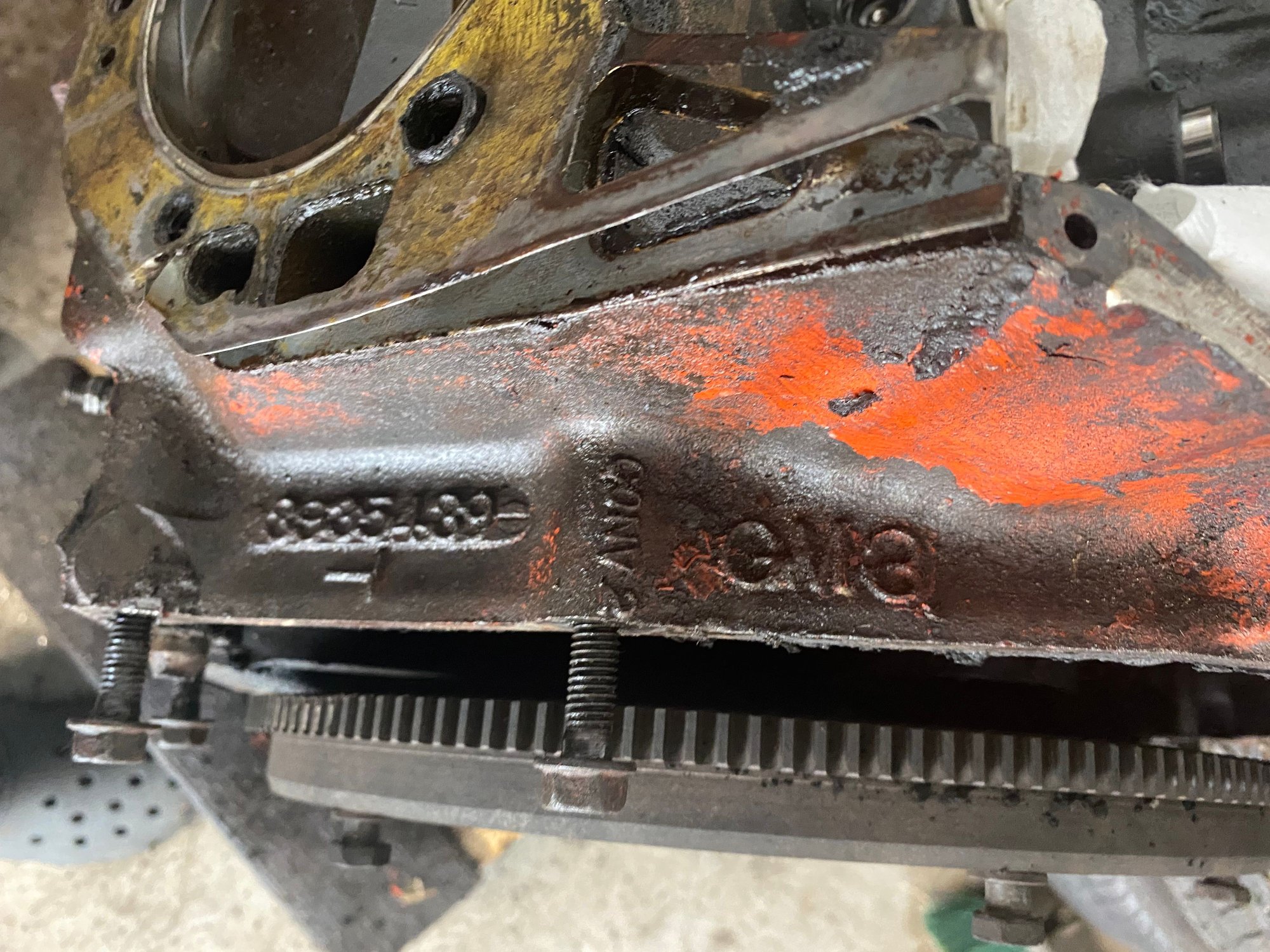

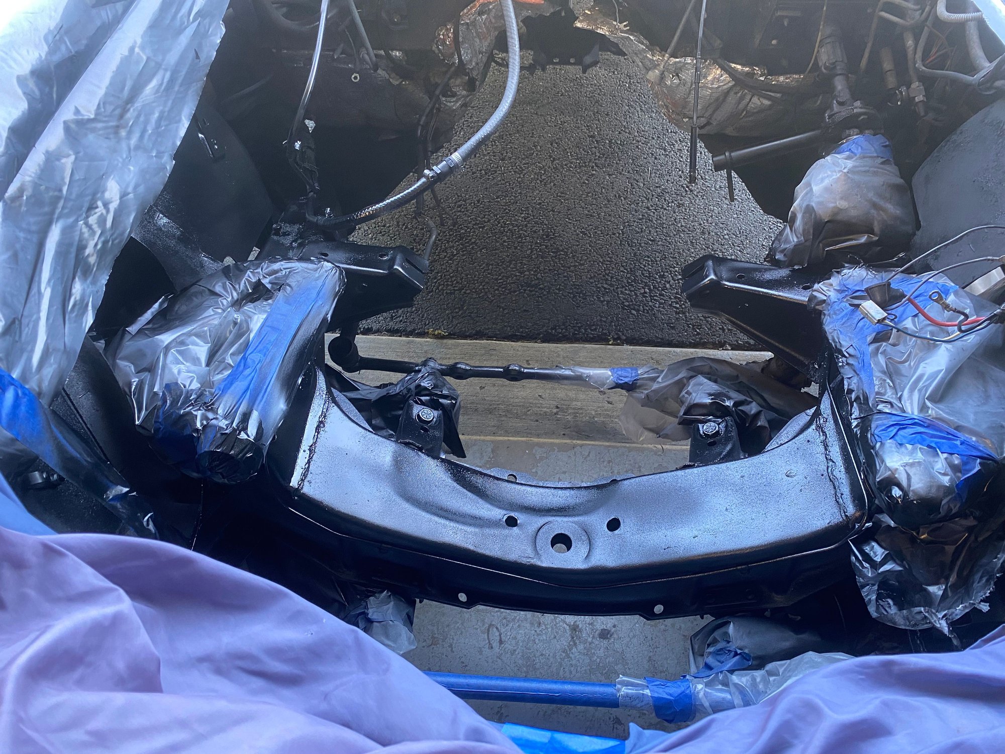

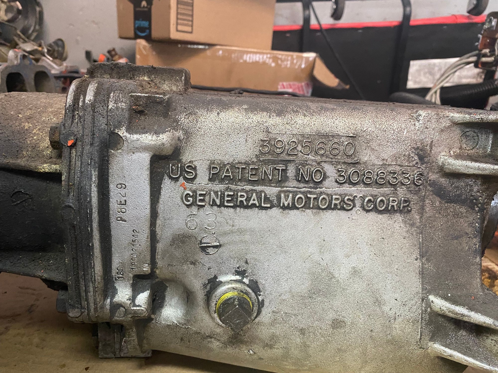

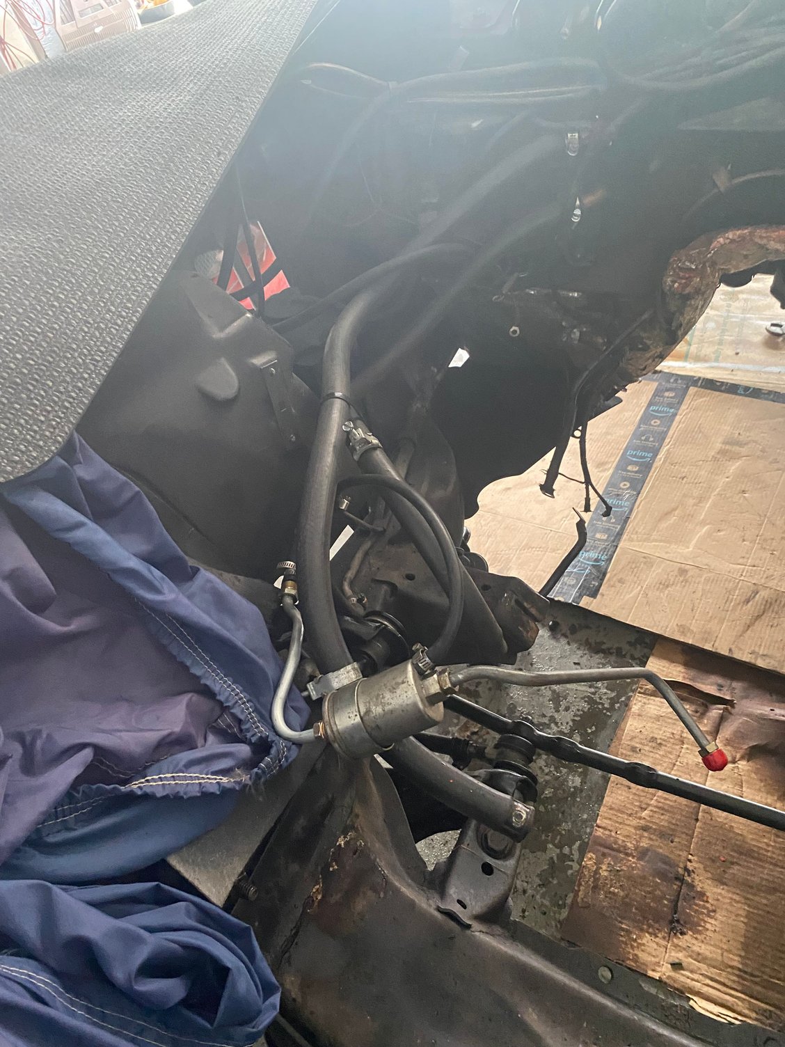

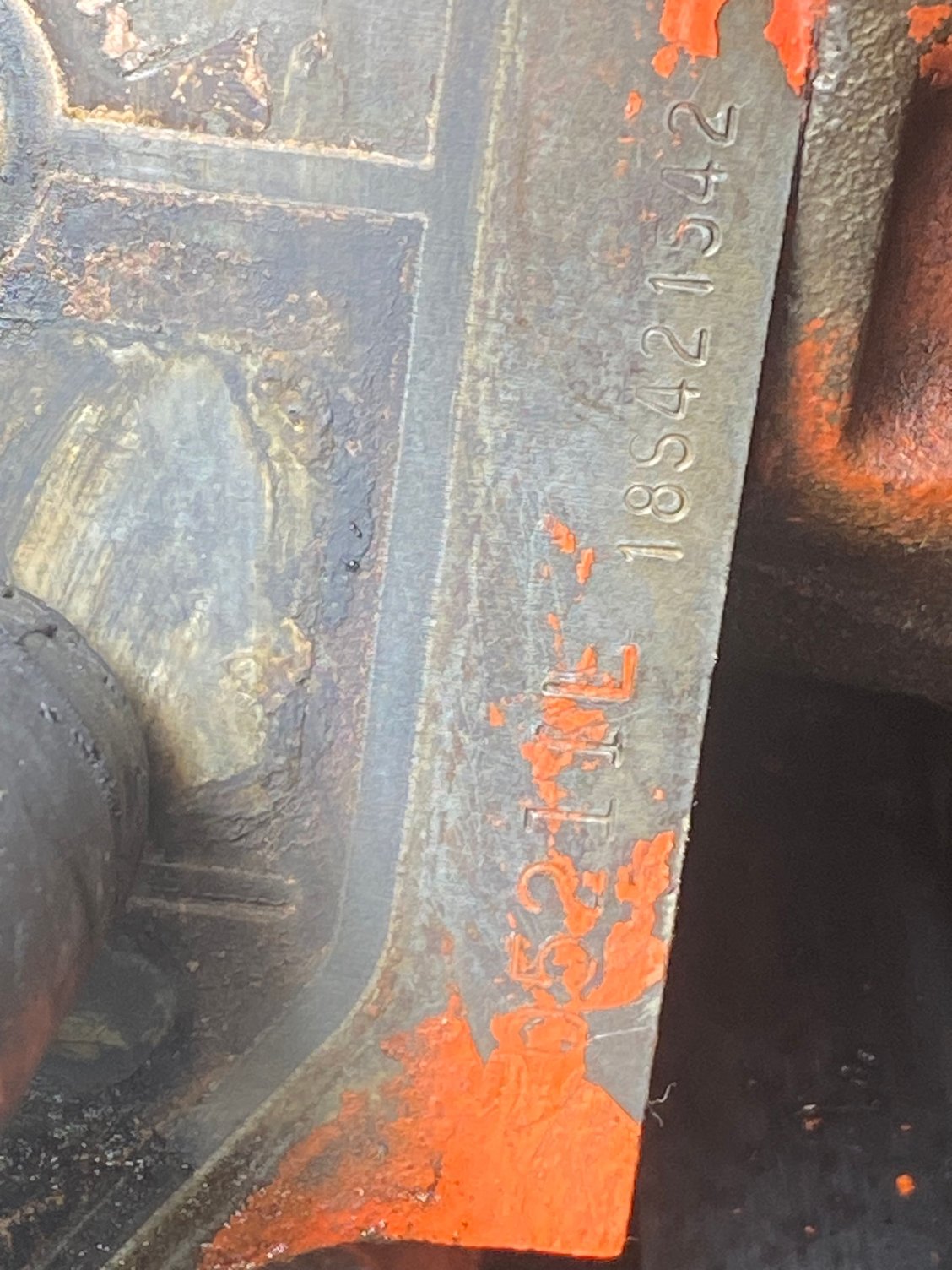

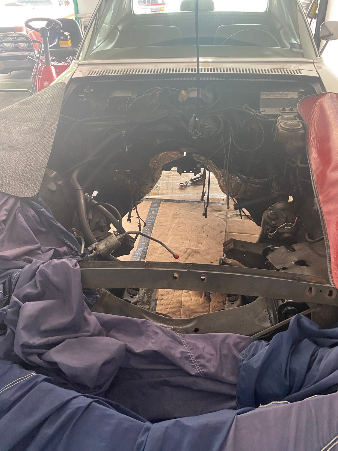

engine and trans out which has same number as vin, I see it has original clutch and parts so that is on the list also to get flywheel resurfaced and will start removal of radiator support and surrounding area for sandblasting and painting
Now can replace all insulation and cleanup

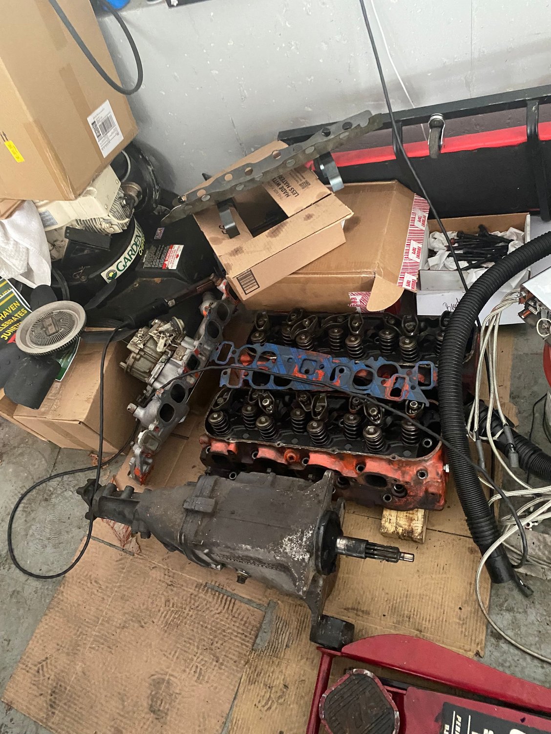

Okay so not sure if this should be a new thread/post or continue here. Transmission cleaned up and having checked. Motor going to the builder in 2 weeks but wanted to check if any what should I ask for any improvements over the stock build? am looking to keep car original but if spending money would like to improve the 55 YO engine

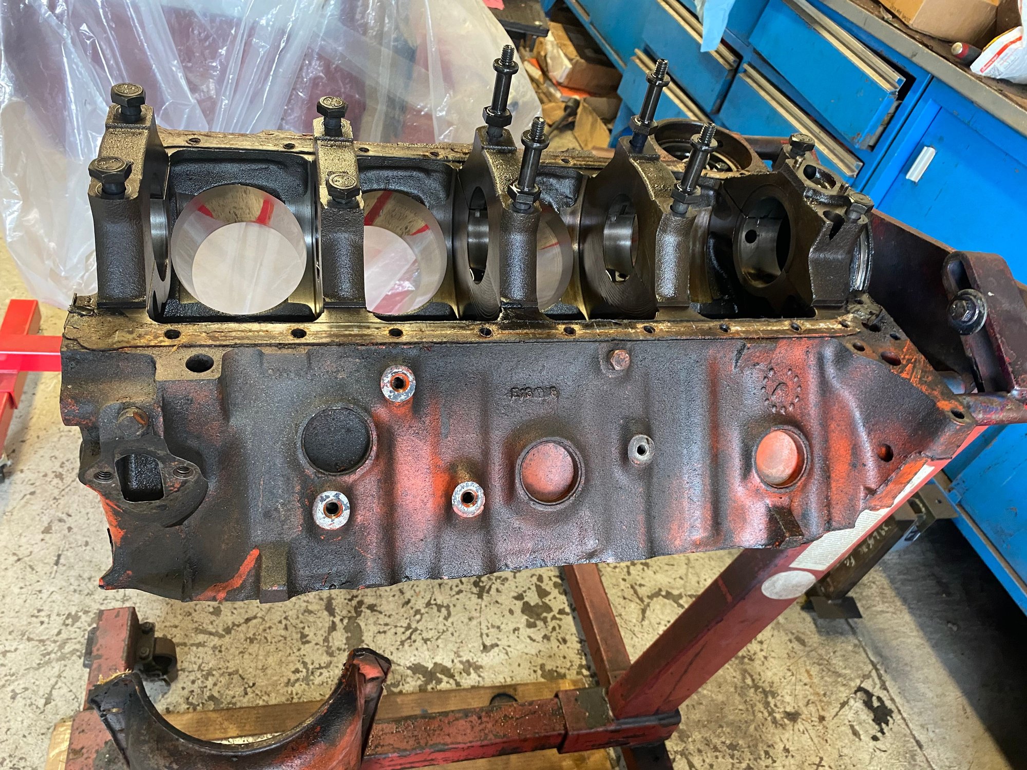

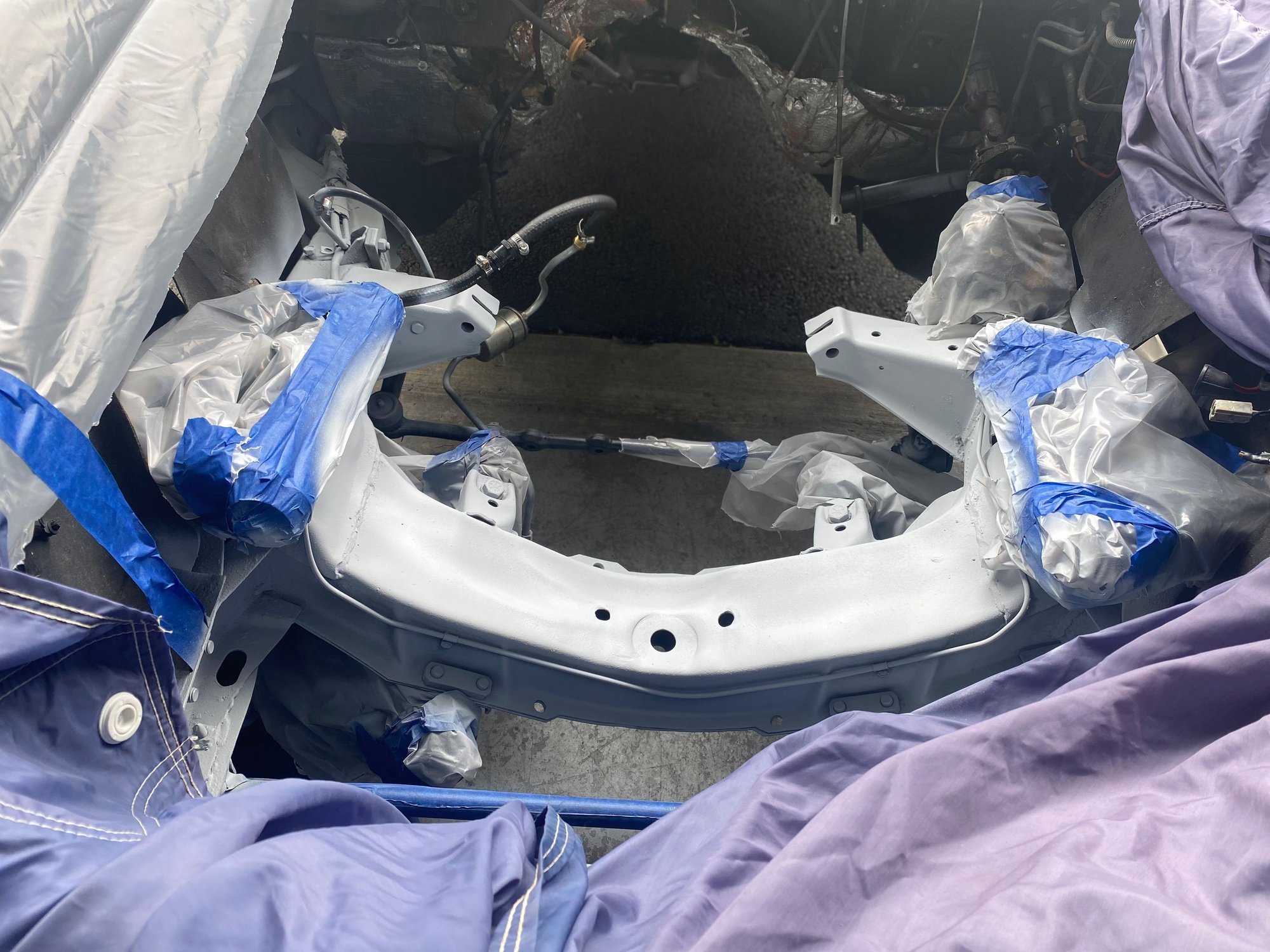

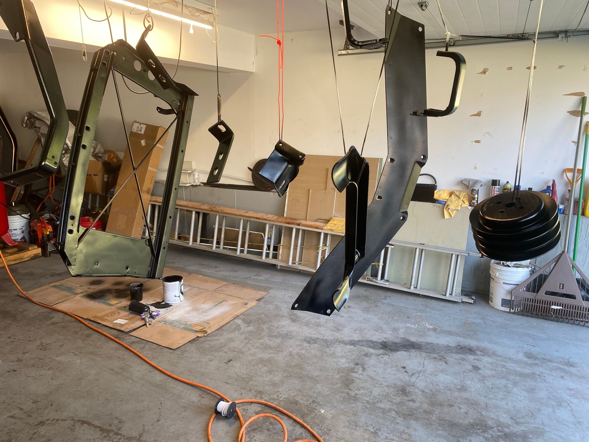

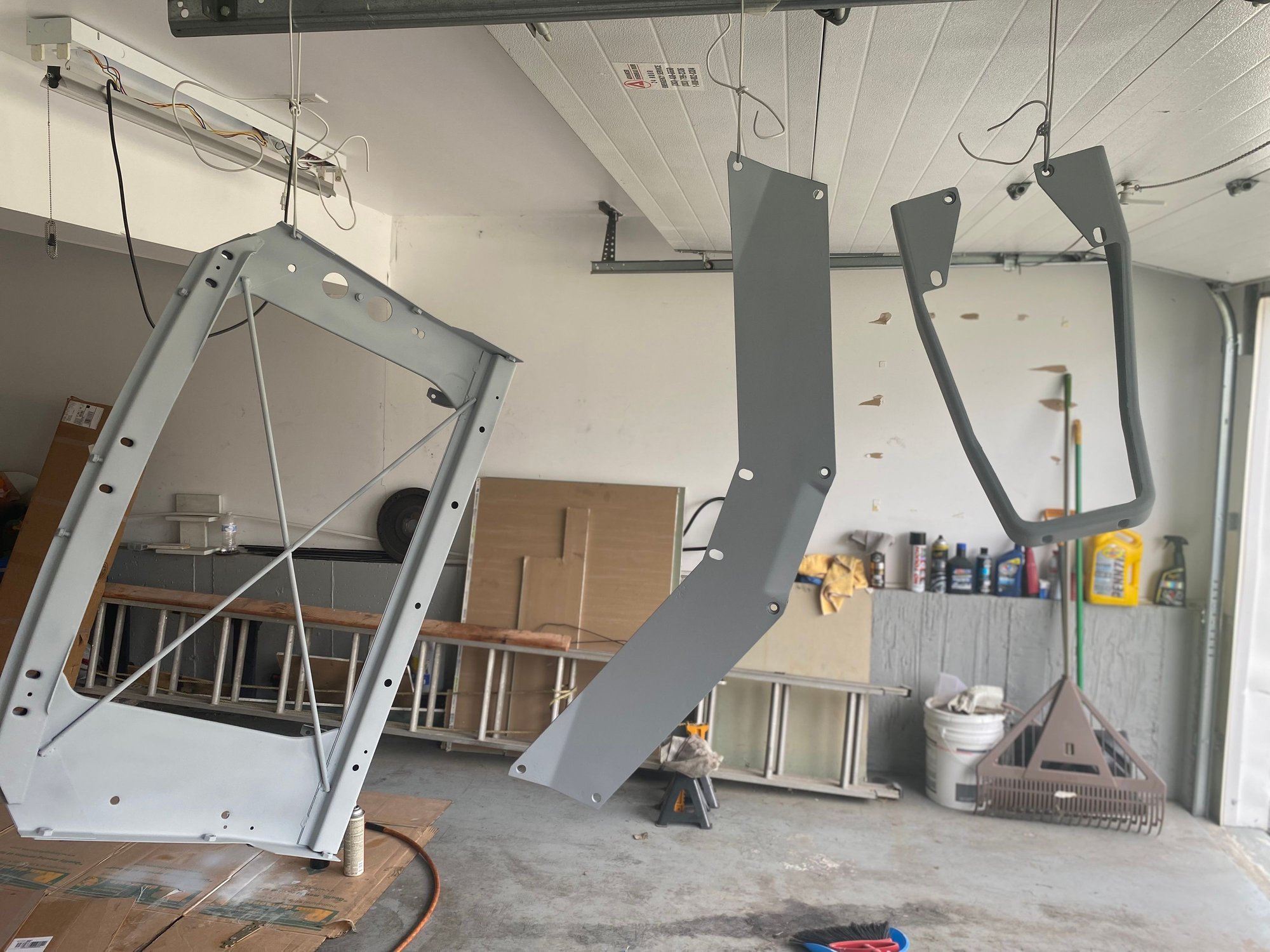

update engine at builder, found broken ring on 1 piston and it chipped that piston so having new pistons installed bearings, block cleaned crank polished and decided to get a little more hp having new cam lifters springs rods installed. New valves etc not having decked to retain #s matching also had exhaust manifolds sandblasted and ceramic coated all other parts stripped of paint and crud painted them myself, radiator being recored with original tanks and rails
Block disassembled
Epoxy primer after
Chassis Black frame on painting
Parts painted

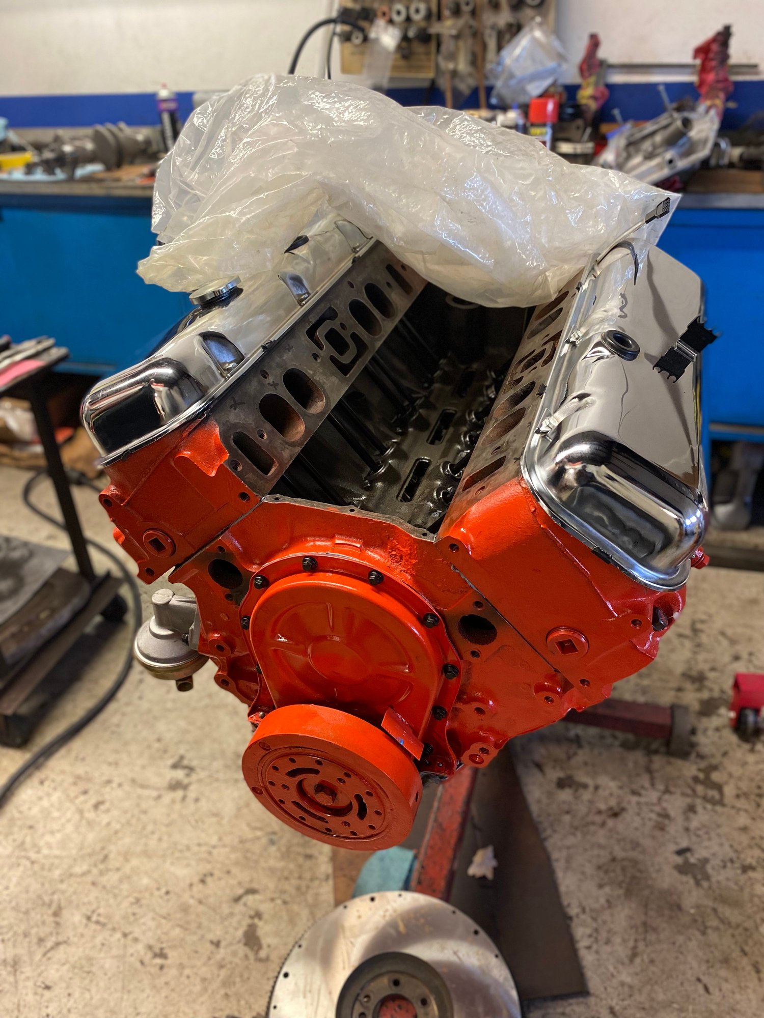

moderator can you change to Engine rebuild progress until then here is current photo gong on Dyno next week

Did you keep the stock compression ratio and camshaft?
You should paint those black ARP bolts while you can as they will turn to rust in a few months.......I always use stainless everywhere for this reason......
Post dyno results!
Jebby
Post dyno results!
Jebby
camshaft change attached, new lifters push rods springs and cam bearings, do you mean the ones on the timing cover? The head bolts I cleaned up and restored with heat and oil to keep the originality.

Yeah...the timing cover bolts.....
It will like that cam a lot....
Jebby
