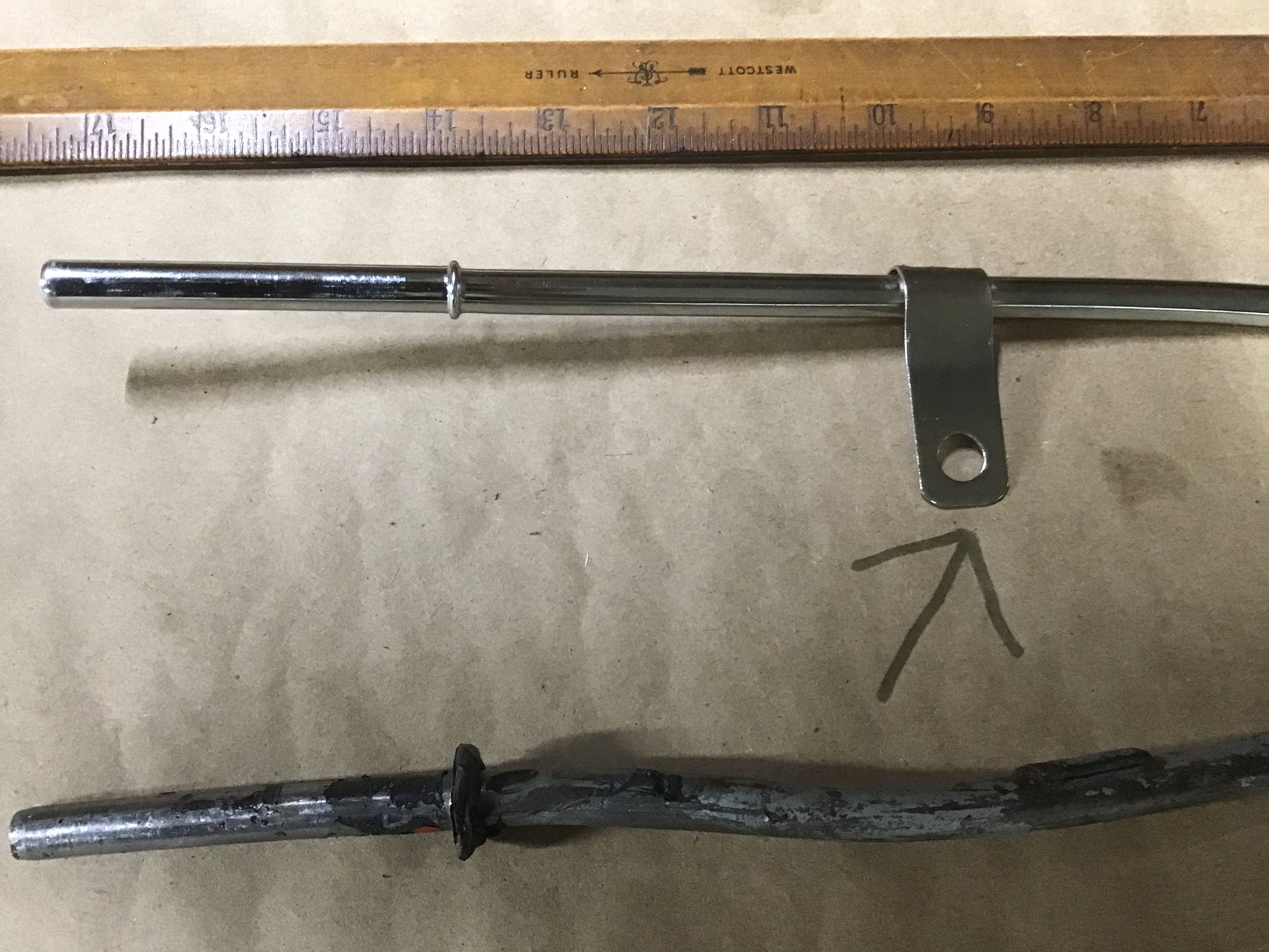

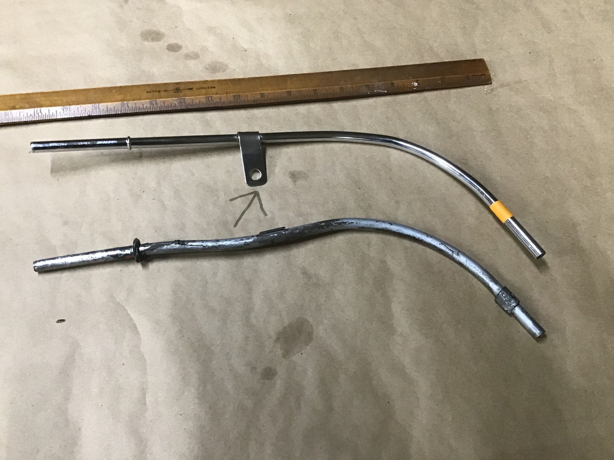

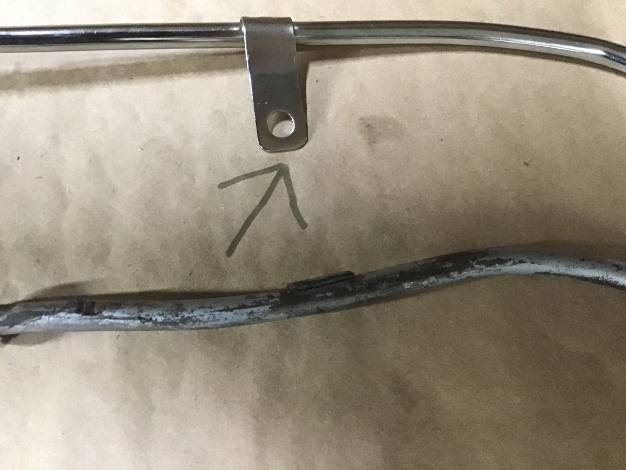

I replaced mine with a chrome one,mine has a small bracket,it bolts to the block where the big black ground wire is bolted.
My old one a shop was doing some work on my engine,and they broke my bracket off,the chrome on is a tad longer,but fits great.
I replaced my '72's dipstick tube and found the length was different from the bulge upwards. This would affect the oil level reading on the dipstick – in my case, overfilling the crankcase. I measured the pan-side stickout of the dipstick from the bulge to the tip when inserted in the old original tube and trimmed the top of the new one to get the same amount extending into the pan. As I recall, I ended cutting off about 1/4".

Yea,I think this chrome one was for a deeper pan than stock pan,I haven’t drained oil yet,so can tell exactly where it is on dip stick when I change oil,so I can where it is on dip stick.
