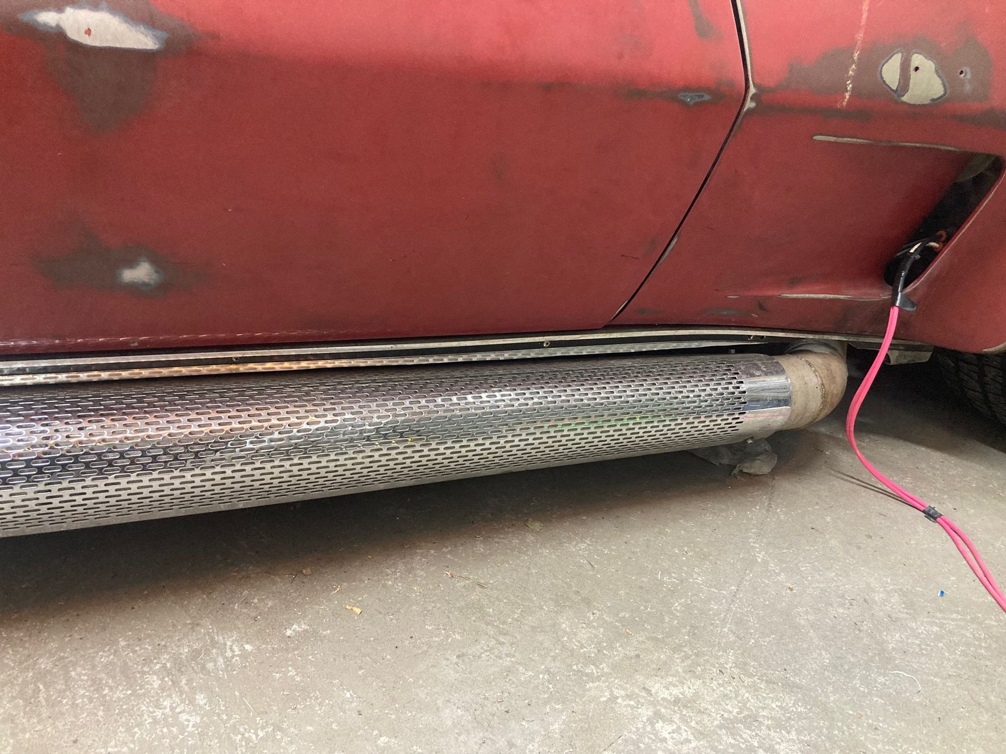

how did you get the pipes to sit that high up? . seems like most pics i have seen they are way low.
Old Dec 7, 2025 | 10:24 AM
DblTrbl's Avatar
DblTrbl
Joined: Nov 2013
Posts: 889
Likes: 472
From: Central NJ

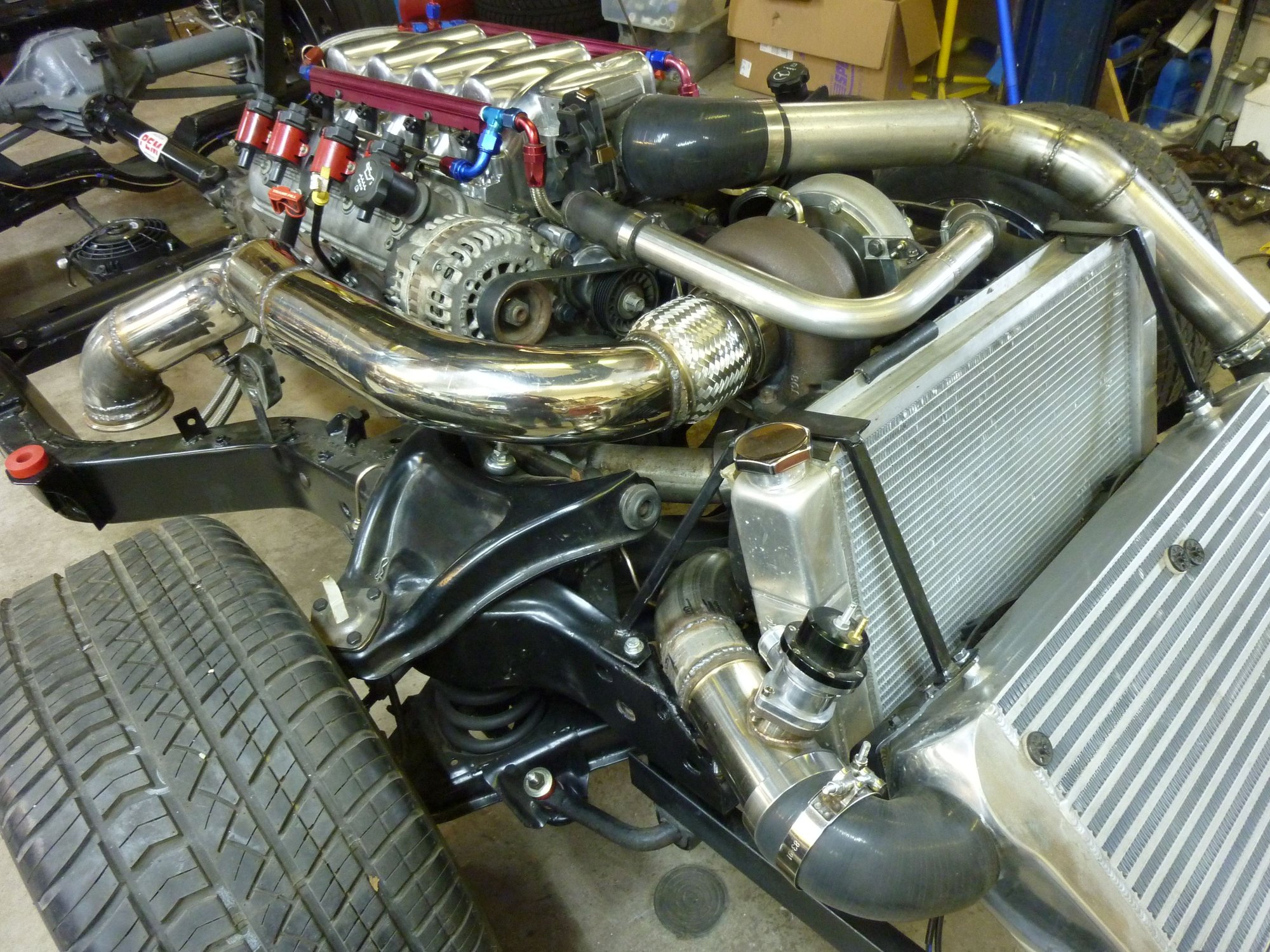

Here are pics on the ground with the trim added back in. Needless to say, I cut the trim to match the profile of the exhaust.
For the rear, I used a stainless hose clamp riveted to a mounting tab that goes to the chassis. There are spacers attached to the hose clamp to keep the shield away from the 4" exhaust pipe.
For the front, There is a rubber mount that keeps the 4" exhaust pipe in place. It's in the engine bay. Also in the engine bay, there is also a 4" V band exhaust clamp connecting the downpipe to the side pipe.
Here's a link to the build Turbo C3 Build
