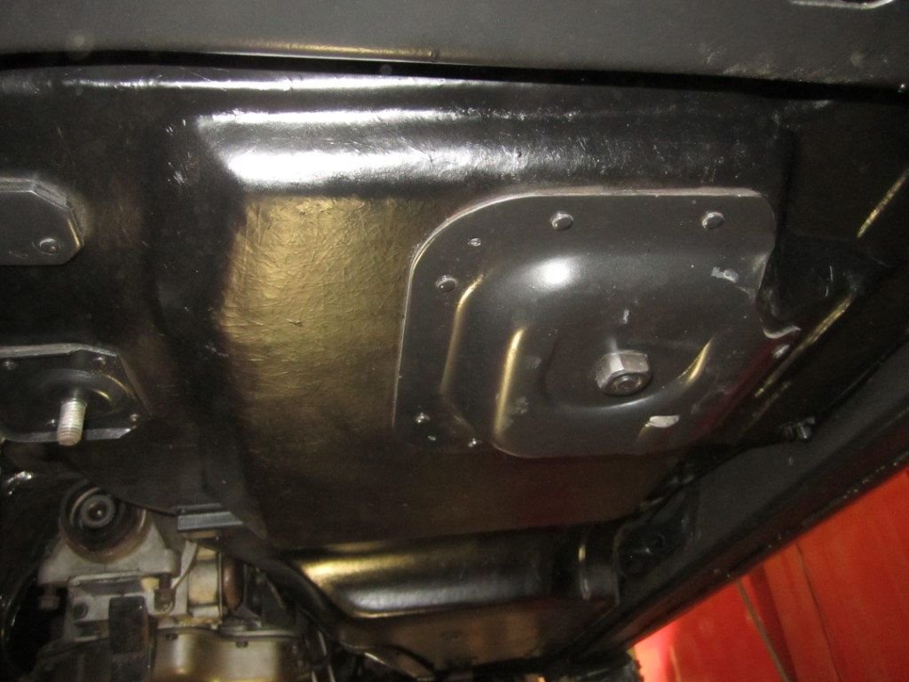

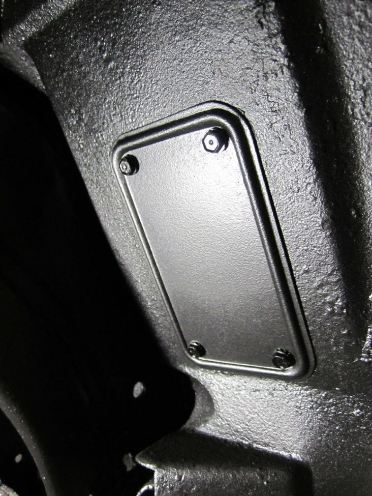

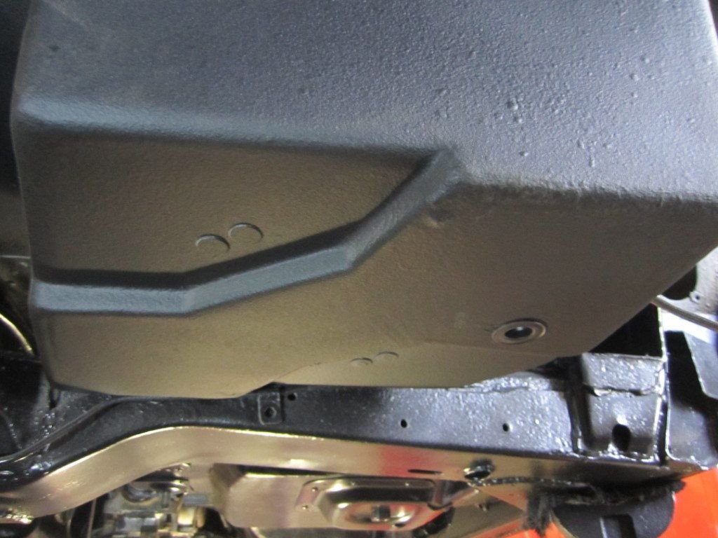

I used 3M 08883 on the wheel wells and anywhere it needed actual protection
Then used 08881 on all the jack and battery box areas, it has a slight brownish tint so I followed with a light dust coat of krylon flat
My floors are fiberglass (not sure what year you're working on) so they got cleaned and a dusting of krylon fusion semi-gloss. Looks glossy here but that's just from the flash going off
M
