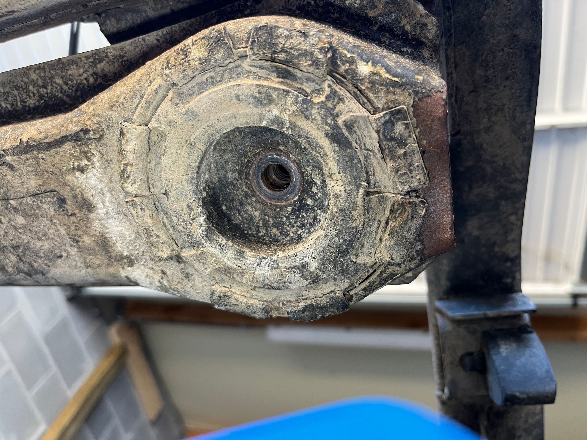

Greetz All,
I dropped the differential. (Man, that thing is beefy.)
Now I’m trying to get the crossmember off. No matter how much I pound and pry, it won’t come off. The rubber looks in great shape but I want this off the have frame sandblasted and powdercoated.
Any suggestions?

Originally Posted by calwldlife
"hats" are a known pain in the ***
What’s holding it in place ? Just rubber ? Can I drill out the rubber ?

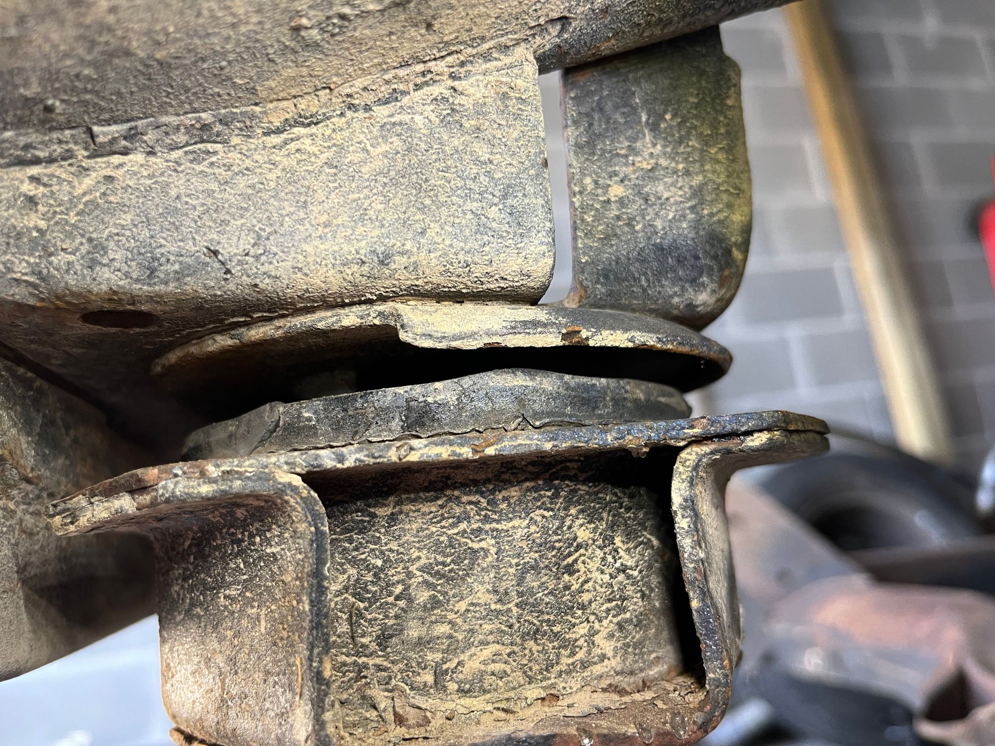

I dented my crossmember beating on it with a BFH and a 3ft pry bar. Wish I hadn't done that. The hats were very rusted (it's a water trap) and they swell up and get stuck in the rubber cup. They need to slide past the rubber, and if they are crusty they can't slide.
If it is rusted badly enough it just won't come off.
I strongly suggest the rust penetrant method mentioned above, and a big gear puller to apply some pressure, and let it take a week if needed. I wish I had tried that. You have to eat the rust out for it to work.

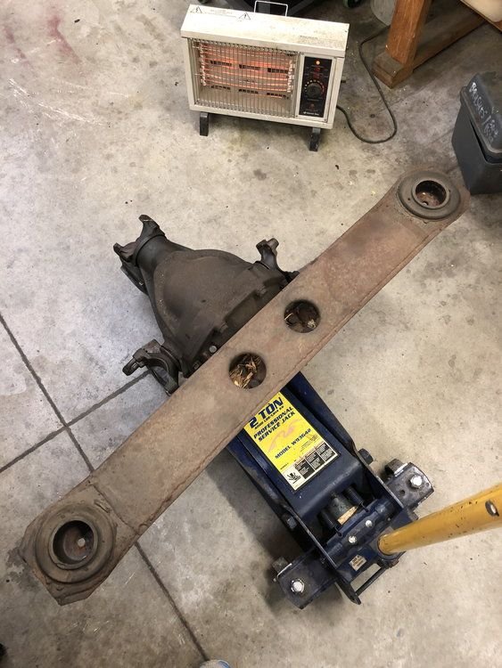

Go rent/borrow a two jaw gear puller from your local auto parts store and it will come right off. I tried a long pry bar and was scared it would slip and cause damage to my fender.
Old Jun 26, 2023 | 11:17 AM
DorianC3's Avatar
DorianC3
Joined: Nov 2017
Posts: 2,343
Likes: 517
Thanks gents. Fantastic feedback.
The body is off so I’m not worried about damaging anything other than my jaw.
The gearpuller would go through the bolt hole and jaws around the crossmember, right ?

You need to loosen the bolt about 1/4" and use the gear puller on it
