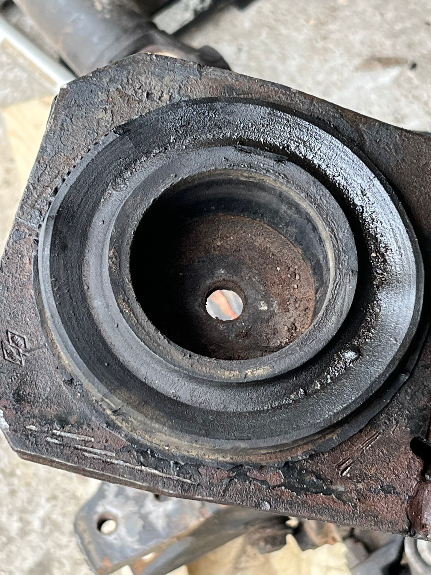

Someone finally saw things my way!!! And the mice clearly were busy at one point.

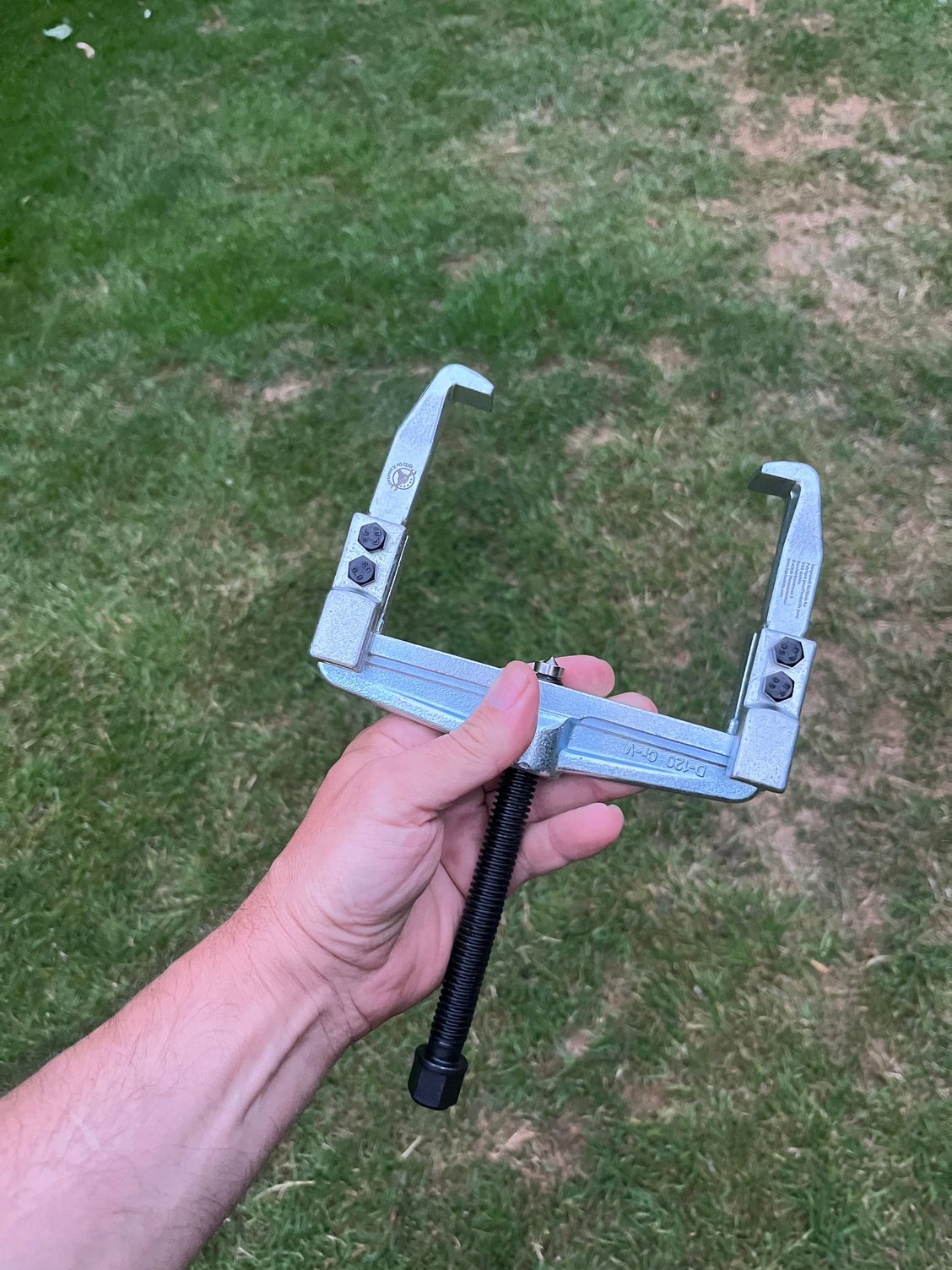

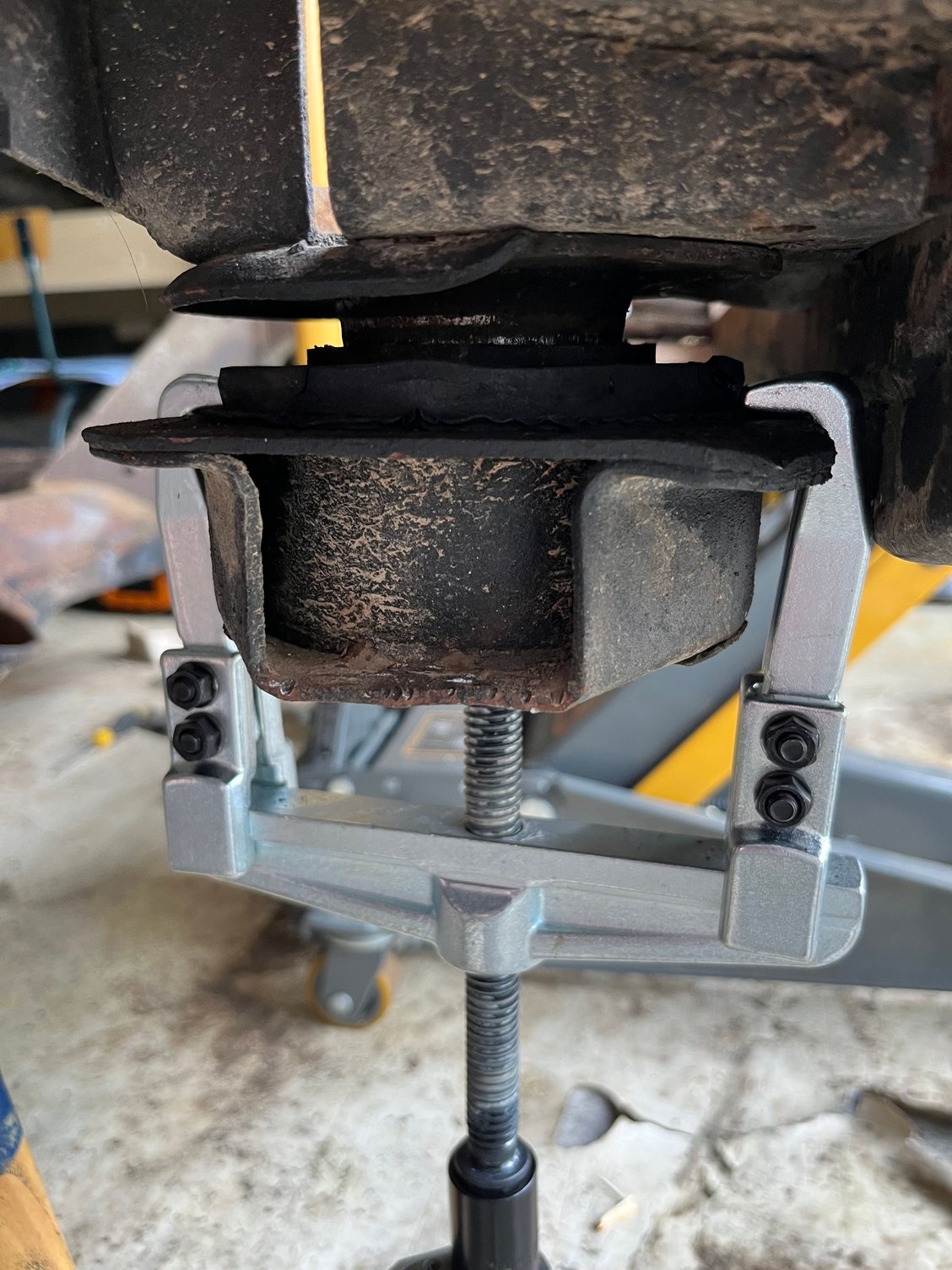

Day two of WD40 and Amazon delivered the below. It looks too flimsy to do the job - but maybe in combination with a pry bar and BFH
Looks wide enough.
Is big enough - if flimsy looking. 22:05 here. Too late to do anything.

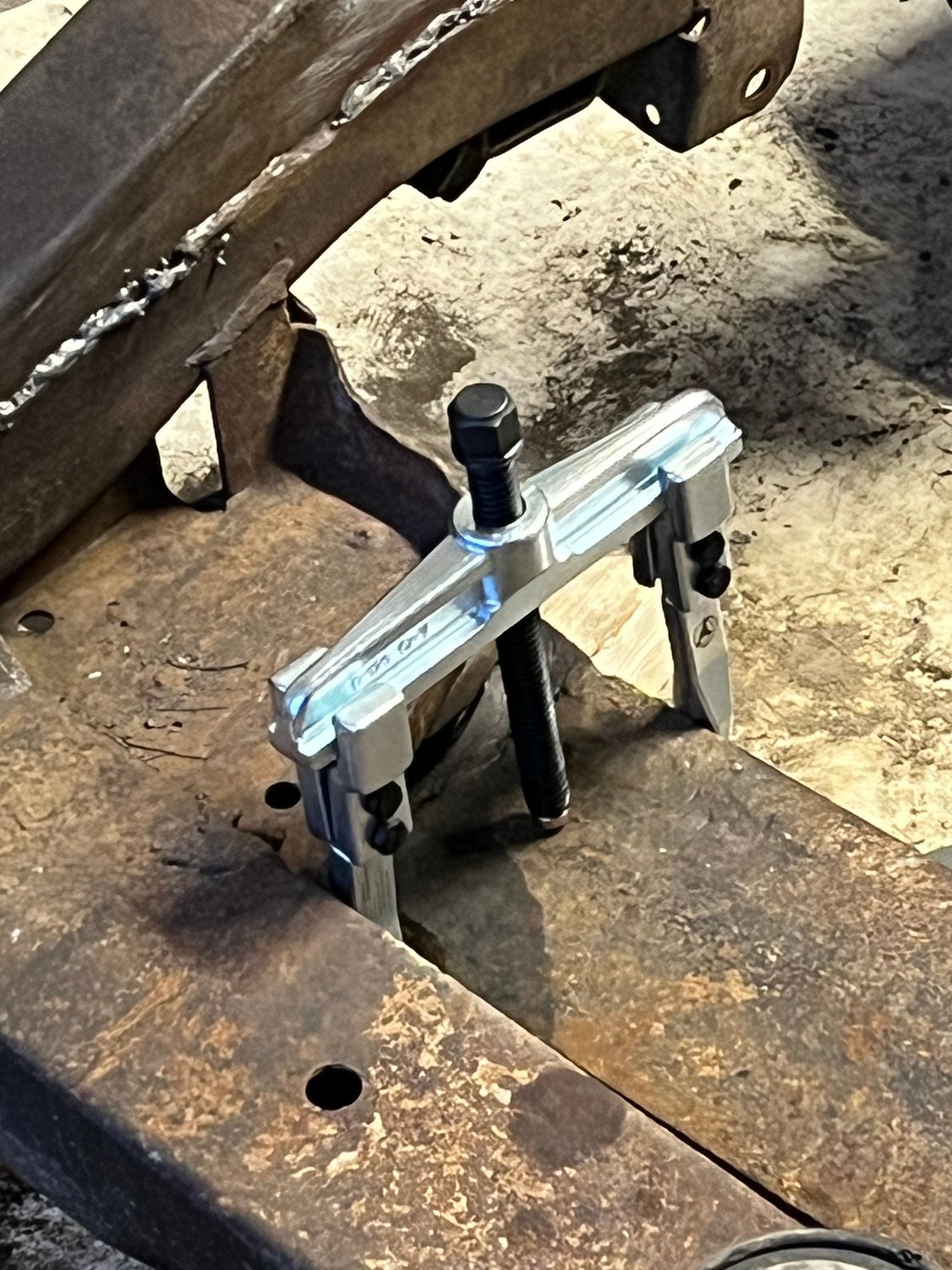

I got a large 3 jaw puller from O'Reilly Auto Parts. One jaw was tricky wedging in. Got that set up...hung the cinder block. Kept hitting with PB and a couple turns on the puller. After a couple days I put a pry bar in and that got it to pop. Amazing how frozen these things get.

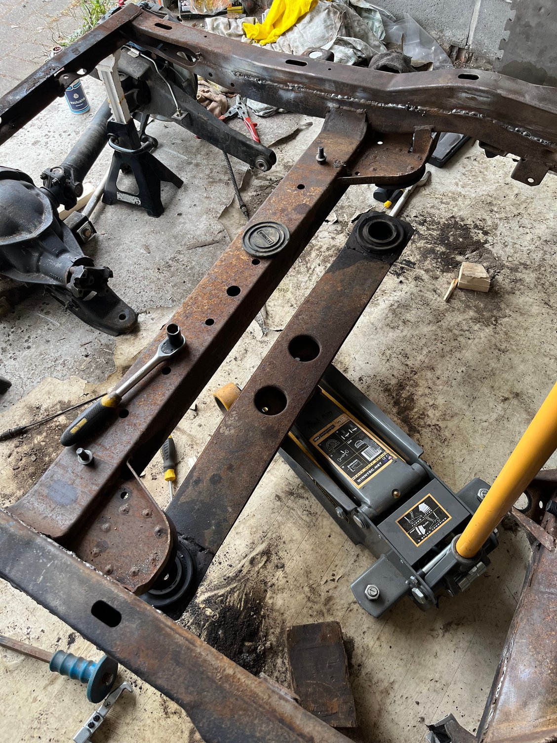

Success
Pop !!!! Always scary AF. Especially with these cheap pullers. Well spent.
Off it comes. Heavier than I thought.
Rubber is in very good shape. Keepers.
