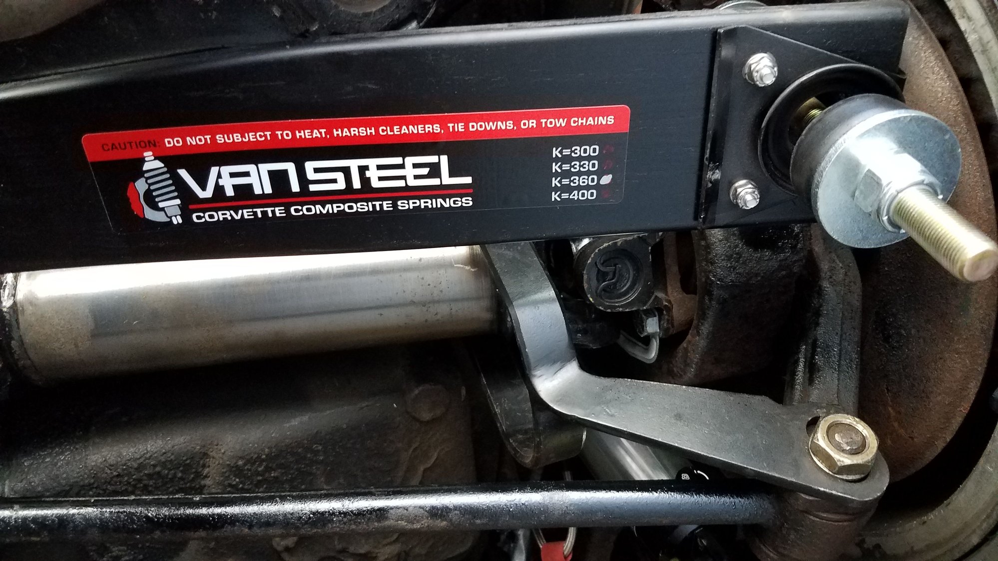

Well....I certainly don't want that; this is a numbers matching car and my aim is to keep everything as original as possible. My plan is to use the Vansteel 330 lb. low arch composite monospring.
Any thoughts or experience on that product?

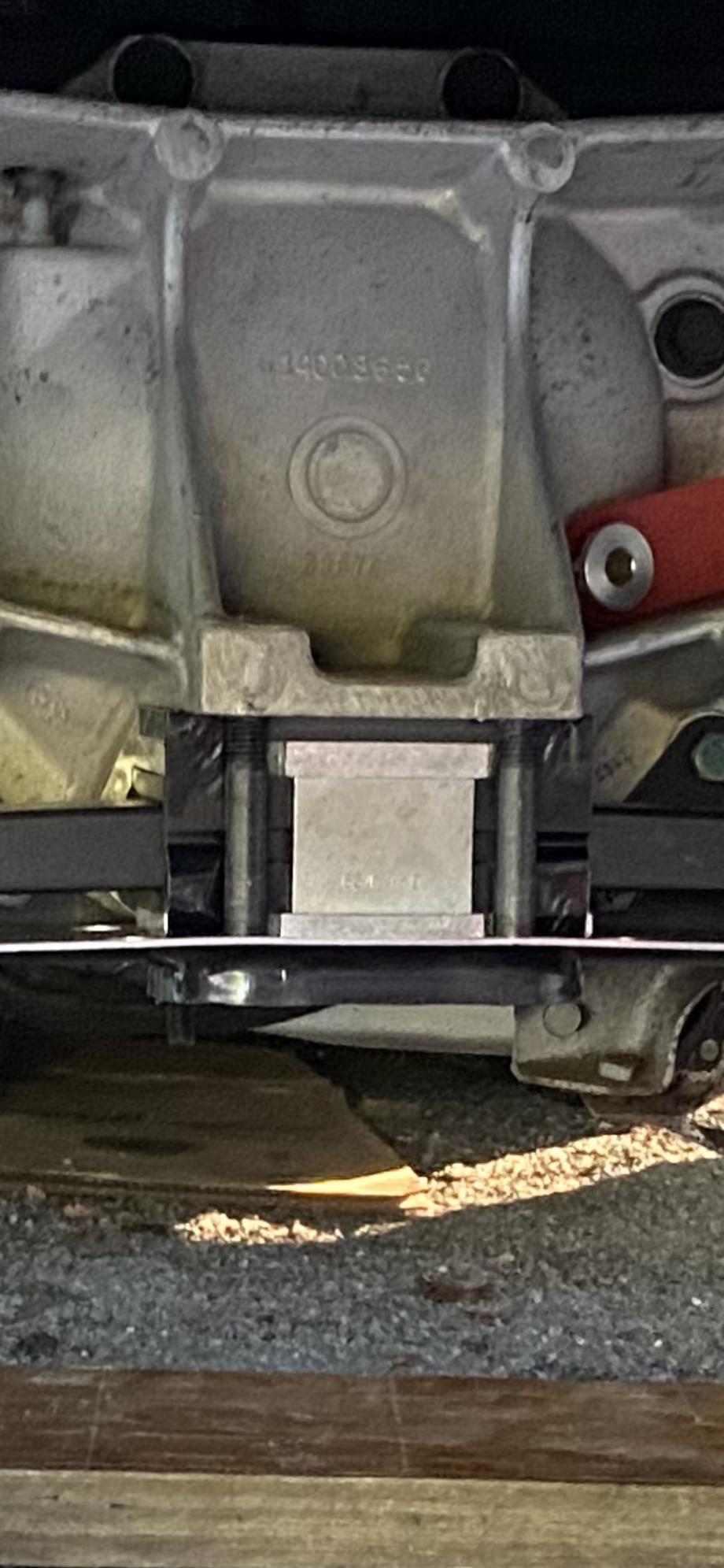

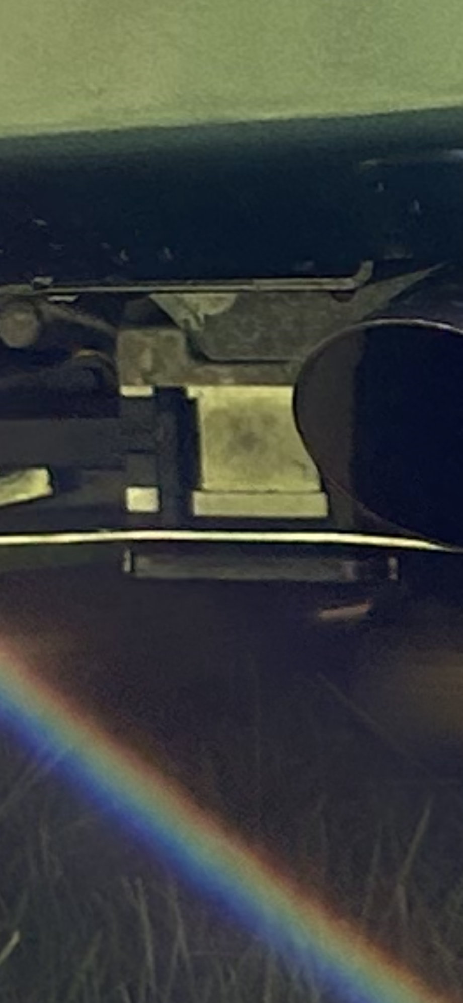

i being one of those guys who went the cheaper way. but after researching the van steel one i learned that the TRW one has the spacers setup differently from van steel and after rearranging the spacers i got the rear to sit about 3/4” lower.
before
after
sorry for the quality of pics.
notice the plastic fiber spacer and the thicker aluminum one are on the top in first pic. in van steel instructions for the 335lb rate (which i have the 340lb knock off) spacer should sit on the bottom. i switched them around and i was 29.5 from ground to wheel well now it’s 28.75.

Great post! I've never seen or heard of that spacer setup before. An extra 3/4" drop in the rear will probably make a lot of TRW spring-owning folks happy.

I have the VanSteel 360 composite, iow arch spring and QA1 single adjustable shocks. I had no problem with ride height using stock length bolts.
