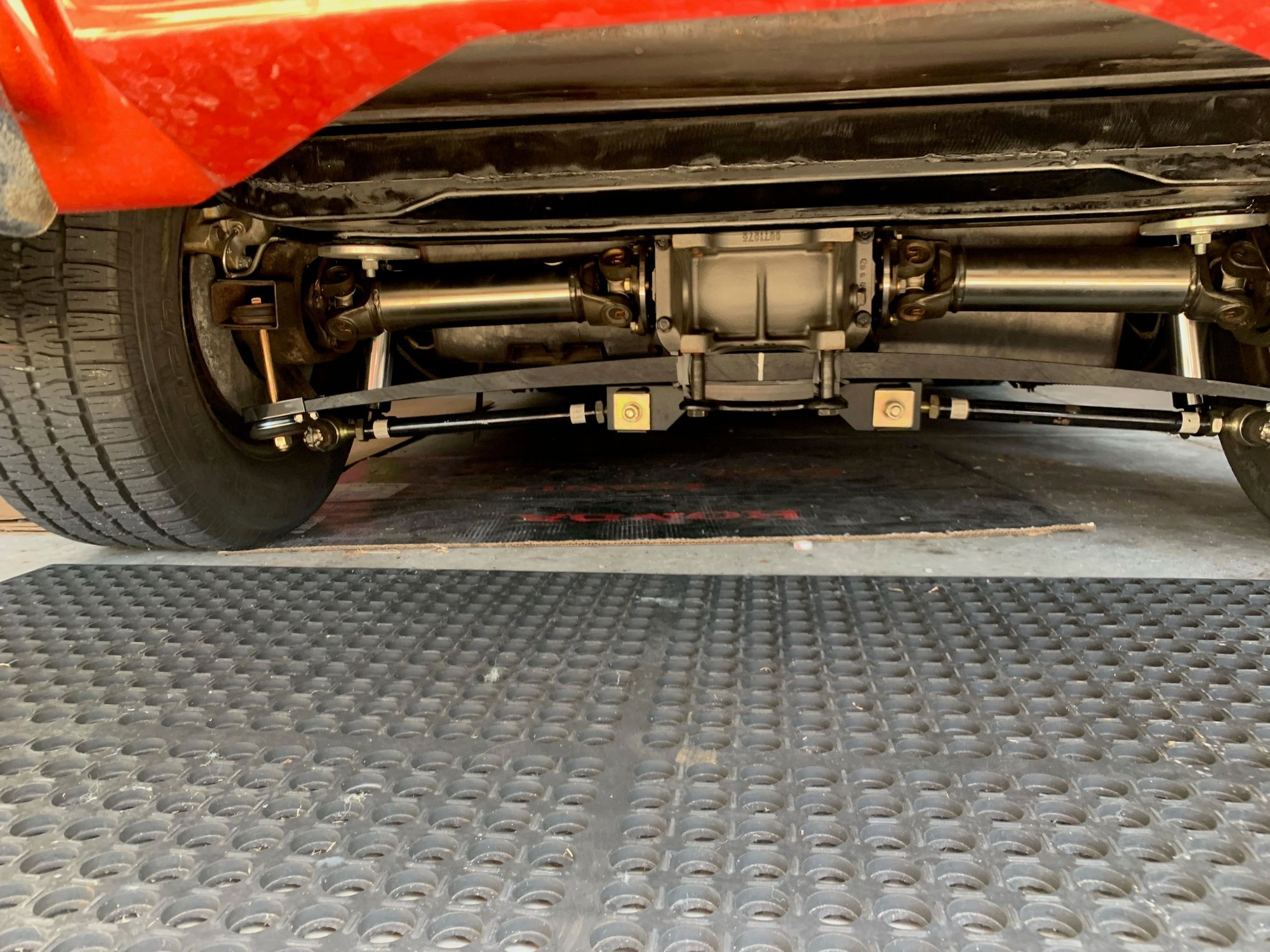

I have a VB&p composite spring thats either a 330 or 360 (not sure as I purchased used with no discernible markings). I installed it a few months ago along with a pair of viking dual adjustable shocks. I have yet to get the new front end components installed but the ride quality has noticeably improved. I have my shocks set for stiffer performance though.
