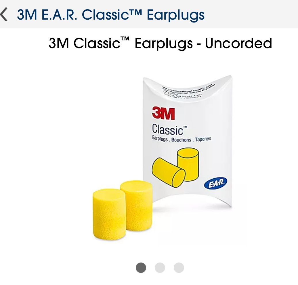

These work great to keep smaller threads clear

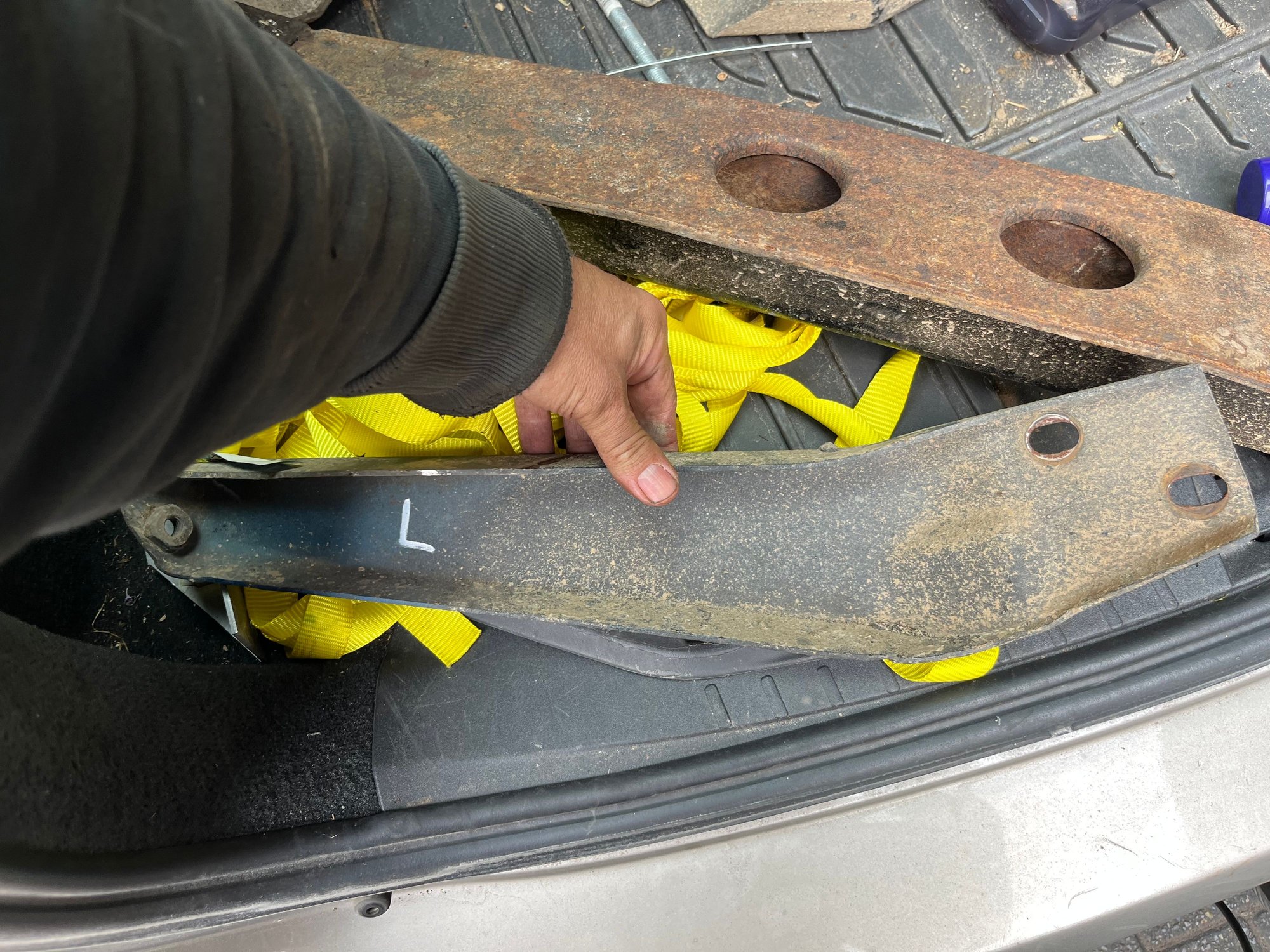

DorianC3's Avatar
DorianC3
Joined: Nov 2017
Posts: 2,352
Likes: 518
Dropped off. They said they would plug all holes and not blast off the VIN.
Alea jacta est

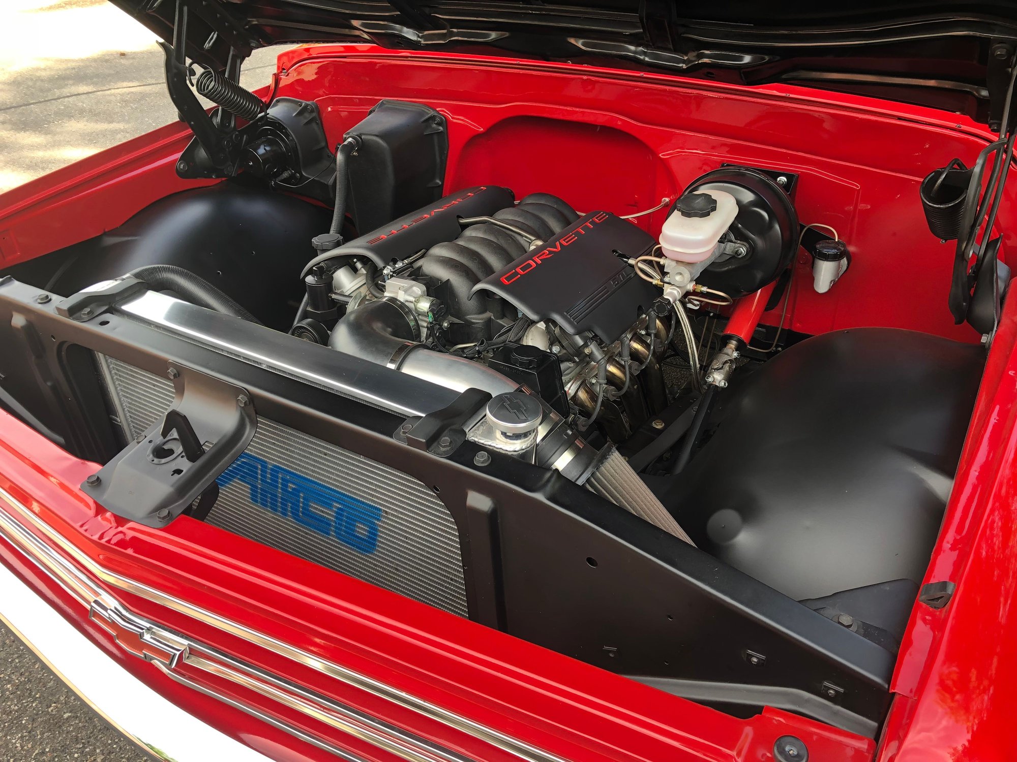

The company I retired from has a large powder coat shop. They plug all tapped holes with high temp plugs that the high temp of the oven will not affect the plugs.
Powder loves a nice sand blasted surface.
Also most powder coat shops have standard powder colors in stock that they use everyday. It can save a person a bunch of money using a stock color.
This is a pic of my 68 C10 with powder coat satin black.
