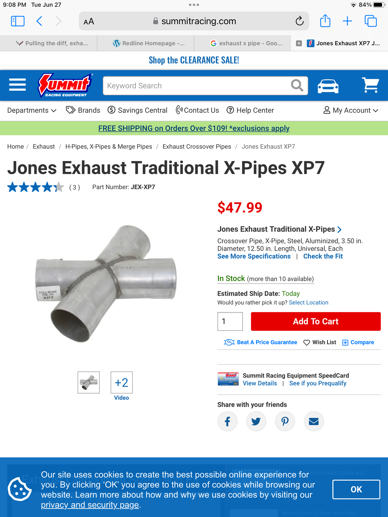

How about an opportunity for adding an x pipe and ss band clamps?
My goal here is to repair the blown rear, don’t want to go sideways on the project.
X-pipes though they do add a little more power they tend to smooth out that exhaust note taking away the music the cam makes.

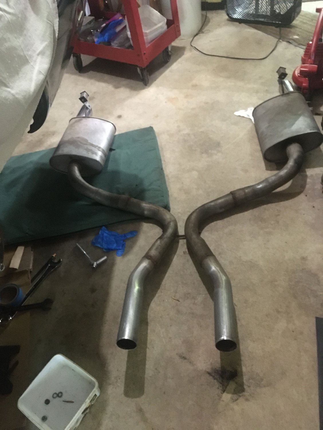

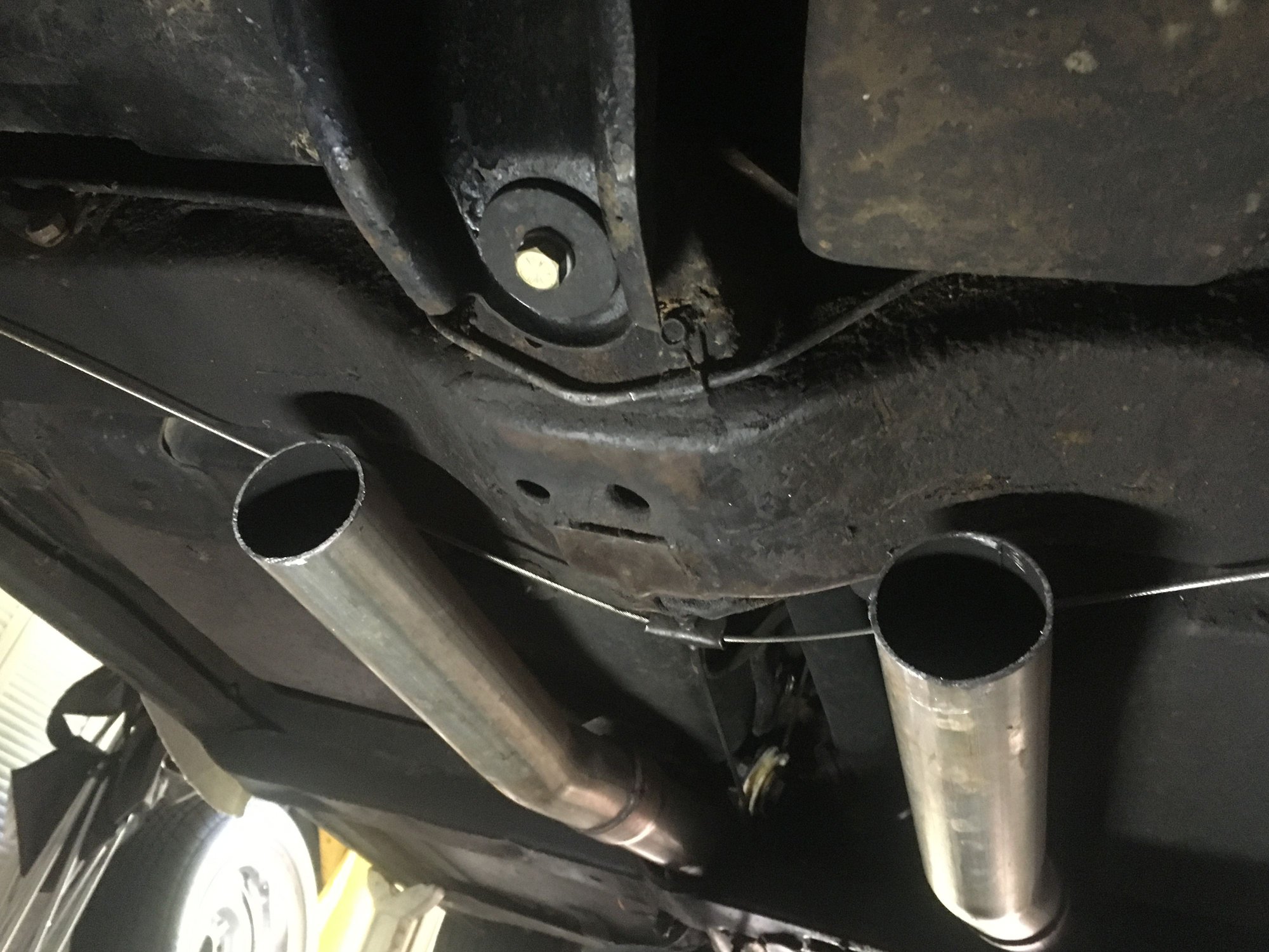

After much apprehension I took a straight edge and laid it across the pipes under the wide steel cross member just ahead of the diff and marked it with a grease pencil. That puts the cut below the crossmember and not fiberglass. It also falls in the middle of two 14” + sections of straight pipe. I wrapped it with a sheet of paper to trace it neatly around the pipe to follow for a clean cut with a sawsall. It went well and came out surprisingly clean. I then deburred the ends with a dremil.
The back half of the exhaust had been connected with a piece of bar stock welded to the pipes so it came off as one piece holding its angle perfectly. Reinstalling it will be a snap.
Note that even the tips were welded in place. Certainly easy to get at everything now.
Now I’m crossing my fingers that the rest comes apart ok.
