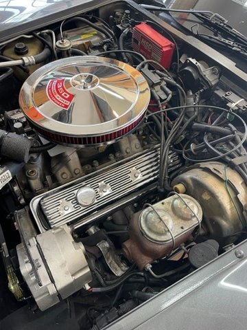

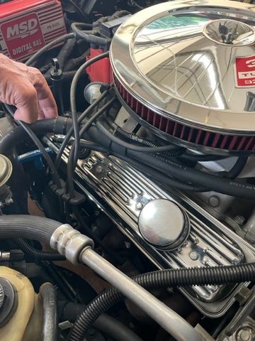

Here are both sides of my engine...PVC is on the passenger side/rear, oil fill is in front of that and is vented, the left side also has a vent...That does not seem right to me, I always thought PVC on one side and breather on the other... anyone care to comment on that??
I think I'm going to go with this one from JEGs... I ordered an amazon one and it just looks like trouble to me....
https://www.jegs.com/i/JEGS/555/5220...QaAihUEALw_wcB
Thanks,
60

I like the clear bowl, you can see when you need to empty it.
I agree with you, why would you want a vent and a pcv on the same valve cover? Can that one be plugged somehow?
