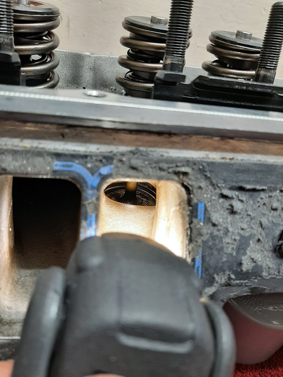

Hi Eric, This last question may be the most interesting. Made me take a closer look at the intake manifold and heads. Couple of observations:
  • Looks like the intake manifold has no oil in the intake runners, ruling out oil being pulled in from the PCV to back of carb.
  • Heads have little evidence of any oil on the floor of the intake runners closest to the outside edge where the manifold attaches. This might tell me the intake sealing was good, otherwise oil would be pulled up from a bad gasket and be consistent all along the intake runner.
  • There was oil residue down by the valve, with heavy carbon deposits on the valve top and stem. This could indicate it was the guides or seals, and maybe the Viton seals I got were the wrong ones.
Being desperate for a smoking gun, this is the closest I've come to it if this logic holds.
