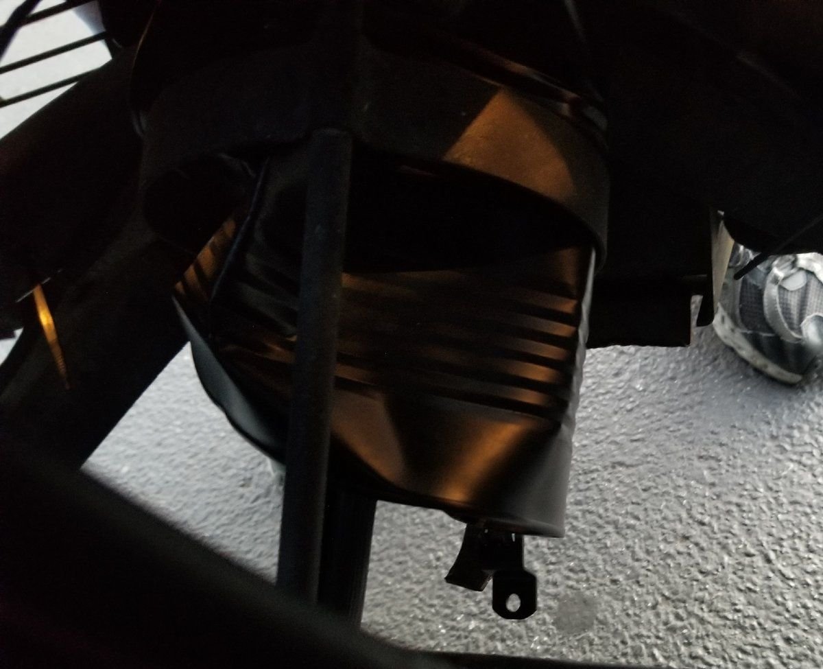

I’m trying everything and can’t find the solution. My Detroit speed headlights only open halfway. There is nothing binding that i can see. When I remove the motors I can open and close the headlights manually easily. I tried removing the springs and also tried using just the inner springs but no help. Anyone else have this problem and found a solution?

The module measures resistance to stop the motor.
Sounds like you have tried to reduce that by removing the springs and checked the operation manually.
To determine if its the module- I'd disconnect the arms and see if you get full travel. You can also reset the module by pulling power for 10 seconds.
I have dealt with a couple of them- the module is picky...

Thanks everyone for the help. I ended up going through the whole thing again. This time I kept the garage in complete silence while I manually lifted the headlight assembly up and down. You could just barely hear a slight scrapping sound which I tracked down to the headlight shields (aftermarket). They were just ever so slightly brushing against the lower part of the headlight assembly when it went up, right about the half way spot. So I took off both shields and sure enough the headlights work flawlessly, even with the springs installed. So now I am looking for an OEM set of shields to see if they are slightly thinner or maybe I’ll try reworking these or making up something of my own.
Just in case anyone has a problem in the future with these. They are a great kit and work awesome when they are right. The safety mechanism in the motor is just so sensitive that any light resistance will cause them to go into safety mode and stop where they are. When I tell you they were just brushing against those covers I mean just.

Not sure of your year but on my 78 the entire assy can be moved to adjust the gaps around the lid when they are closed. Maybe you can slide it all towards the back slightly so the bezels don’t hit.
