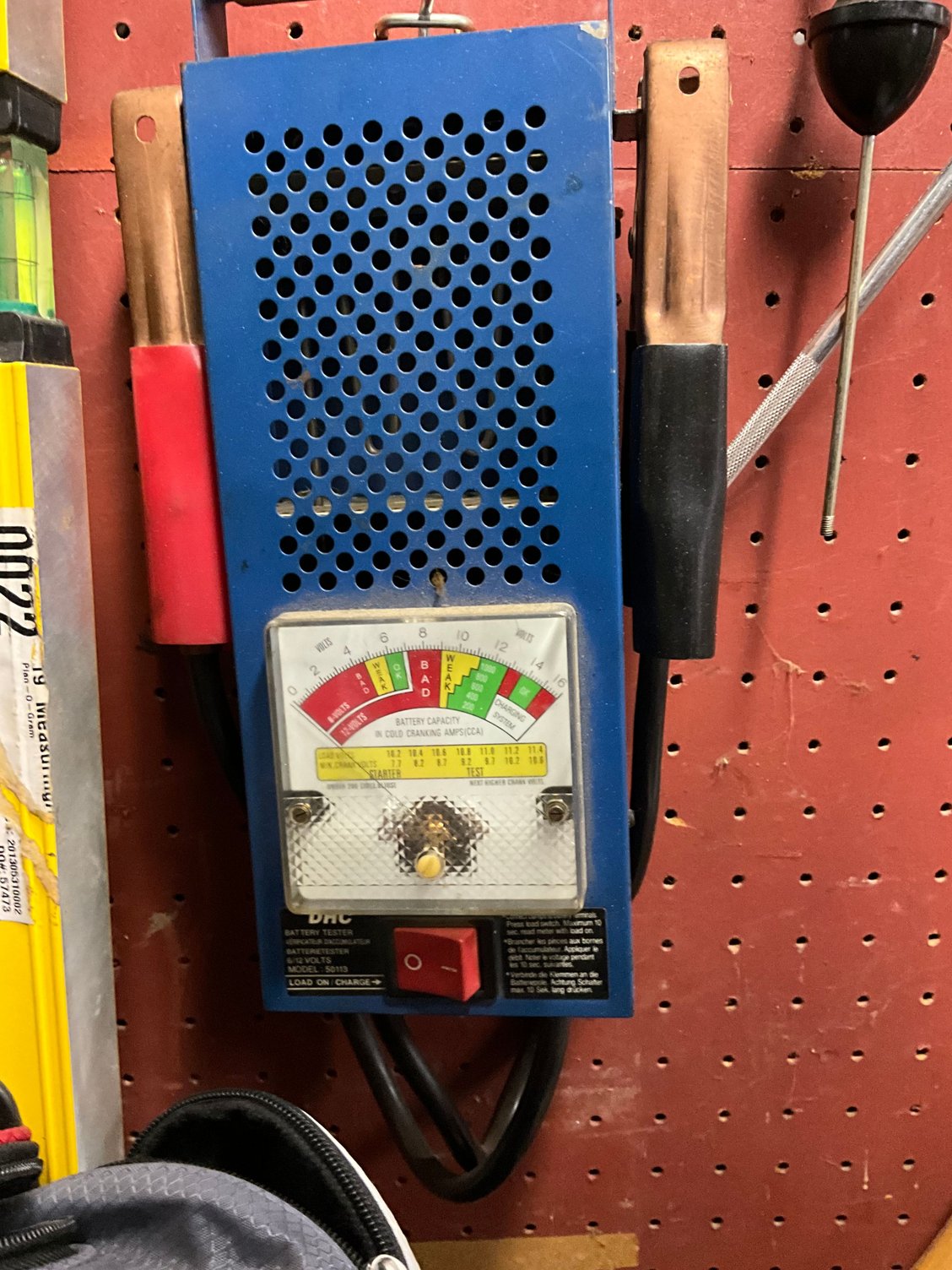

Originally Posted by Jud Chapin
Before you do anything, I'd have the battery "load" tested to verify it's condition.
I been using this old thing most my adult life, still works great and I think they still sell them…
Me too! Its an inexpensive tool that works really well.
