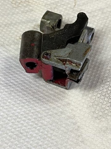

Here are 3 different GM pivot brackets, as you can see the only difference between the 3 is the hole size on one end of the bracket.
The top bracket should work on 1977-early 1979 with a T&T column.
Here is a switch you could rob the pivot bracket from, just drive out the solid 1/8" pin, enlarge the one hole for a pivot bolt to 11/32" reinstall your black plastic turn lever assembly.

The pivot bracket from the switch on that e-bay link I posted above is the pin on style.
You would only need to drive out the 1/8" solid pin securing the switch assembly in the bracket and replace it with a 1/8" x 1" long roll pin or use the solid pin that came out.
Personally I like the roll pin method vs the solid pin.
$35.00 plus some shipping is not a bad deal for that bracket...
