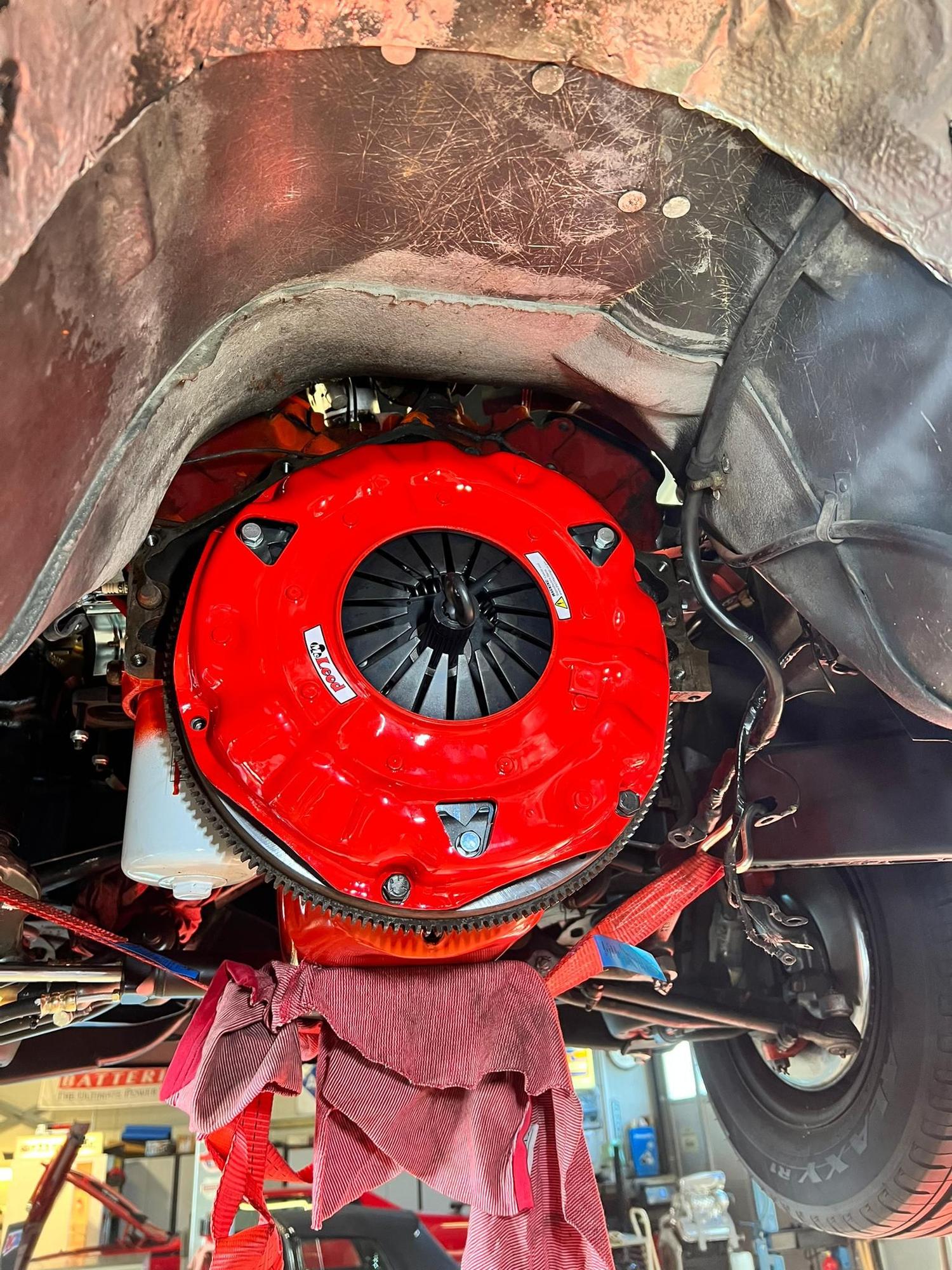

I vote for a McLeod 75121. I have had them since the last winter. Easy pedal feeling, for a street car and for fun-driving enough to 400ps. In my opinion, oversizing brings nothing.
The engagement point is very near the top, this took some getting used to. Possibly it is also due to the setting or that we have resurfaced the flywheel. Pivot and clutch fork are original.
My old clutch was very hard and I had sometimes calves cramp ^^

I am using the McLeod RST twin disk clutch in two of my cars and I love it. Pedal feel is nearly as light as stock. No chatter. Smooth engagement. I'm running it with a balanced 24 lb. steel flywheel with a hydraulic throw out bearing.
