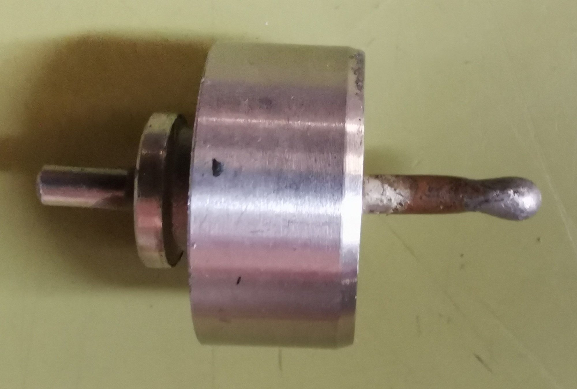

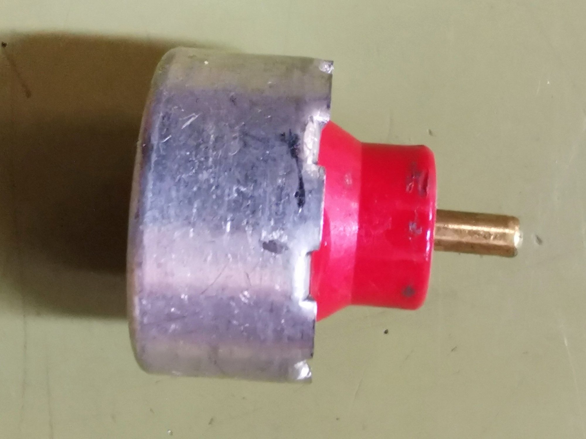

On my A6 compressor, I had to mount a pressure switch (it is flat at the back) instead of the original superheat switch because it was impossible to mount it in the intended location: the hole was too short for the temperature probe.... This is for some reason.
I had to modify the wiring for this new pressure switch.
Now, the manufacturer of the new compressor says to use the Superheat switch :
My question:
Can I mount the flat pressure switch again instead of the Superheat on this new compressor ?
In my opinion, it must work because on my old, it seems that everything was ok.
I also searched how I could electrically control these switches on the forums, without success...
I found that the pressure switch has no continuity between the connection pin and the switch body

After some research, I know a little more about the subject.
I’m thinking of putting a superheat switch on my new compressor.
I have two in stock: one that has a contact between the two terminals and one that does not!
For me, there must be no contact: if the pressure or temperature exceeds the limit values, the contact is made and therefore, the grounding is put. This melts the thermal fuse that stops the compressor.
Is that all right?

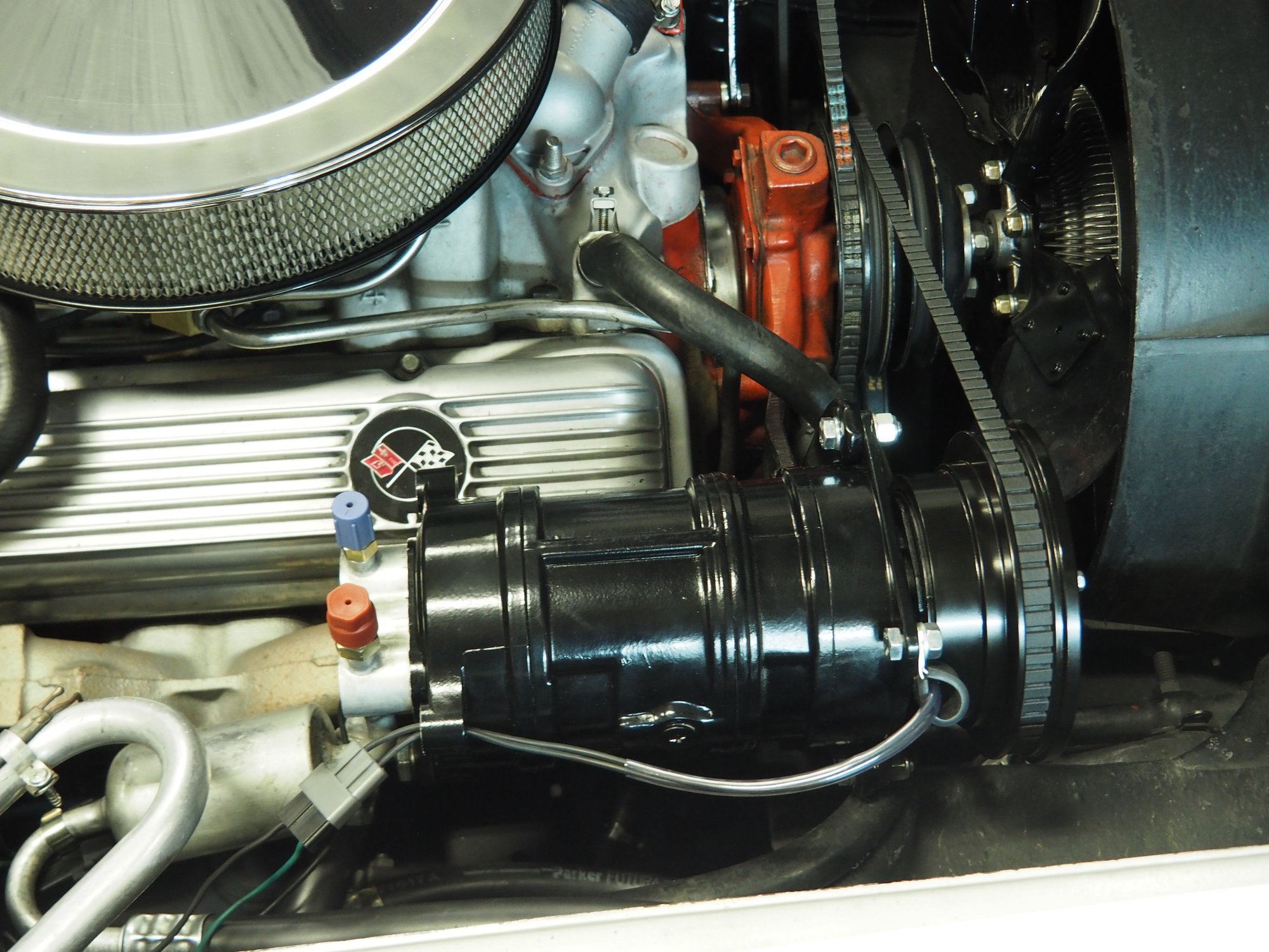

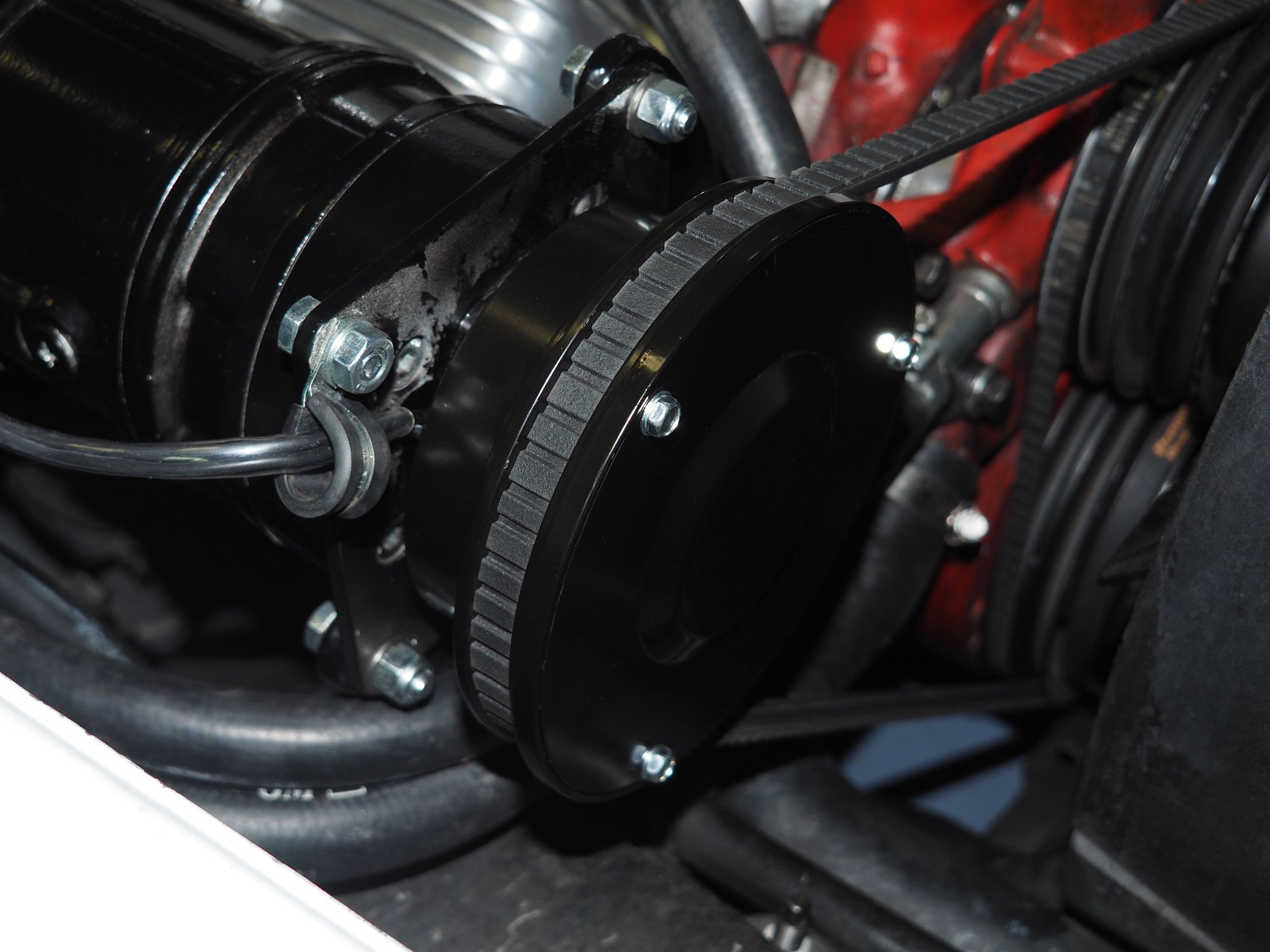

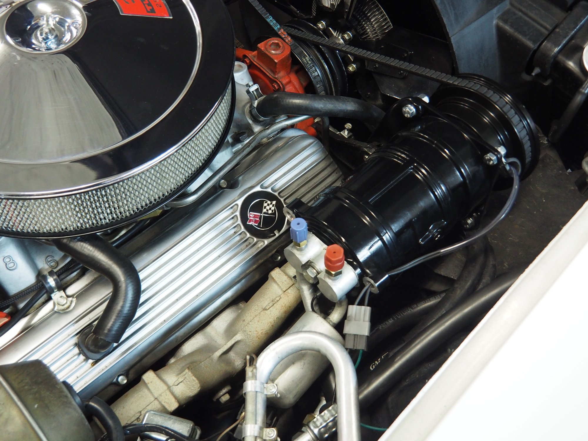

I've bought and now mounted my new 4-Seasons Compressor.
I painted it in black. It is full adaptable on my LT-1. The only difference is the metric mounting hardware : not a problem right here in Switzerland ;-)
I did not see that the flange is an aluminium material : with the manual based torque, the threads did not resist !
Therefore, I mounted counter-nuts and problem was over.
After a gas charge in my local mechanics, it seems that all is working good now : no strange noises, no drag on motor.
