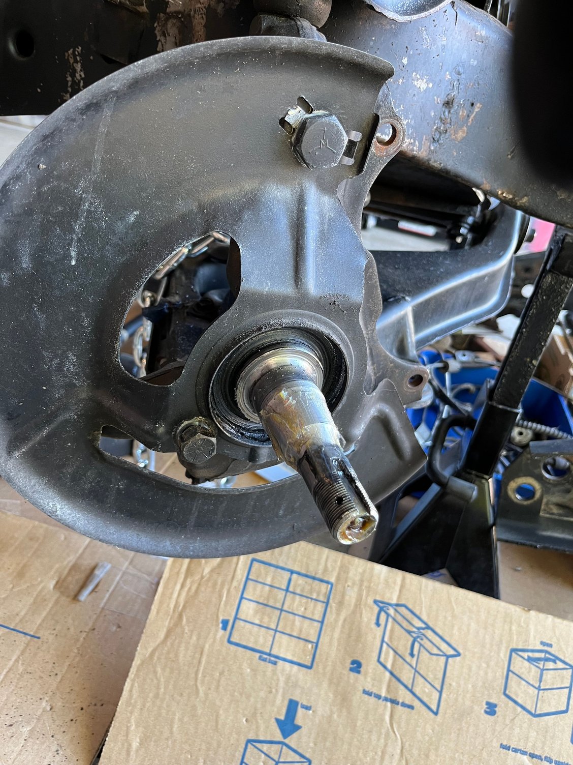

I pulled the front caliper brackets, dust shields, and hubs.
I was surprised that when I removed the cotter pin the bearing/ hub nut was so loose I was able to remove it just using my finger tips.
The hub slid off and the outer bearing dropped out of the hub.
I was expecting to need a puller to remove the hubs.
Is this normal on these cars or was Bubba in there?
Both drivers and passengers sides were the same.
I want to check the front axles for wear.
What are the acceptable specs before the axles need replacing.

Normal on the front wheel bearing with a touch of wear
Look very closely at the spindle surface where the large bearing slips on. If there is a little step there, it means that the bearing inner race has spun or has Brinelled the surface. This means that no matter what you do, the new bearing will always be a little loose on the spindle! This is something that is easily overlooked.
