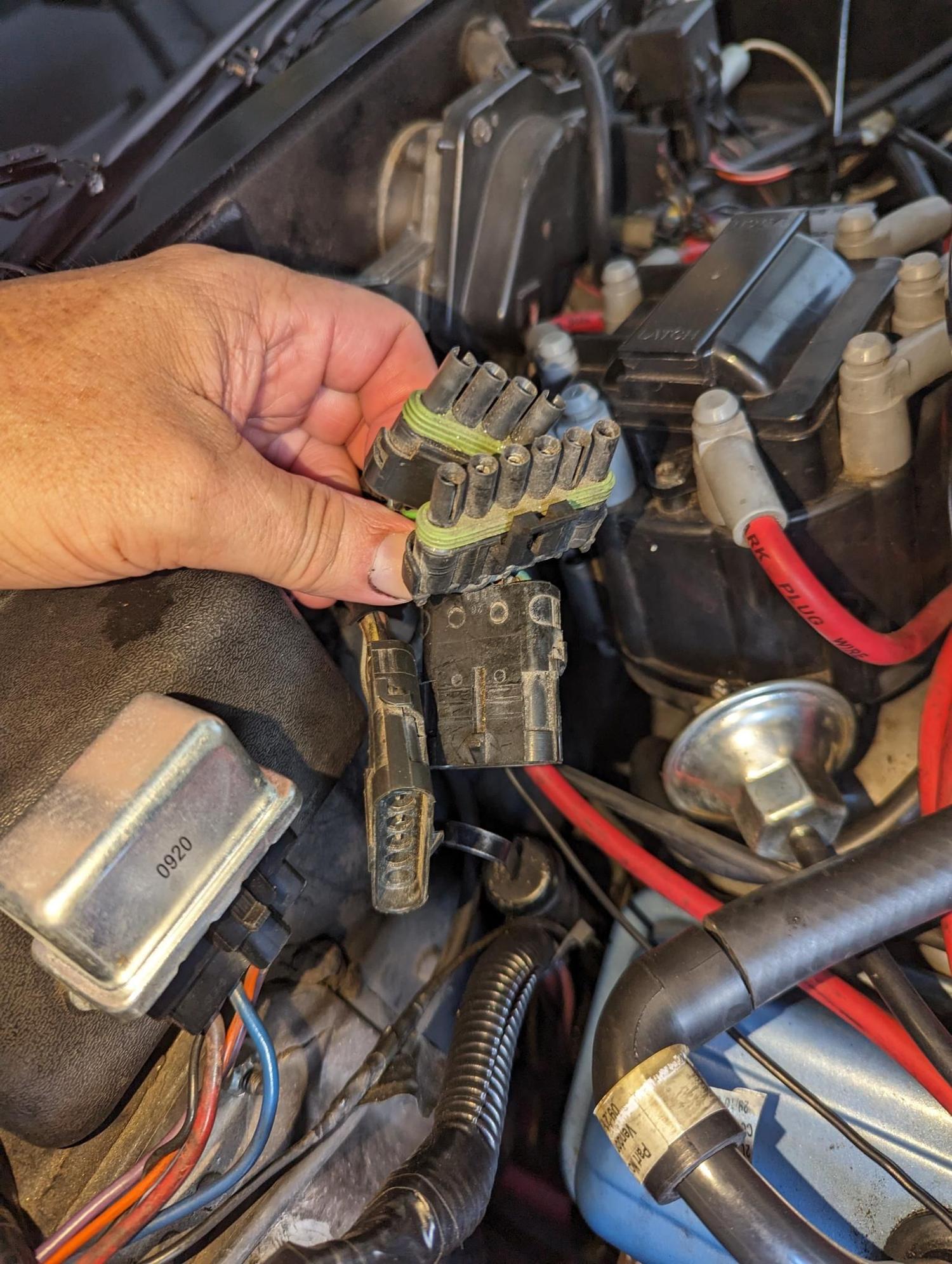

Originally Posted by RubbaBizkit
So your suggesting 0.13milliAmps is too high?
I'll get a pic of the flat multi-pin connectors that are grouped high on the center firewall. My memory is that they are 8 to 12 pin flat connectors,....like three of them.
THANKS ALL!!
These are the assumed "abandoned" connectors when PO put in crate 350

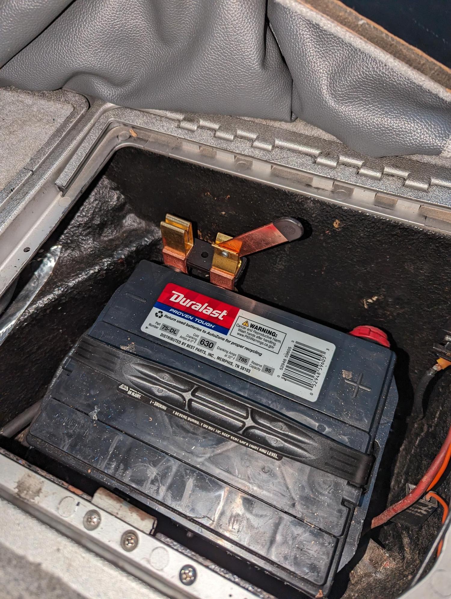

I just did that! :-)
So this is my present condition. I had challenges with charging the battery back up over the weekend. (my big professional Schumacher charger never progressed to "FULL" until after a messed with the connections 3-4 times - battery got hot which alarmed me) BUT battery is back in and cranked strong. Drove it Sunday and today and I disconnect the negative terminal switch each time I get out (pain...)
Well this little neg terminal switch appears to be proving it's not my battery.
Unfortunately I will need to find the current-draw-gremlin. Maybe this weekend - but it's too friggen hot these days!....

You can bridge the switch gap with the ammeter and see if you have a current leak. Did you check the fuses in the multimeter?

Did a check of the load draw on my car...looks like only 1.65 milliamps according to the meter. Put the meter into DC mode. No clock load, alternator and battery are newer. Fortunately car can go a month without any issues. These knife switches do make it easy to check.

So it's been quite a while since I've employed the Blade-Switch "bandaid" solution. That appears to have buried the problem for now. I throw that switch and I can come back to the car after a week+ and it starts right back up. I'm pretty sure I have a "momentary" bad current draw that happens when I am not around.

Another unique thing to mention => when I bought the car it was not running. The previous owner killed at least one of the fusible links. What happens if the shop I brought it to did NOT know about the fusible links and just ran a parallel (new) wire???? Could this action potentially bypass something that causes the car to wake-up and start to draw current again......?
