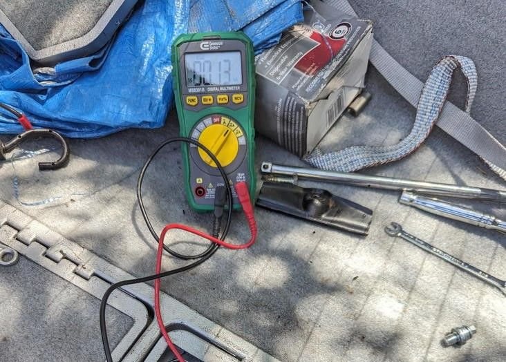

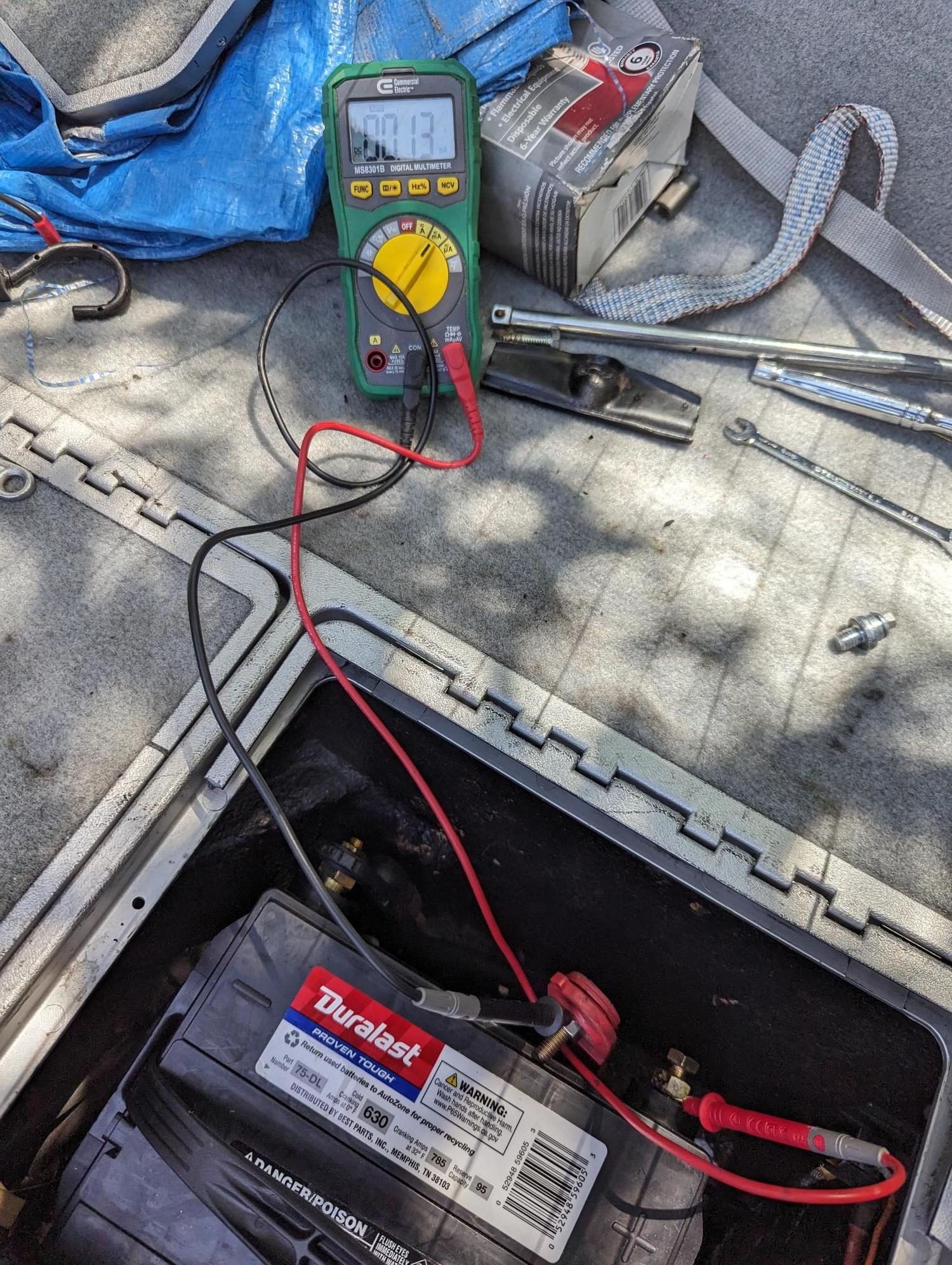

I have a 1981 C3 with a 2018 rebuild where the PO put in a 350/290. The firewall has a bunch of extra connectors just hanging there "dormant" (or at least hoped dormant). I have had the car for about 2 months and have a nagging current draw on the battery making it dead after 2-3 days of sitting in the garage (SC hot unattached garage mind you). I read somewhere that anything less than 100milliAmps is OK sleep current on a battery. I tested mine and it reads 0.13milliAmps.
Any suggestions? Is something "waking-up" when I'm not looking that draws more? Love any/all thoughts

Have you had the battery load tested? .13 Milli amps is nothing. Remove the clock fuse to see if it drops to zero.

I would hook up your amp meter to the battery and start pulling fuses until it shows zero draw. Then you know what circuit the draw is coming from.

The first rule of owning a classic car (or anything, today), shiny and new doesn't mean it works correctly. You could have a bad diode in your alternator.
Pull fuses until you find the circuit. If you pull them all and still have a draw, it is likely your alternator.

Shouldn't the red plug of the meter be plugged into the "A" connector to read current?
Update: Checked my meter and there is a switch position for ma/ua that uses the existing red connection shown. As Bikespace mentioned below there could be a blown protection fuse in the meter if the current draw was too high for that input.
I wondered that too. That is correct for reading mA (milliamps). It indicates 0.13 milliamps, or 130 microamps. At 12 V, that's less than 2 milliwatts.
That's not what is causing the battery drain, though I'm willing to bet that the fuse inside that multi-meter is fried.

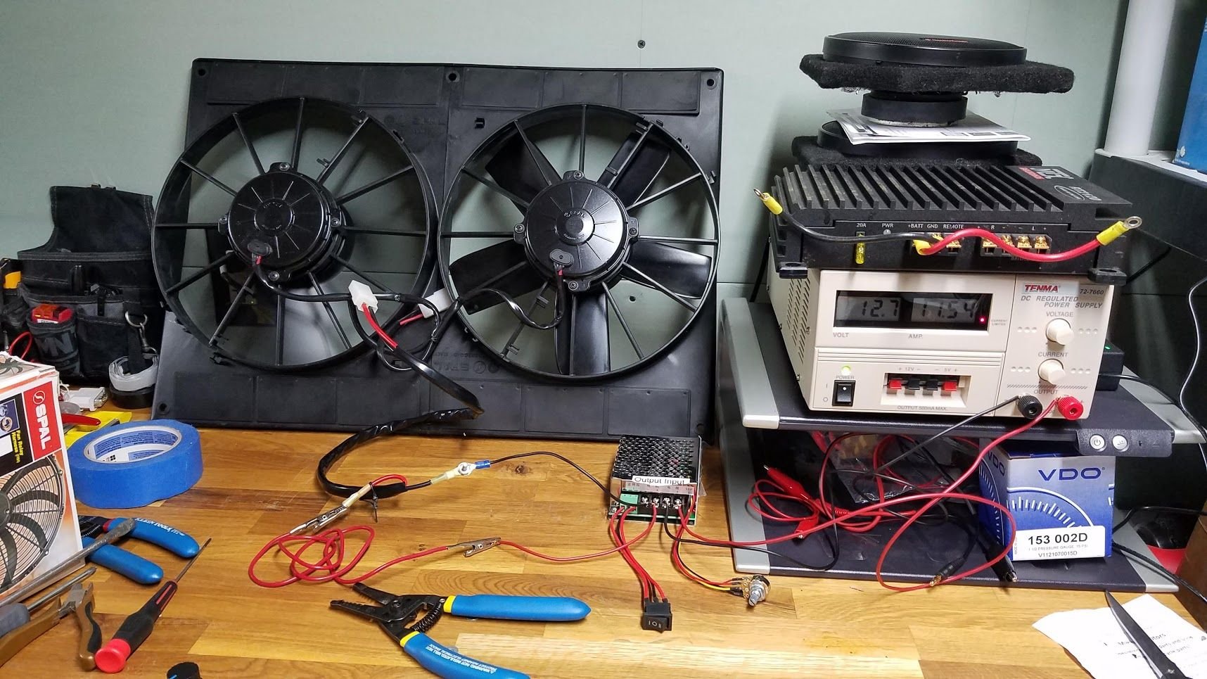

FWIW, I use one of these if I need to test the power draw of something. Much safer than the car's battery. Set a current limit, no blown fuses, or fires.

Never thought about the DMM fuse being gone - I assumed if the fuse was gone it would be a complete Open Circuit and zero amps.
Ya I will be checking the meter fuses tonight.
