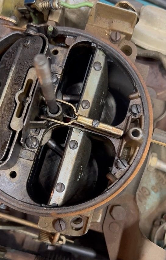

Car won't run and I've nailed it down to the carburetor. When I pump the accelerator there are only a few dribbles not a strong stream as I've seen in the past. If I manually squirt fuel in the carb, fires right up, otherwise nothing. The car was running and driving fine last week, but stumbled and few times then quit. Seems like it was starving for fuel. While waiting for the flatbed I pulled the fuel filter. It was packed with debris. blew it out the best I could and put it back. I then scavenger a hose a checked the fuel pump. It was working but seemed no where near the 1/2 pint every 30 seconds I read about. So this week I installed a new few pump, fuel filter and removed the gas tank for a thorough cleaning. Tank is spotless inside. I blew out the lines and changed all the rubber hoses. Now I easily get a quart plus per minute while cranking.
Is there anything I can do to get this carb functioning w/o missing the rest of the summer buy sending it away for a rebuild and attempting to rebuild myself?
Background - This 1978 L48 is a survivor that I literally pulled out of barn 2 months ago. It only had 20K original miles but sat for 25 years. I spent the past 2 months replacing everything needed. Several on this forum suggested I rebuild the carb (send it to Lars) but I didn't do that because it ran so well and I didn't want to wait.

You need a complete carb rebuild and proper setup. Your accelerator pump is shot, and your secondary airvalve spring is way out of adjustment, allowing your airvalves to hang wide open. From the looks of it, and the fact that your airvalves are that far out of whack, I'm guessing every other aspect of the carb also needs attention and setup. No, you cannot get that carb running right without rebuilding it and installing new internal parts. Carb looks like a very nice, unmolested original carb, so whatever you do, don't let some "mechanic" talk you into trading it in for a "rebuilt" carb. That would be a very bad mistake...
Lars

Clint said it best, a man has to know his limitations.... and maybe Do You Feel Lucky.... Do you have carb experience or good mechanical aptitude? If so I'd give it a look and a try...Here is why...
Your problem seems to be rather sudden which for me limits things being just out of adjustment, you have no fuel to the idle circuit and very little to the accelerator pump. Could be the pump is bad and I'd replace it anyways but that does not explain no Idle or low speed, once you dump fuel in and it runs that circuit should pick up. Since you had crud in the system I assume it got into the carb and a good place to start is from the inlet on in... Idle tubes like to get clogged... I have an Ultrasonic cleaner I use for fire arms and fishing reels, it also works great on carbs and varnish build ups, does not get chunks though...
I say live a little and learn a little, get a good kit and take a look at it, the worst that can happen if you use good judgement is that you will have to throw money at it later... I have not heard one bad thing about Lars or his work so that is certainly another option...
