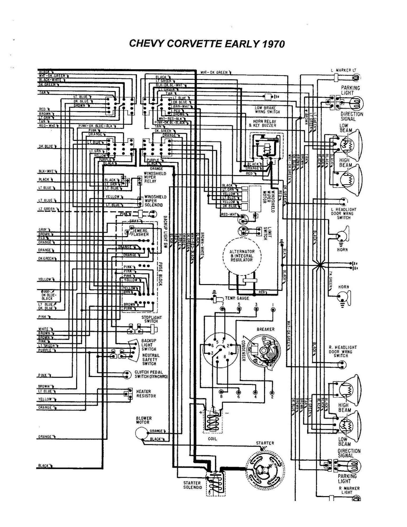

Default Hi again
You changed the 'KEY SWITCH' so that's done but what about the IGNITION switch at the bottom of the steering column.
Could that be out of adjustment?
No fusible links are shown on this internet schematic, you should have 1 or 2 at the starter and you might have one at the HORN RELAY.

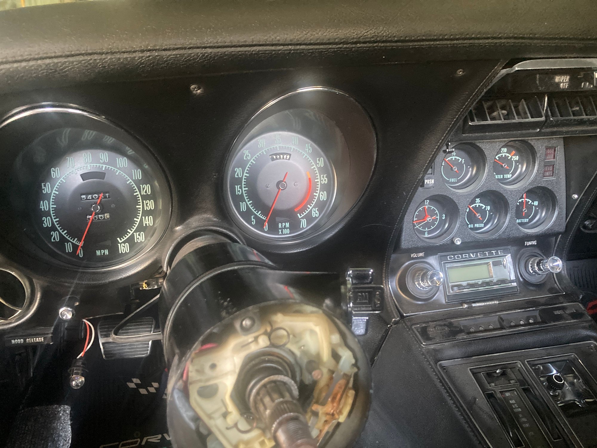

Some light come on in the dash and setting area, no on radio, no on head lights. thanks for still trying . I haven't heard from anybody else in a while.
Old Aug 2, 2023 | 07:40 PM
colo69's Avatar
colo69
Joined: Jun 2013
Posts: 189
Likes: 6
From: van buren arkansas
i did change the key switch , because it had a key stuck in it, i didn't know about putting car in reverse to get key out. I had to quit working on the car i December when covid started i had it bad. Then my wife lost her job because she wouldn't take the vaccine . Then she got a job in Arkansas , so i spent 5 months moving from Colorado. Then i could not remember were i was at, with the build. I had to pack up all parts and put them in a storage container untill i built a building. The house i got didn't have a building, as i have three corvettes . So i don't believe i replaced the ign switch, i replaced most other parts. The 2 links that come off the starter have power and the red wires that go to the horn relay & key buzzer. I didn't want to start tearing the dash apart just yet, its all new , matching numbers convertible , only carb was not matching so decided to go Hei. That just dust on the console. I painted the car original color, i replaced new soft top and had hard top. ALSO had protect-o plate stapled to owner manual in map pockets. It looks like it was their the life of the car( very rusty).
new dash, 54k miles, last plate said 1978
