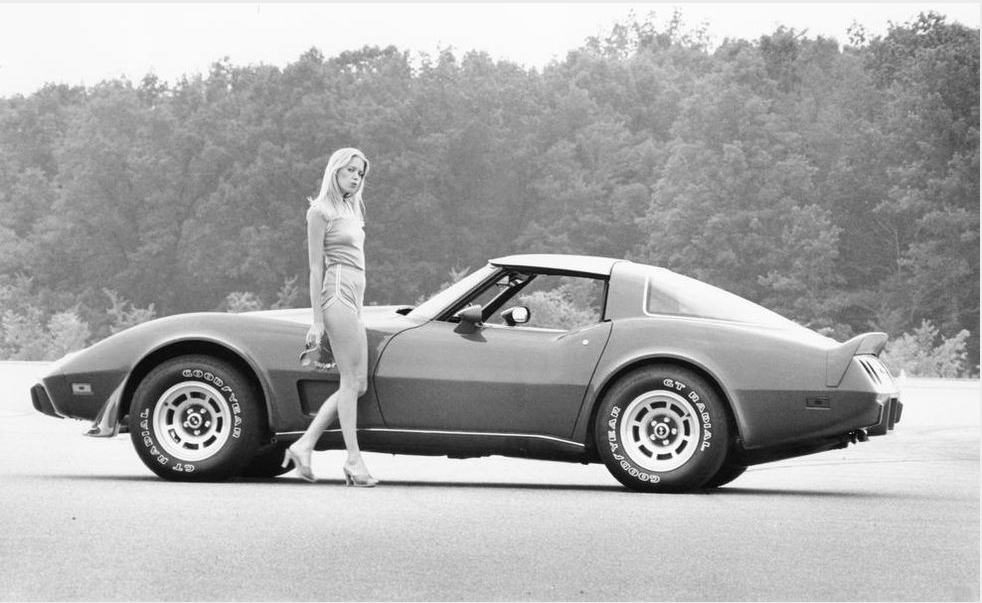

I saw this pic in another thread and after looking at many original pics of the late 70's model Vette's......they all seem to be like 2" too high in the front......
This photo has to be period.....given the young ladies attire and the GT Radial Goodyears......look at the wheelwell to ground on the front compared to the back.
I always wonder why this was.....the early ones were not like this nor were the 80-82 models......
A real head scratcher.....
Anyone have any idea why this was? Was it a parts supply issue? All I know is it kills the look of the car in my opinion....and the front end would have to lift after 100MPH like a wind sail.....

idno....Looks like Big block springs on a small block car.
Or the engine is MIA...lol

I was always under the impression that this was a front bumper height/impact DOT test survivability bandaid.
I can't easily square that with the 80-82 lower bumper height tho.

My '76 looked like that before I cut the coils. A friend surmised that it may have been a bumper height thing, though I have no idea if the springs were original.
One was upside down, I know someone was in there before.

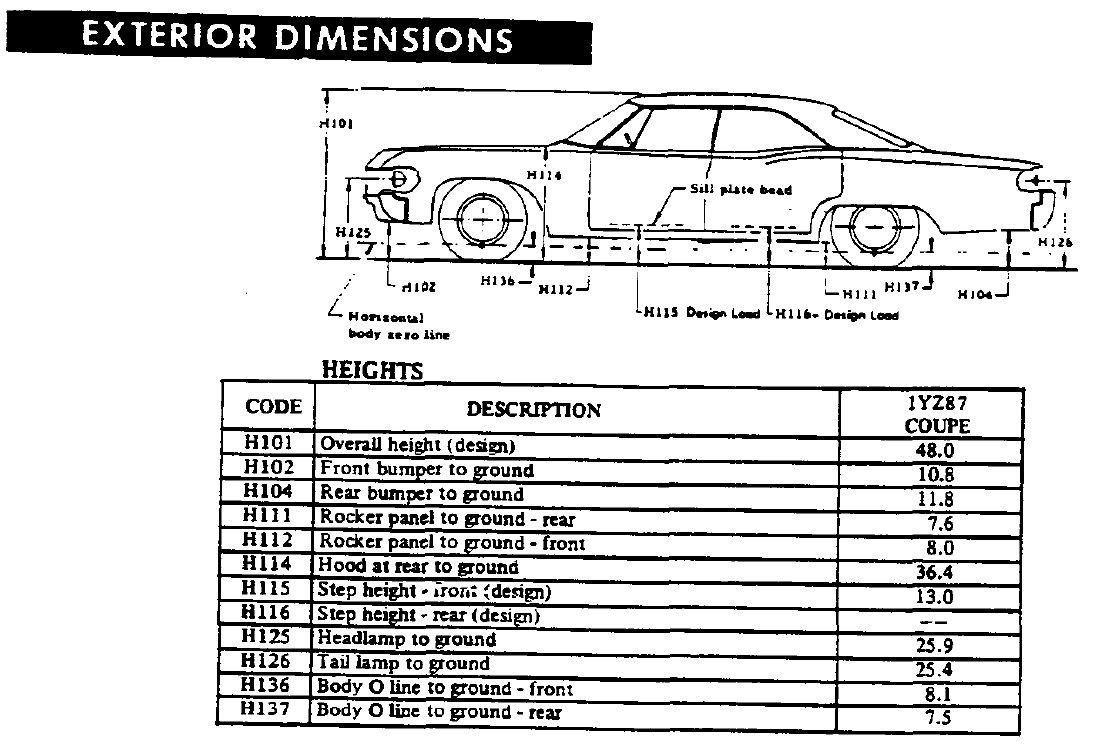

Either an optical illusion, or she's lifting the front of the car.
Other possibilities:
Rear is lowered (easy with bolts)
Front has upgraded springs, that weren't cut
Here are the dimensions of a 79, straight from the source material at https://www.gm.com/heritage/archive/...formation-kits
As you can see from the diagram, the nose looks much higher, because the original file was scanned at an angle. By the measurements, the front may be a half inch higher?

Chassis diagram.

I agree, i noted that picture as well.
I got mine at 28000 miles and front was high, new front springs front is high as before.
Original 9 leaf and used 6 leaf..rear same front high. New 7 leaf rear, front still higher..
i think they were nose high, maybe more air and spoiler for cooling..

Full tank of gas and spare tire ?

It would cause some of it......but I see these late 70's Vette's all the time with no spare and still nose high.....the rear isn't "squat" as much as the front is nose high....
The difference would be even more wheelwell to wheelwell.......but it appears they were made that way according to this.......
The thing that gets me is that this is "America's Sports Car" in the 70's and how GM though this was ok is beyond me......kind of an epic fail IMHO.....but they did also put $50 heads on a $2000 short block with the L-82 too so it just goes with the flow.....
See a lot of Chrome bumper restorations that the whole cars sits 2" too high.....C2 as well......just wonder what the people who are building these see when they are finished.......maybe just too wore out to change it......to me it is also an epic fail to spend 50k restoring a Vette and have the stance be all jacked up......I mean, it isn't an unnoticeable thing......stance is as important as the wheels and paint...maybe more so!
Jebby
I was surprised too, but the measurements I posted shows that this was cooked in at the factory, though very slight.
Another easy thing to fix, and cheaper than new heads. GM puts automatic transmissions in "America's Sports Car", too. All Corvettes need mods, some more than others.
Perhaps GM learned the lesson. Many later GM cars have a rake built in. Why do Cavaliers and other similar cars look like wedges? To reduce oversteer at high speeds.
