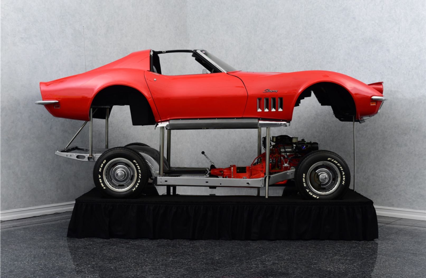

It is a matter of moment arm affect on the body forward of the doors which is dependent on the placement of the jackstands.
In this view, the poles supporting the body are located, left to right, at the #4, #3, #1 body mounts and the front, just forward of the hood opening. Note that the #2 mount is approximately 1 foot to the left of the #1 mount.
Most folks will place jackstands under the area between the #1 and #2 mounts and near the #3 mount points. If you envision a jackstand under the #1 mount, notice that the entire weight of the engine (and everything forward of that point) is being exerted on that jackstand. All of that weight acts to bend the frame at the point (called the joint axis) where the jackstand is located. Since the body is bolted to the frame, it will also have the same bending force applied. Fiberglass is, of course, not steel so the risk of stress-induced cracks will be increased and that increased stress is focused on the surround and front fenders. Door opening/closing is unaffected in this case.
The same argument is applicable when pulling the body off the frame. You need to support the nose with a strap back to the lift point to avoid stressing the surround and front fenders.
If you are going to be having all 4 wheels off the ground for any amount of time, it is best to support the front in the general area shown by the picture.

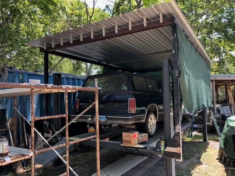

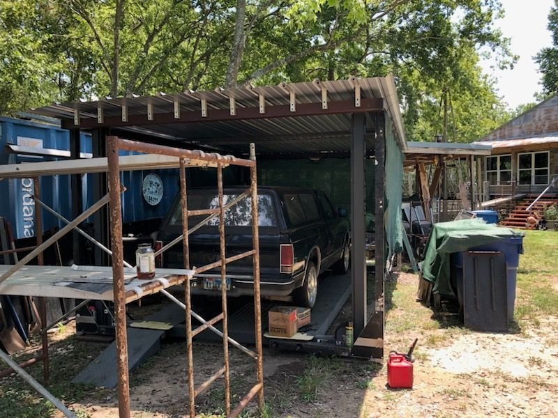

My solution.
Not completely finished but you get the idea.
I built this as I can't work on the car in a container, screw all those other quick jacks, floor jack, kwik lift.
I had the kwik lift for awhile, to old for that BS now.
Lift in lowered position, = low roof
Lift goes up = roof goes up. Plenty of light, vehicles covered for elements

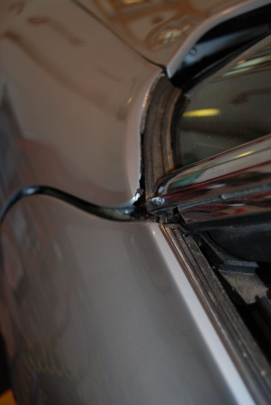

Good analysis. I've been using a two post lift with four support points front and back along the rails. T-tops are fastened and on. The frame definitely bends, the door gaps widen and lately the bonding along the left front fender at the door jamb has separated some. All that stuff in front is having its moment.

My 68 vert is up in the air on a quick jack lift most of the winter. Its a vert so it sags A LOT at the doors. The gaps grow almost a half inch. If I open the doors I dont slam them shut.....and when it hits the ground in the spring everything is fine...been that way for atleast 6 years...its s 68, they dont have the rear kickups so they are a bit flexier than the 69 and newer years
