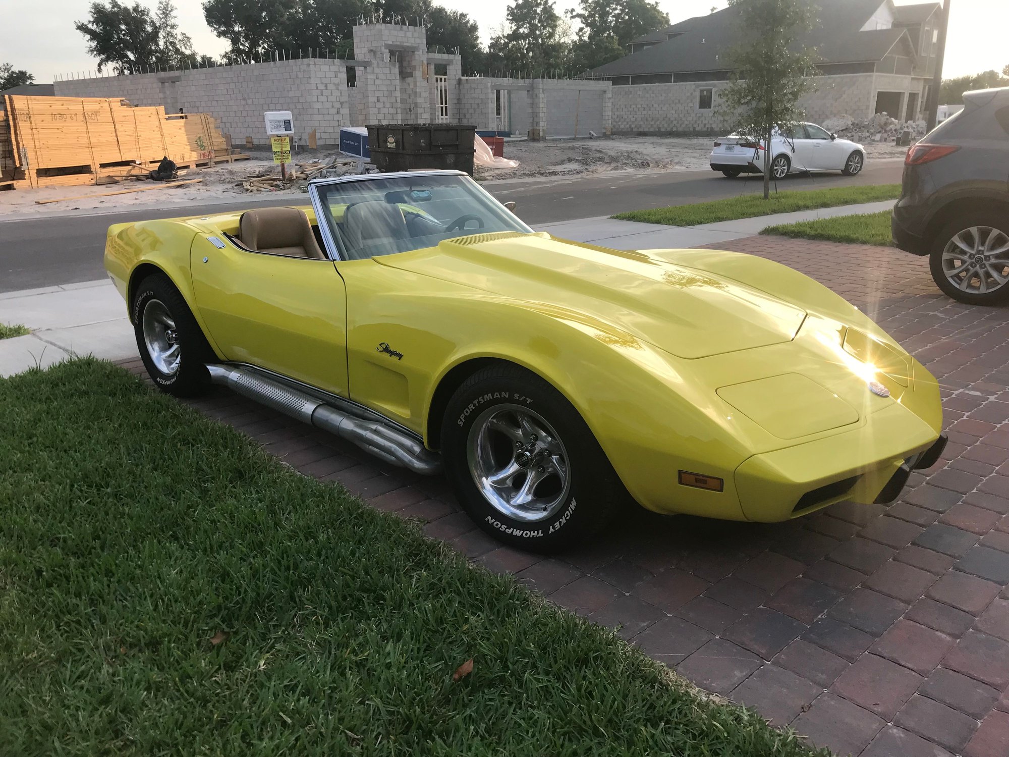

Went with Dougs Sidepipes! With 2 1/2 inserts.
Here is what they sound like.
https://youtube.com/clip/UgkxEBayJyT...E_QA9in65A7a9d

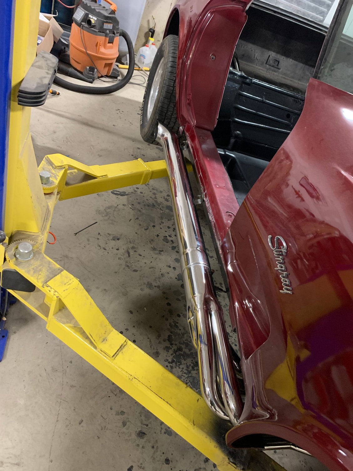

Thanks for following up with CCE! The other big reason to do this as a modular muffler vs. an insert in a pipe is WEIGHT.
For my 3" Doug's inserts (glasspacks), I have an inner perforated pipe, an outer insert shell, the 4" pipe itself, and sometimes a shield. That's up to 4 layers of steel, but the exhaust only sees two of them.
A solution that replaces the pipe with a functional muffler could eliminate one, or even two, layers, half the weight. If it ends up looking goofy, who cares? Form follows function. Put a heat shield over everything, and still come out way ahead on weight.
