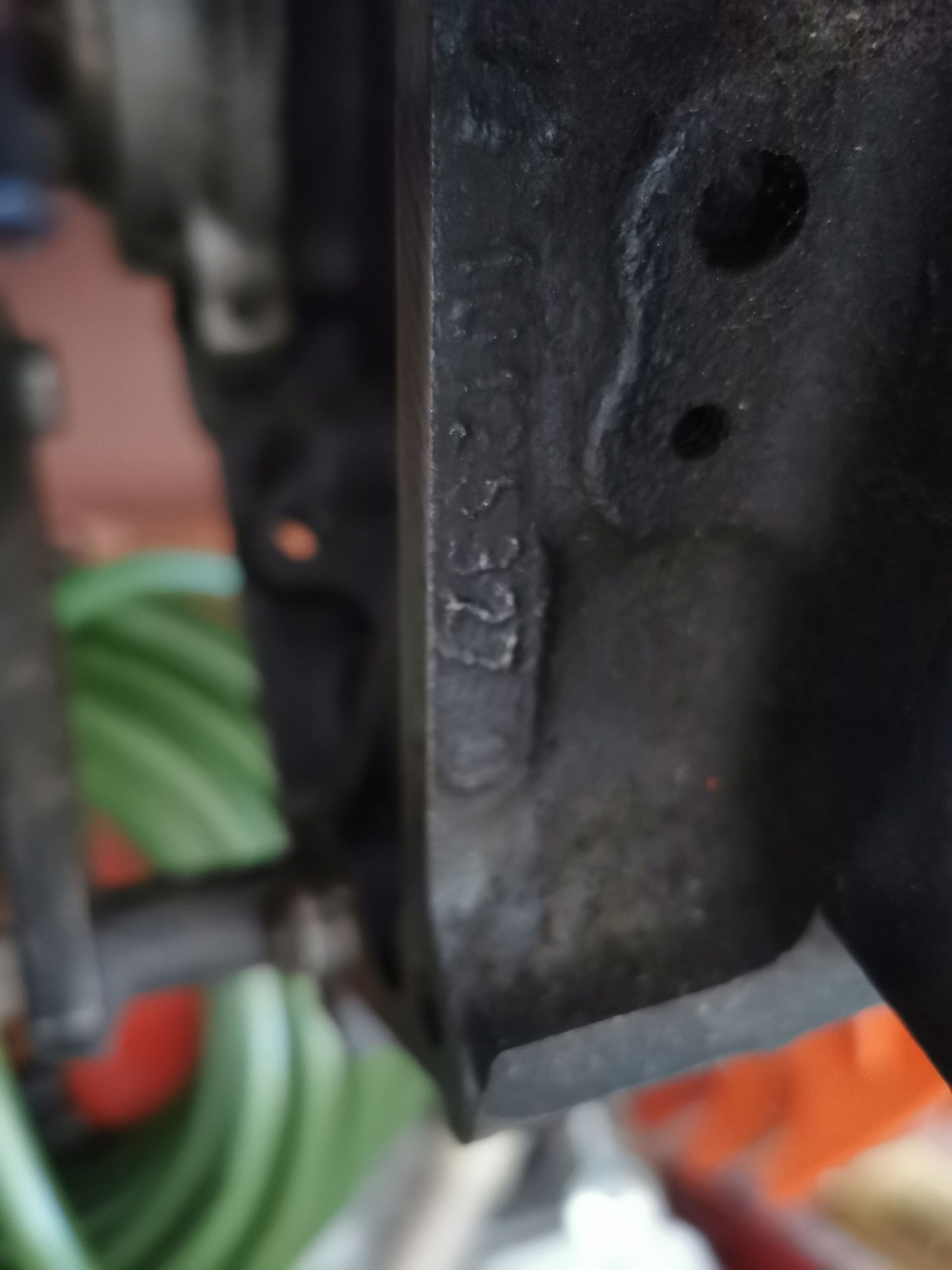

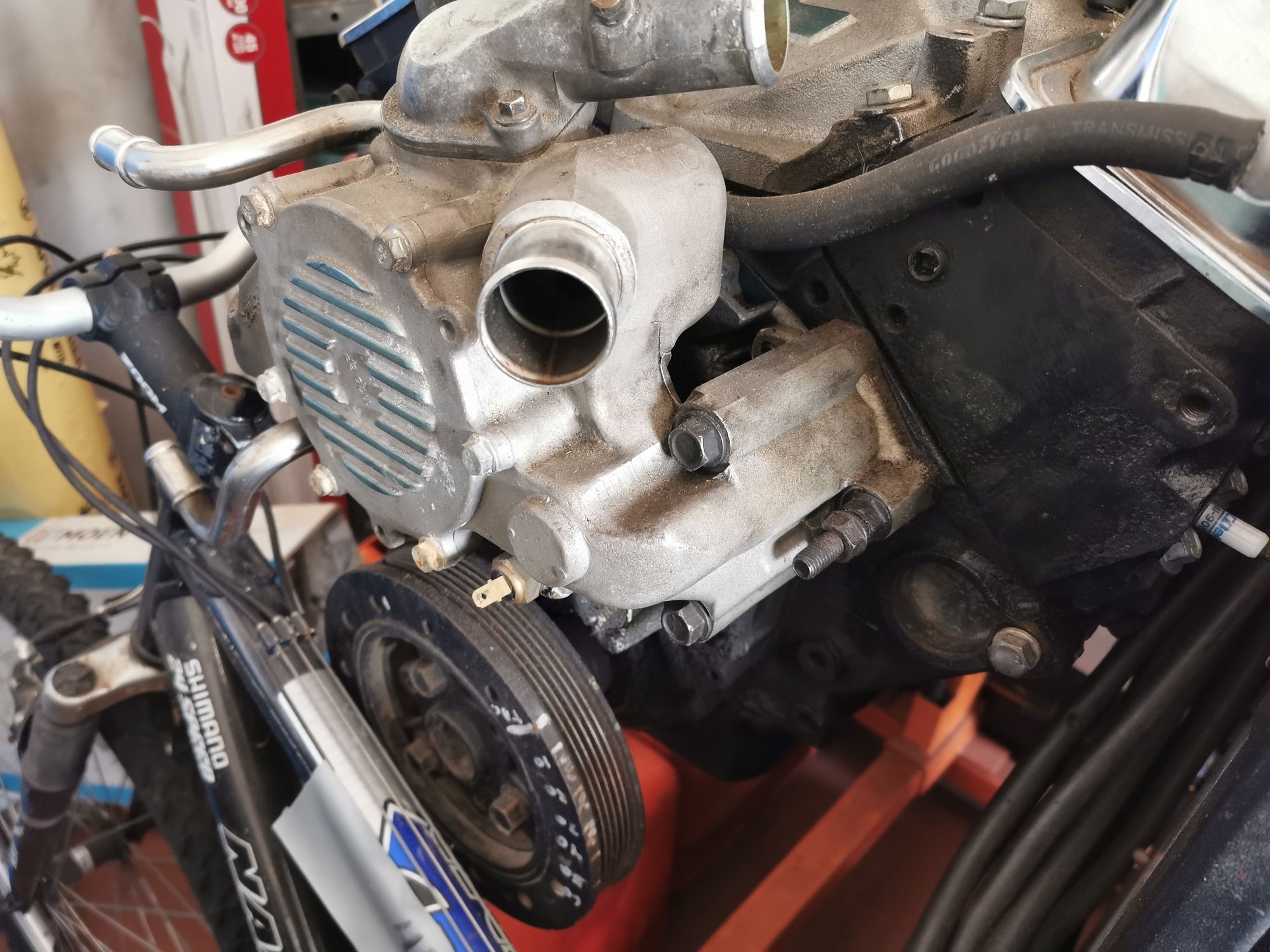

Ok finally got info on this motor. It's a 94 Lt1 out if an impala. Complete rebuild, very low mileage on new build. It has the reverse glue water pump, which I heard isn't too good. But not sure on that. Has no carb on it he used on the olds motor. Comes with exhaust manifolds that are powder coated a chrome color. But I have long tube headers new on my motor so would use them. The intake is a gm 4 barrel carb manifold , apparently its the only one available to convert to carb. I have a new carb on mine. Took a couple pics I'll post. Motor has the threaded part for the clutch system which I need so that was good. Let me know what you think if this deal. Figure I can get it for 2500-3000 Canadian. He's a bit desperate, needs the room in his shop.

I understand it's a different market, but you'd have a hard time selling that for $400- in the US. They only made those for a few years. and heads are not compatible with SBC heads, so there is little aftermarket support. You can see that with the ONE available carb intake!
I'm sure some will disagree, and I posted a link to a great example, but stick to SBC or LS (Gen I, III, or IV) if you want support.

Does it have a Distributor? If so thats why it has a unique Intake. The Opti Spark Distributor got a bad rap when they came out for getting wet inside but that was pretty much cured with a simple Vacuum line. If it was mine I would much prefer to install the LT1 with the stock intake and FI instead of a Carb. The Headers he has probably don't fit a C3. Anything SBC is a hard sell these days. My local Craigslist has a LT1 take out for $600. I doubt its going anywhere soon.

With that intake, the only area where it's different than a regular small block is the front. The cam gear has a gear on the back to drive the water pump. The timing cover is unique. The water pump obviously. Then, the whole accessory drive. You'd need a Corvette one I believe. The F-body won't work for sure and I don't think the B-body would work either. They don't clear the upper control arms.
They are decent engines. Should be capable of an easy 300hp, or more if he put a cam in it. It's worth what you want to pay vs going another route. I'm running one I swapped into a 65 impala years ago. It works well, it's running the efi with the computer controller transmission.
