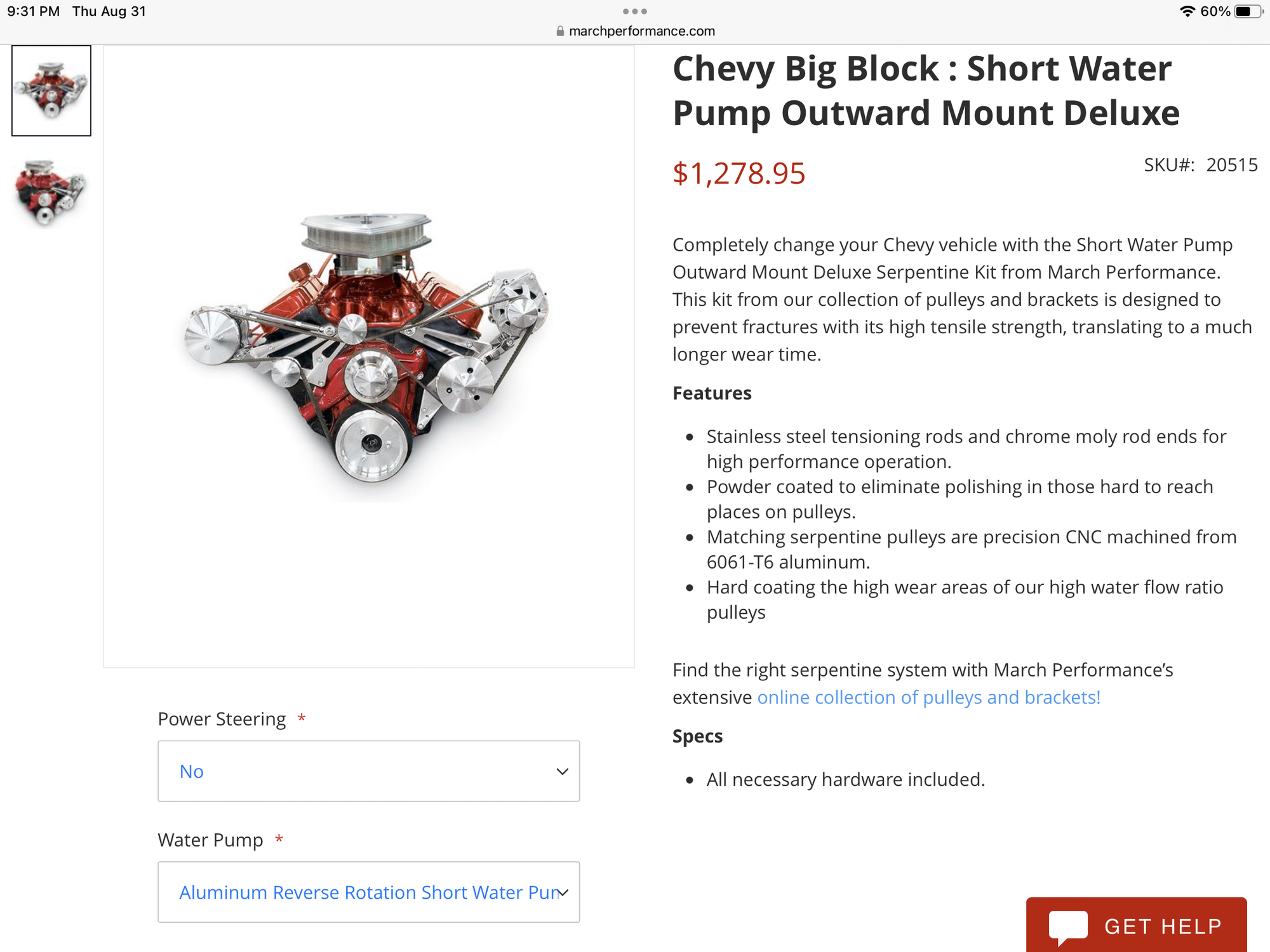

I think converting to a serpentine system would be great.
I found a great serpentine set up from March that I may ultimately go to.
Its listed in their pulleys and brackets section.
It’s simple and you can use all your accessories.
The March kit comes with the billet aluminum brackets and the Edelbrock high volume reverse rotation short water pump.
By just changing the alternator and ac pulleys which are available from March and Vintage air you can use your current alternator and ac compressor.
The kit is nice, plain and looks extremely well built for $1200.00.
If I have any difficulty getting my belts to line up, I’m just going to pull the plug and convert over.

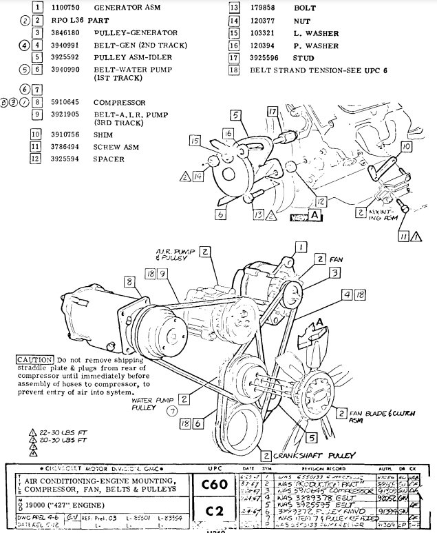

You can do it with 2 grooves if you don't have PS.
Here is a pic from my 68 AIM. Seems to show the 427 without PS and with A/C.
Per the text the A/C uses the 3rd track...
That being said on my small block I actually run the a/c belt on the 3rd track, but I have power steering running on the 2nd track. A/C + PS was not offered on 350 HP 327 so I had to make do.
It would be easy enough to run your belt on the 2nd track by modifying the compressor support bracket to realign the compressor with the desired pulley --- that's what I had to modify on mine to make it align with the forwardmost pulley (3rd).... quite easy really.

I think the 2-belts on the water pump might be on cars with no a/c and no p/s. Without the 2nd belt, you’d only have 1/4 wrap on the WP-alt belt, so not much belt surface driving. With adding A/C belt along with your alternator belt, you have more belt surface driving the WP and you should be fine. Small blocks only have the partial a/c belt and partial alt belt driving the WP and they are fine.
Old Aug 31, 2023 | 09:31 PM
carriljc's Avatar
carriljc
Joined: Jan 2001
Posts: 6,741
Likes: 1,383
Classicnotold
As you can see in the image for the a/c compressor they just went around the water pump. On my adaptation I have the belt running around both the water pump and the crank to the a/c compressor.
Get the pulley number for your water pump. If we're lucky we can find a forward-most 3rd add-on pulley. I have lots of pulley info. Get me that pulley number on your engine and I'll look around.
But really, I'd just go around both the water pump and the crank and modify the a/c bracket to align with that 2nd groove.

As to the March system, not hijacking at all! I appreciate the help. Where did you see that for $1,200.00? That's much better than I have found. Summit is almost double that price. Every aftermarket supplier that I have found are currently on back order for the 3 groove w/p pulley.
Here you go for the March serpentine system.

I bought the March Serpentine Conversion on my 1968 BB and it fit nicely and works well. I have had mine since about Y2K and it works nicely.even without a idler pulley providing constant tension. The biggest complaint I have is that the "Powder Coating" they tried to apply was not done correctly. The brackets have sheets of several square inches of the silver coating peeling off. It appears the surface was not prepped properly before they applied the powder coating. The pulleys and covers all look very nice, it is just the brackets where I have issues.
The one I had to use with a C3 with power steering is not the wide setup like the one shown in the picture.
