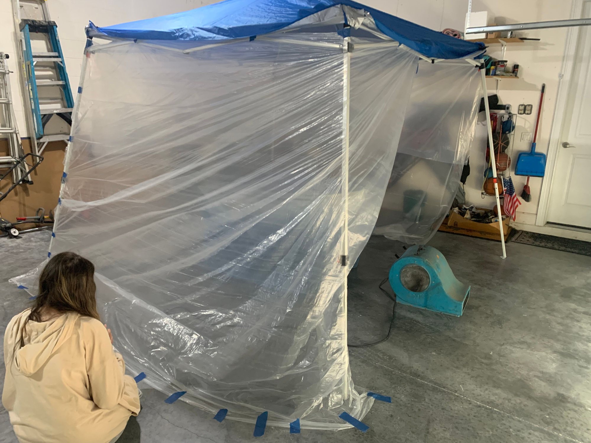

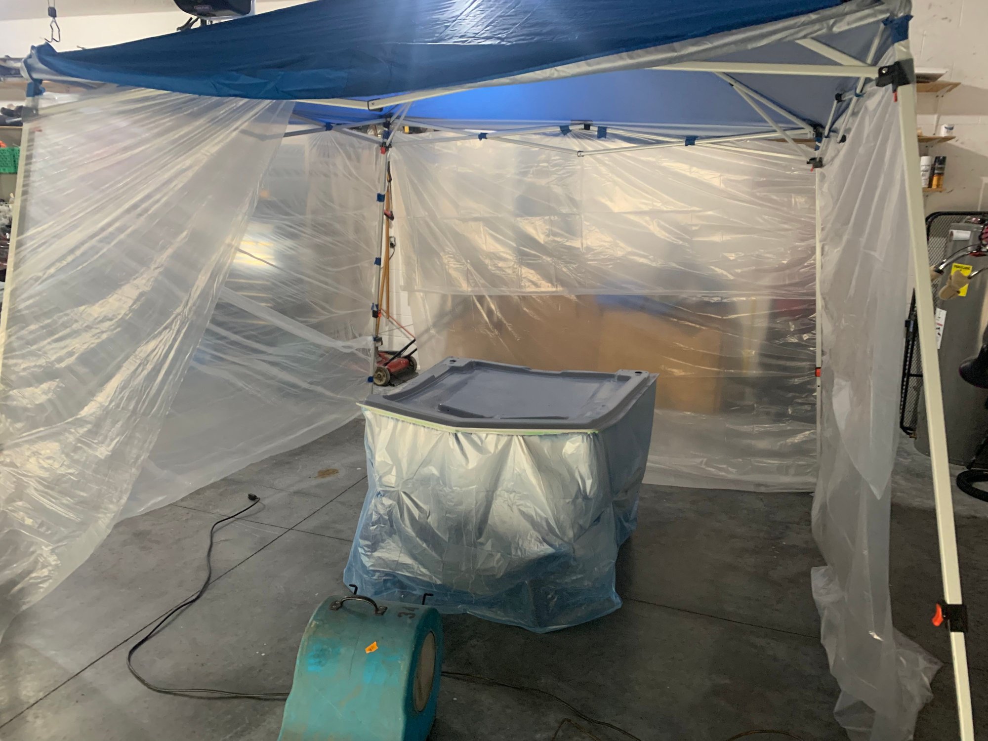

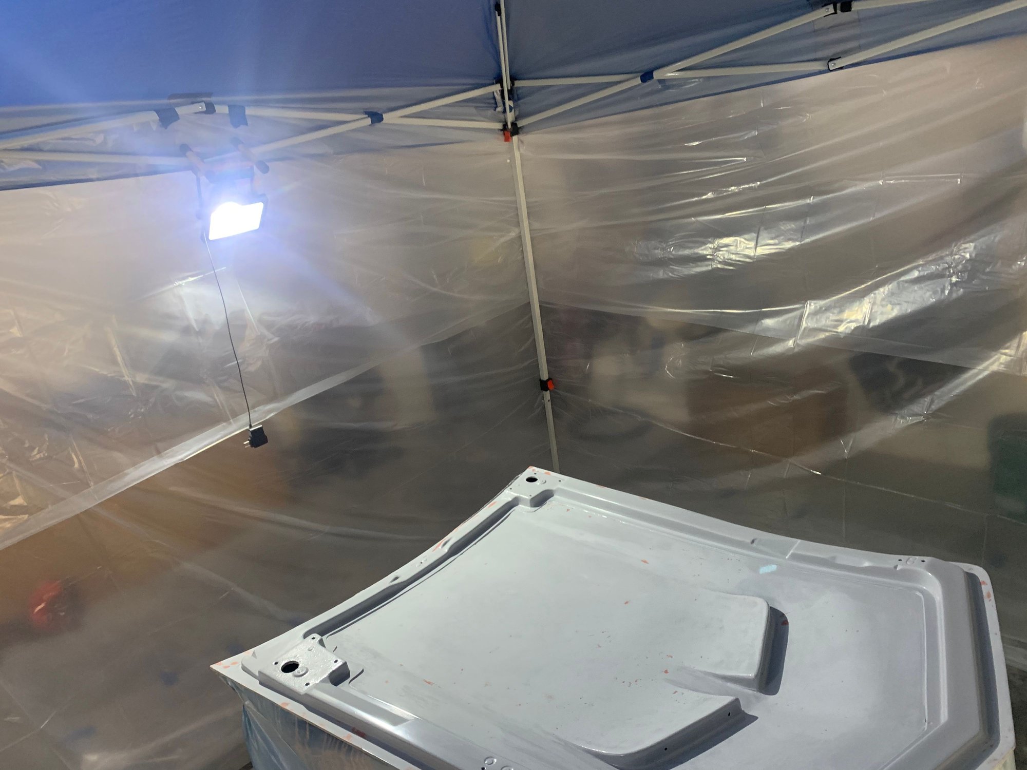

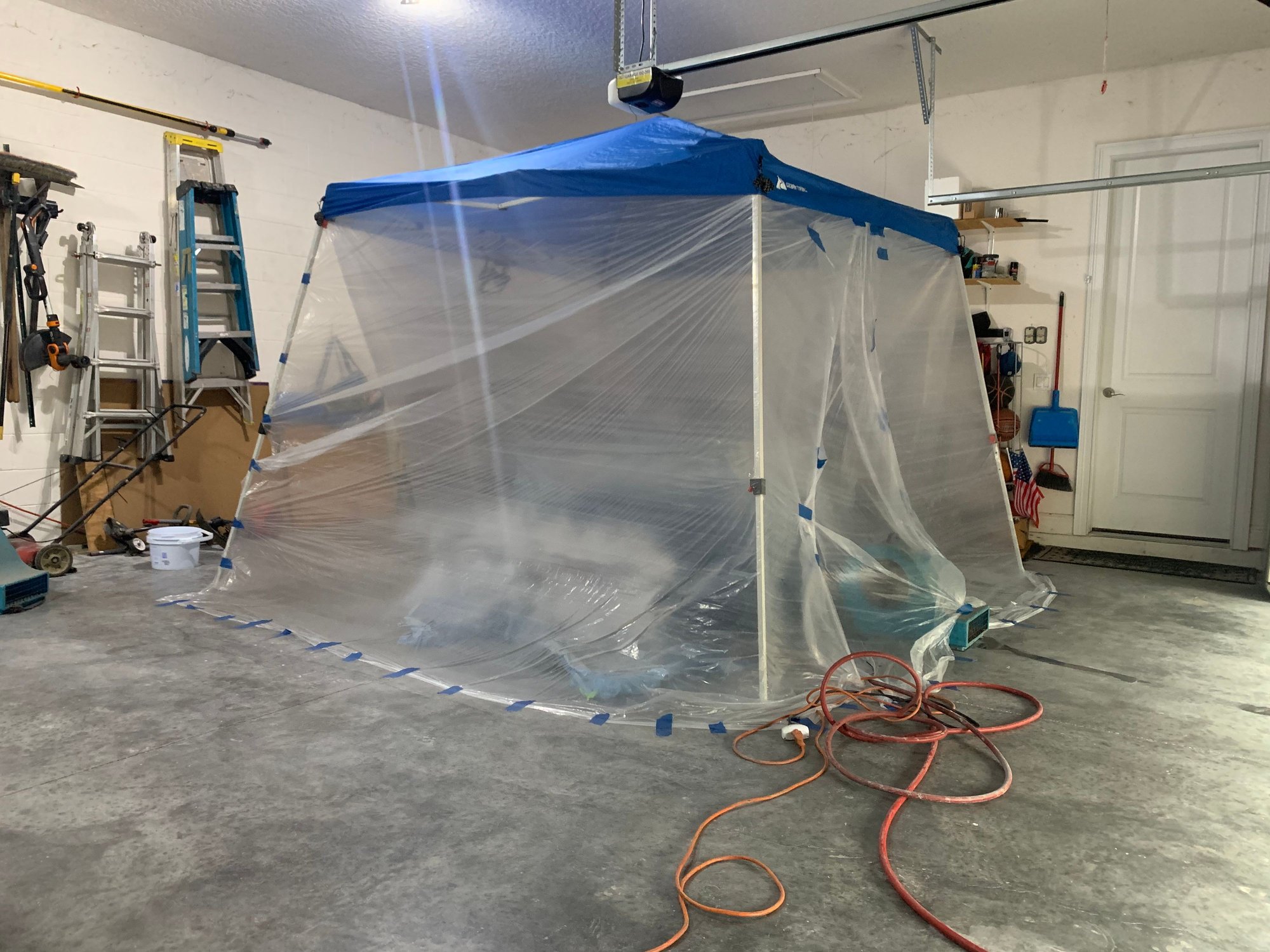

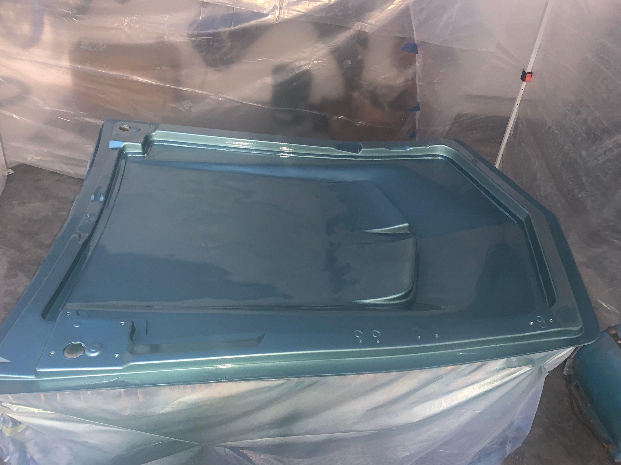

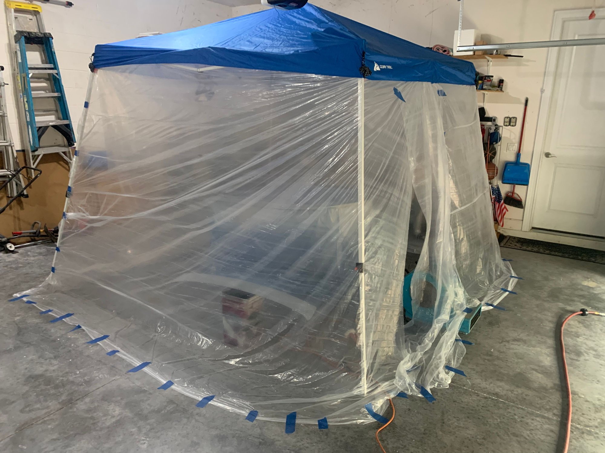

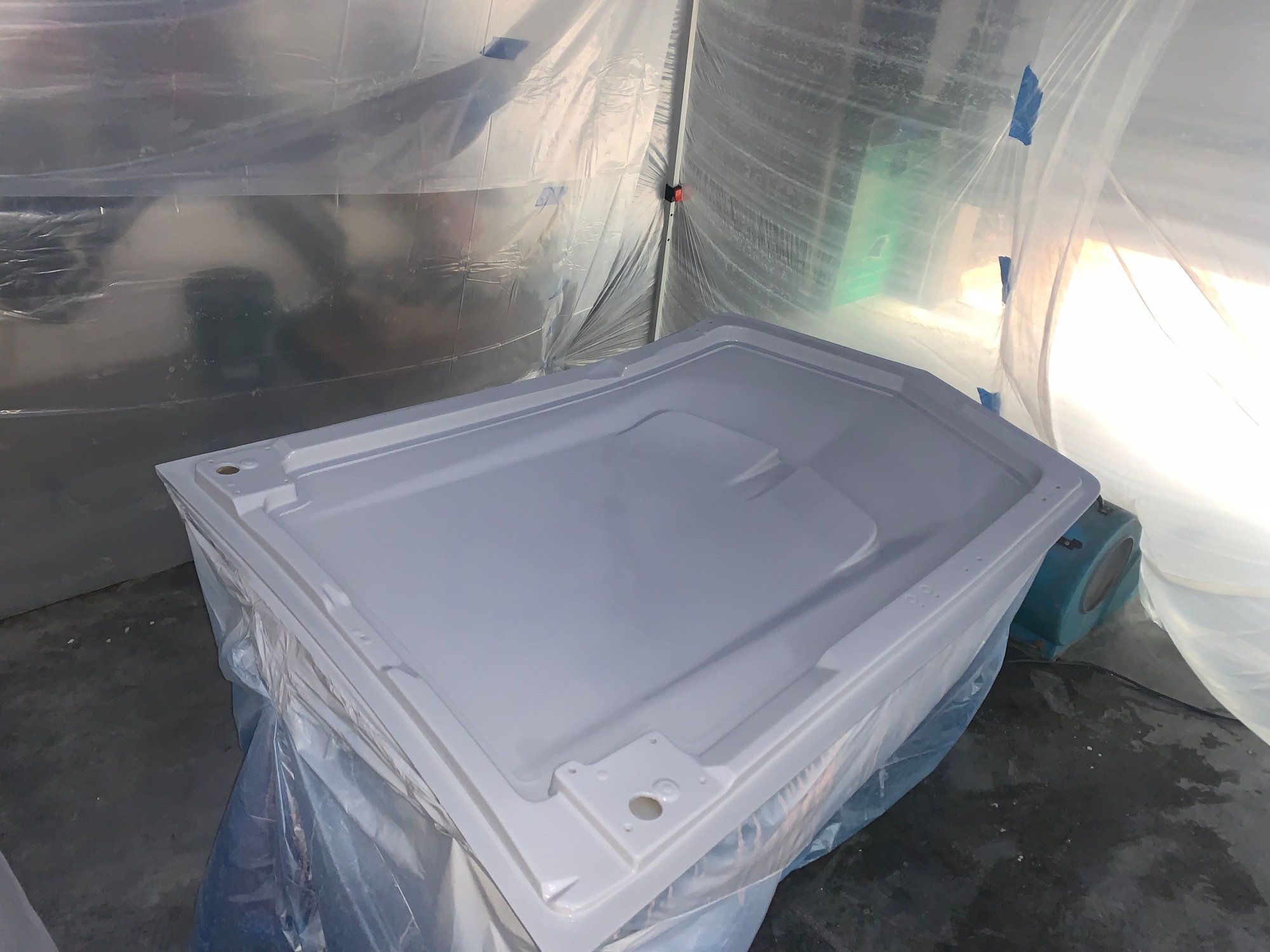

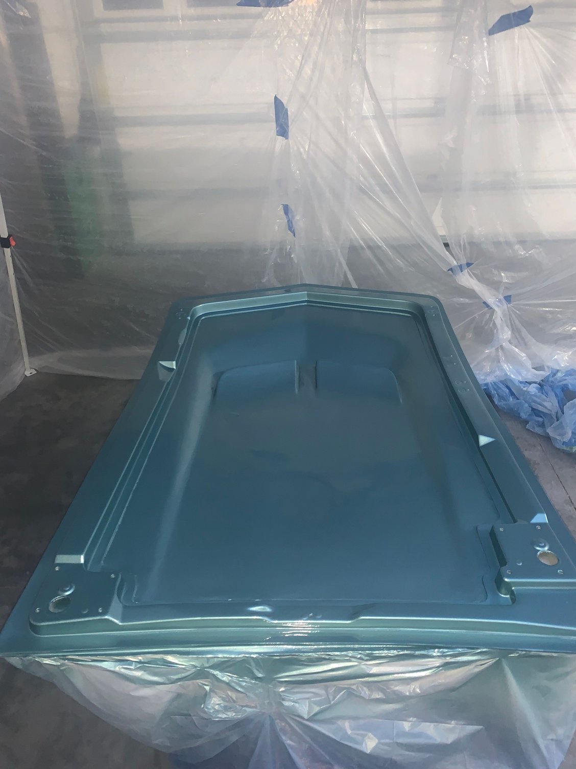

This is great information. Thank you so much. I did the underside of the hood to gain experience. Used the whole quart. Then body worked again. Then sprayed Probase primer-sealer. Then 2 basecoats, then 2 clear coats. Not bad for never having done body work before.
Just before spraying primer.
My home made set up for a paint booth. It did the trick.
After primer.
Wiper cowl after primer.
First base coat
Second coat
Setting up the “booth”

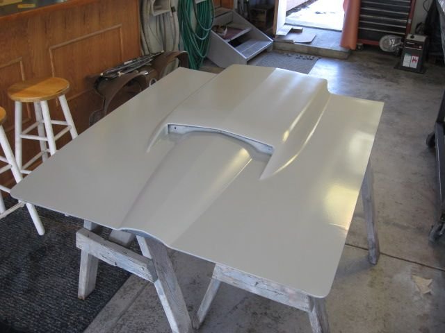

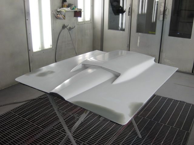

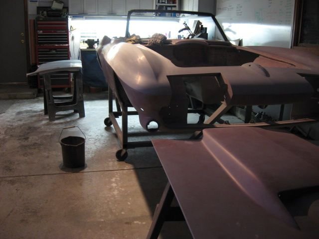

Yes. That's what you want to use. But first use the "gel coat" as a sanding base - the gel coat is very much like a polyester, so use it as a blocking fill primer. You have a long file-board that you're using, right..? Shoot a guide coat on the hood and block it down with the file board in a cross-hatch pattern: you'll be surprised how "wavy" it is. Put a couple of coats of urethane fill-primer on it after blocking (not reduced as a sealer), guide-coat it, and block it down again starting with 150 and going to 220. Repeat as necessary to get a clean sand on the guide coat with 220, and finish sand 600 wet with guide coat. If you have not cut through the urethane in any area, you can basecoat/clearcoat over the top. If you have any concern that you may have a cut-through to gel-coat or 'glass substrate, shoot an epoxy seal coat or a urethane primer coat reduced as a sealer prior to the first basecoat. You're on the right track to doing it right - nice job.
'67 hood shot in polyester (similar to your gelcoat) prior to initial block-down:
Hood can here be seen after block-down of polyester with urethane fill-primer and guide-coat applied - prior to final blocking of the urethane fill-primer:
Urethane fill primer with guidecoat blocked out and finished 600 wet, with the "cut-through" areas identified and sealed with epoxy:
Shot and finished:

There is not a new, out-of-the-mold fiberglass panel that is straight and wave-free. Hit it a few times in a cross-hatch pattern with your long file board and you'll be shocked to see the high spots and waves. If you shoot a nice glossy paint job on it without blocking it, it will look like a 10-year-old did your bodywork...
