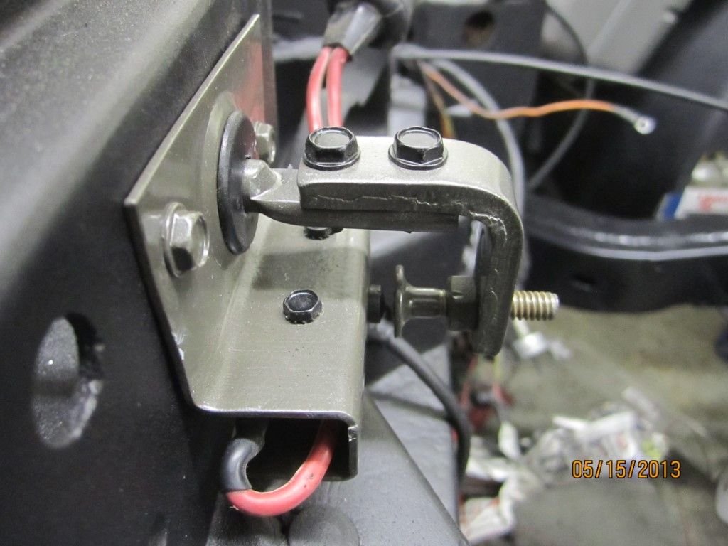

the answer is yes you have to have the wiper door connected so the plunger depresses the safety interlock. You can jumper it if the door is not on. Its there so the wipers will not work with the door closed

Wiper switch needs to be grounded
Press or jumper/bypass this switch, it's what prevents the wiper motor from getting power until the door is fully opened

On the 68- red-headed step-child- the firewall limit switch controls the ground -not power like 69-72
You have a constant 12+ source from where the headlight switch connects to power -it does not run through the limit switch
Here's a great diagram - thanks to Willcox-
If it is a 68 "only" motor the limit switch is ground switched.
