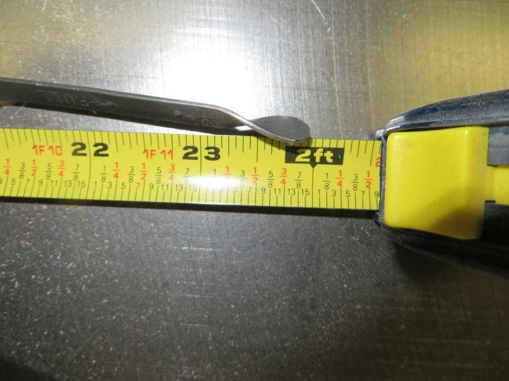

From my 72 TH400
From the underside of the stopper
Or measuring from the cap lip (which wobbles around some)
Or sticking out of the tube
M
