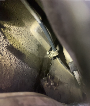

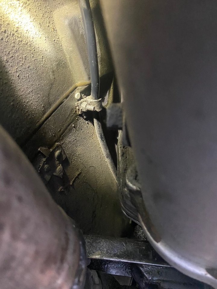

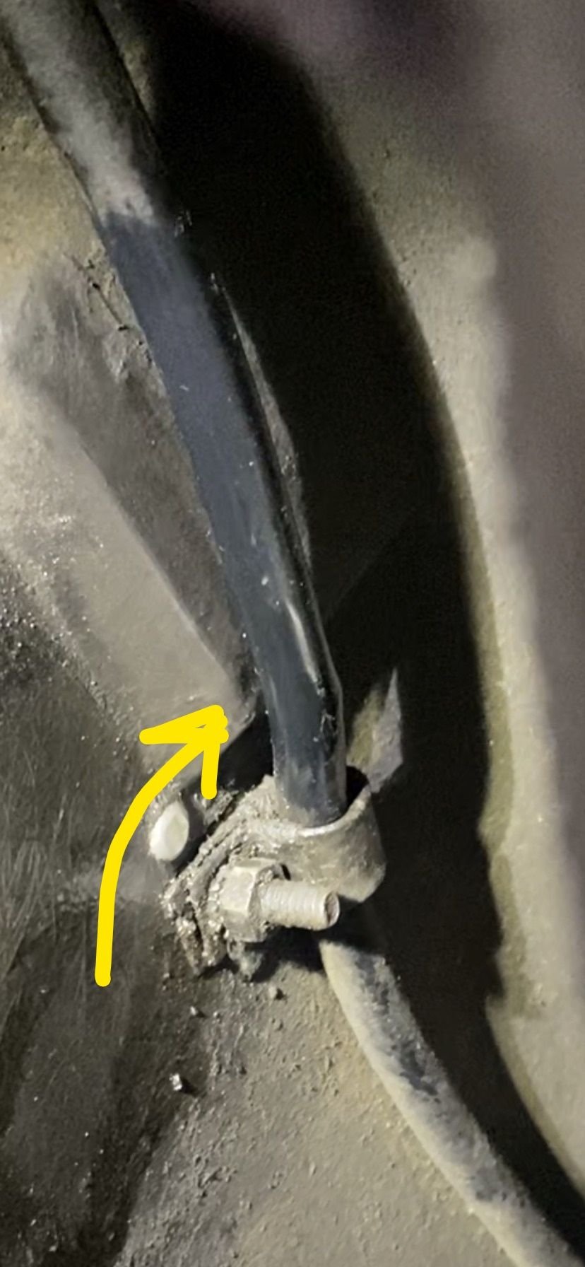

I had a leak and was unsure where it was coming from. I cleaned things up a bit and found a line that looked like it was leaking but when I traced it forwards and backwards I realized it was a power line from battery box to starter. I cleaned up the area and loosened the wire from the side and started car. Now it is leaking pretty quick. Not a stream but not a small drip either. I am really unsure what is behind this box and wanted to see if you all could help. I looked through the forum first and checked AIM so I did not ask a stupid question. I was unable to find anything matching or showing the area. I did not see any bolts to loosen to remove and really did not want to remove and be really surprised by anything. Here are some pictures that I hope helps out. This box is on the passenger side right next to the transmission. In the area that I think is usually filled with exhaust pipe. The car is a 1970 with manual transmission. I marked an arrow on one picture to the hole that is leaking oil.
Thank you all!!
This is the front side of this box area under the car on the passenger side.
This is the power cable from battery to starter and the leak located under that wire.
I loosened the cable and tried to clean up so that it was visible as possible.
By "box area" you're talking about the part marked by the yellow arrow above, yes? If so, that is just part of the transmission tunnel/floor pan of the underbody. There's no fluid in that at all unless you have a huge oil leak inside at the gauge and it's running down behind cluster, shift console and under the carpet somehow. Is there a strong odor of oil inside the passenger compartment?

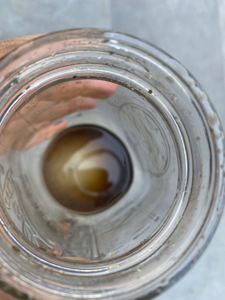

OK. Cranked car up again. Got caught with baking dish and was handed a mason jar instead!
Drip after running for a few minutes turns into a pour. Tried to send video but too large of a file so I am posting a pic. Next, someone said earlier about wet carpet, I checked again....it felt dry. So, this time I pulled it back.......Dang it!! A puddle!!
this is the drip from the side.
This is showing steady flow of fluid
Collected fluid in mason jar
Pulled back carpet - wet underneath
