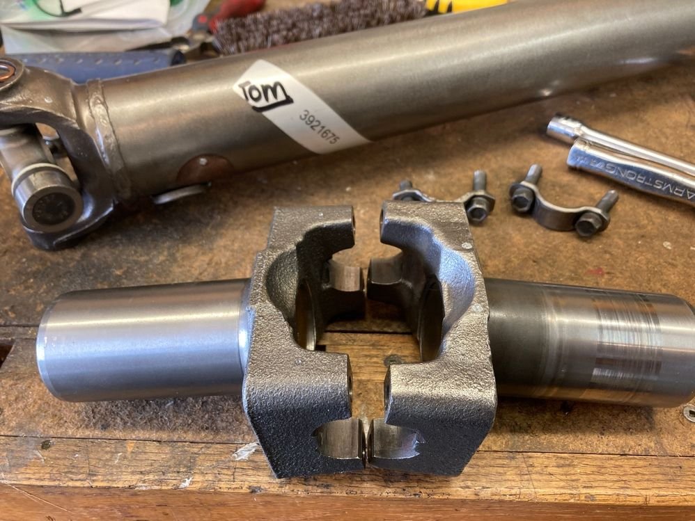

I'm just about to replace the rear bushing and seal in my '71 SBC Muncy M20 transmission as part of a refresh. The car hasn't been driven for over 33 years, but before that I hadn't noticed any problems with the driveline. I have noticed a slight score line on the yoke as shown in the attached photos:
Can this yoke be reinstalled with the new bushing and seal or will it cause problems for my hopefully weekend cruiser restoration?

I would use it..but having it out i would have the driveshaft balanced to be sure that part is not out of balance. I had to replace mine to balance here and replacement usa made.

I would clean it up a little with a very fine stone or fine grit crocus cloth.
Worse case senerio, it might leak a little and you might want to deal with it then. Easyand cheap job to replace the seal.

My old one looked way worse than that and still didn't leak. I think I would just clean that one up.

Thanks guys, that makes me feel better. I'll polish it up a bit and check into finding a local balancing shop.

Do you have any indication that the shaft is out of balance?

Can't say that I do (or did), but it's been over 30 years since the car was last driven. Maybe a better plan is to just reassemble and wait to see if there's any vibrations once the car is back togther and running again.
